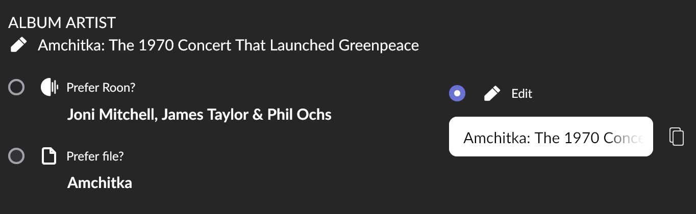

In Roon, in Album view I select all Albums and then export to Excel
I open in Excel and the Album Artist information is incorrect for any Album where I edited this information. Here is an example
From Roon
From Excel
Notice I edited the Album Artist in Roon but when I export, the Roon data is coming out NOT my edit
Is there no solution to this?
Bug in Roon?
Tried this using Roon on a Mac and a Windows machine
Same thing, this appears to be a Roon bug
Waiting to hear from support

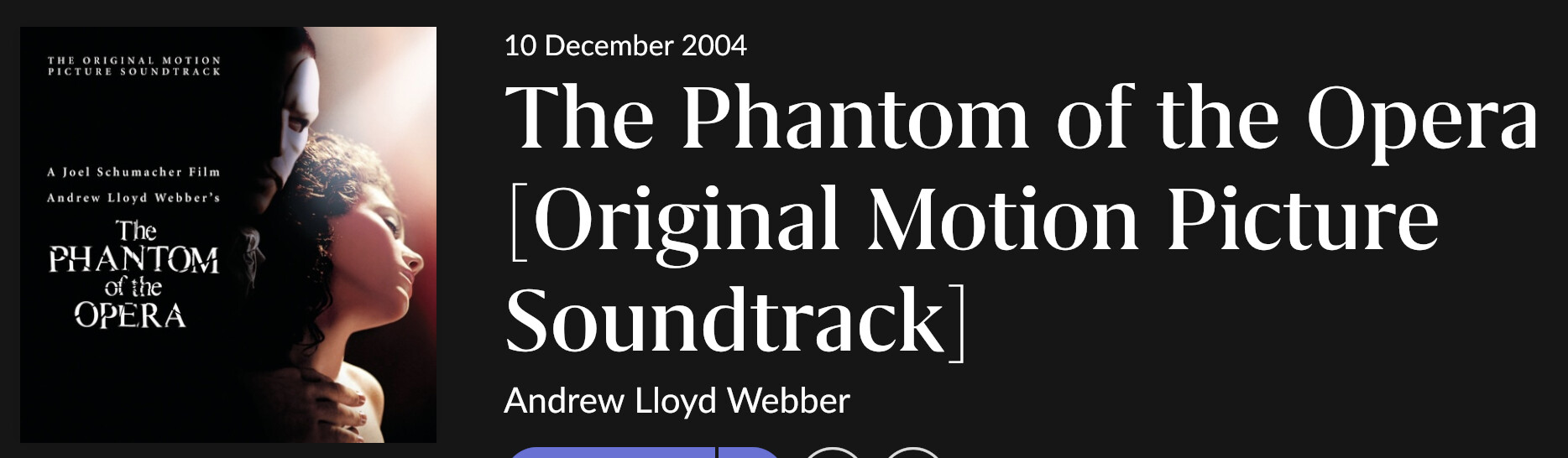

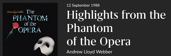

I found out that at times Album Artist also exports incorrect. Here is an album within Roon, notice the Artist is Andrew Lloyd Weber
When exported to Excel this is what I see. Instead of Andrew Lloyd Weber it exports with an Album Artist of Original London Cast

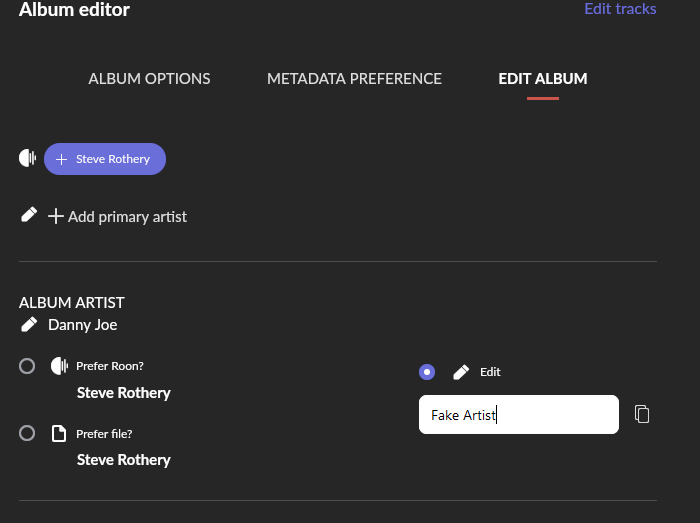

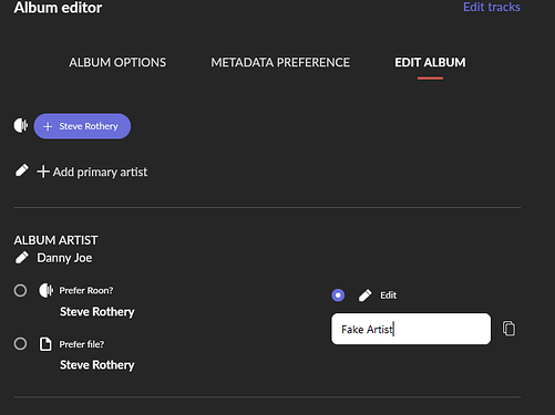

I went into an local album I own and in Roon I Edited the Album Artist, changing the Name to “Fake Artist” from Steve Rothery.
I then immediately went and exported the album to excel.
As you can see the Album Artist reflects the name change.

The top image you are showing “The Phantom of the Opera [Original Motion Picture Soundtrack]” by Andrew Lloyd Webber. The excel clip is for the album “Highlights from the Phantom of the Opera”

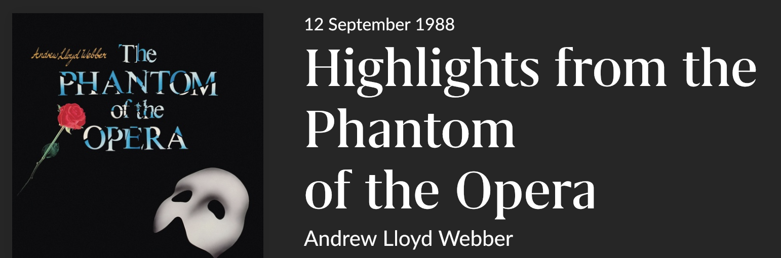

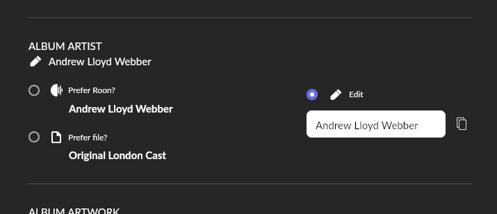

But, anyway, sticking with the album “Highlights from the Phantom of the Opera”, there does seem to be a disconnect with the display and the excel export. It first exported the Album Artist as Original London Cast. I then edited it to Andew LLoyd Webber and it then exported it correctly.
Export after Editing Album Artist.
I’m wondering if it has to do with the fact that Andrew Lloyd Webber in the data is really the composer not the album artist per se, and, unless you specifically edit it to the same (like I did) , it might be displaying one but using the other for the export.
Well, editing the Album Artist and then exporting it is working perfectly for me (as I have just shown twice). Perhaps, try it again. Take a different album as a test and change the Album Artist to something like TEST, and then export just that album immediately to check.

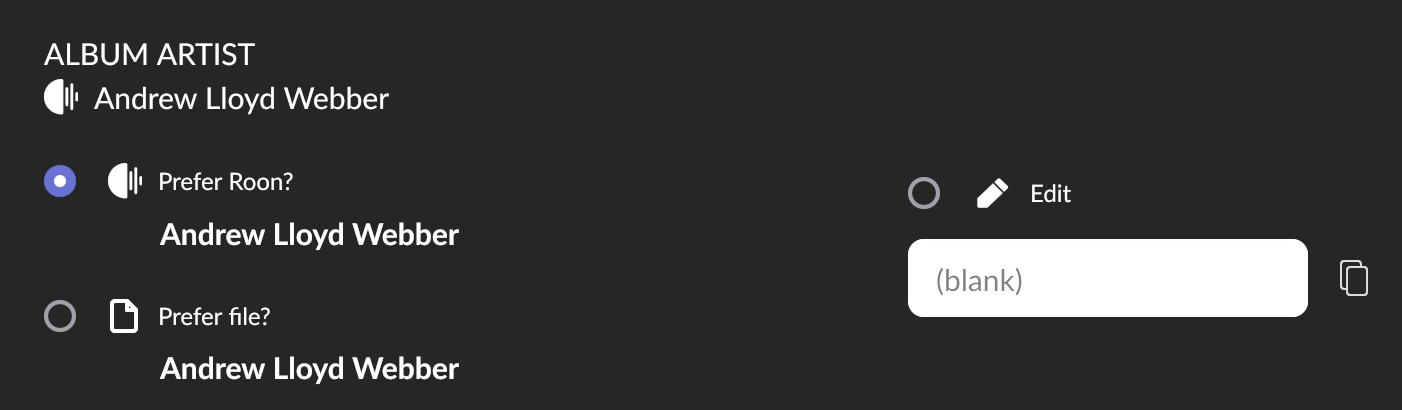

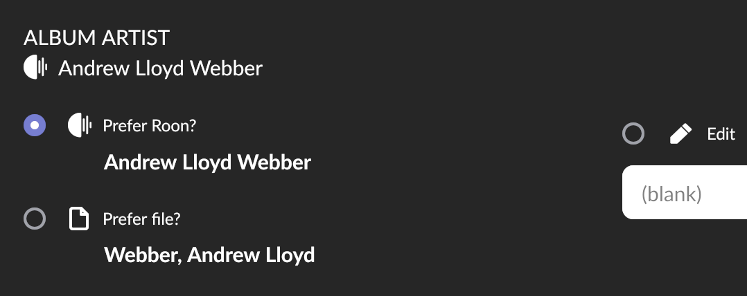

Ok, I once again did some exporting and comparing. Here is the album from Roon
When I edit the Album this is what I see. Notice the “Prefer Roon?” is checked and the Album Artist is Andrew Lloyd webster
I export this one album from Roon and open in Excel and get this
In Roon the Album Artist is shown as Andrew Lloyd Weber
If I export the album the Album Artist is Original London Cast
