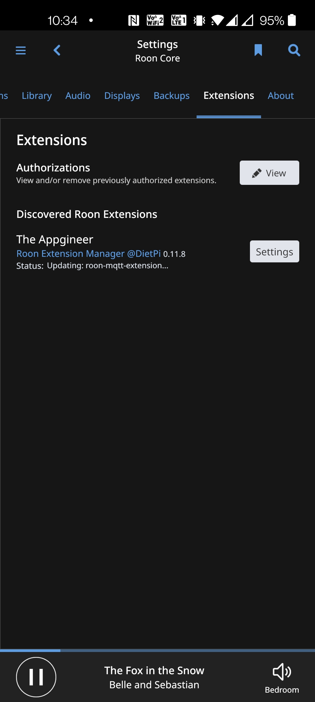

I have been seeing issues with Extension Manager crashing (or never completing checking for updates) each night and having to restart the DietPi device to get Extension manager to work again.
Is this a known issue and is there a way to turn off auto updating to see if this is the cause of the issues.
I see the following screen when I look at extensions onRroon.
and if I click on the Settings button I see this
I have looked at the logs and there is nothing there and if I run a manual uipdate it completes in about a minute and comes back up, where I can restart any extensions
Any help offered is greatly appreciated

Were these really the extension logs? If you open the Action dropdown, as in your second screenshot, you can perform a “Restart (with logging)”. After the auto update failed you can download the logs via the Roon Extension Manager link, as in your first screenshot. If you can upload the logs somewhere and share a link then I will have a look.
If you clear the auto update field in the Global Settings it is disabled, but please try to capture a log first.

Hi Jan it fell over early hours this morning, I just got home to have a look.
I can confirm that the only option in the System->Extension Manager option is the message (in Progress…)

Looks like the update failure is caused by an old MQTT extension installation. In the log you can see that the update of roon-extension-mqtt succeeds (new name), but the update of roon-mqtt-extension fails (old name).
Please try the following:
  • Uninstall the MQTT extension via the Extension Manager
  • Uninstall the old installation by running the following command in a command window: npm uninstall -g roon-mqtt-extension
  • Install the MQTT extension again via the Extension Manager
