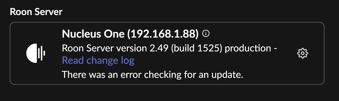

I have trouble updating my Nucleus One to the latest Roon Server version

My network setup is quite simple: I have a modem from my ISP connected to a router. From the router, a LAN cable connects to a Gigabit LAN switch. From the switch, one connection goes to my streamer DAC, and another goes to my Nucleus One—that’s the entire setup. For my computer, I’ve connected it directly to the router via LAN, as I didn’t want to pollute the signal path for my HiFi equipment by routing everything through the same switch.
I’ve already tried bypassing the switch and connecting the Nucleus directly to the router, but unfortunately, the update still fails. I’ve also safely stopped the Roon Server and rebooted both the router and the Nucleus, but the issue persists.

After doing some research on the Roon Community, I saw suggestions around entering a DNS server address. I just tried setting my DNS to 1.0.0.1, and after that change, I was able to successfully update the software on my Nucleus One.
Could you please confirm if this is considered a proper fix? Also, are you now able to see my account correctly associated with the Nucleus One on your end?
