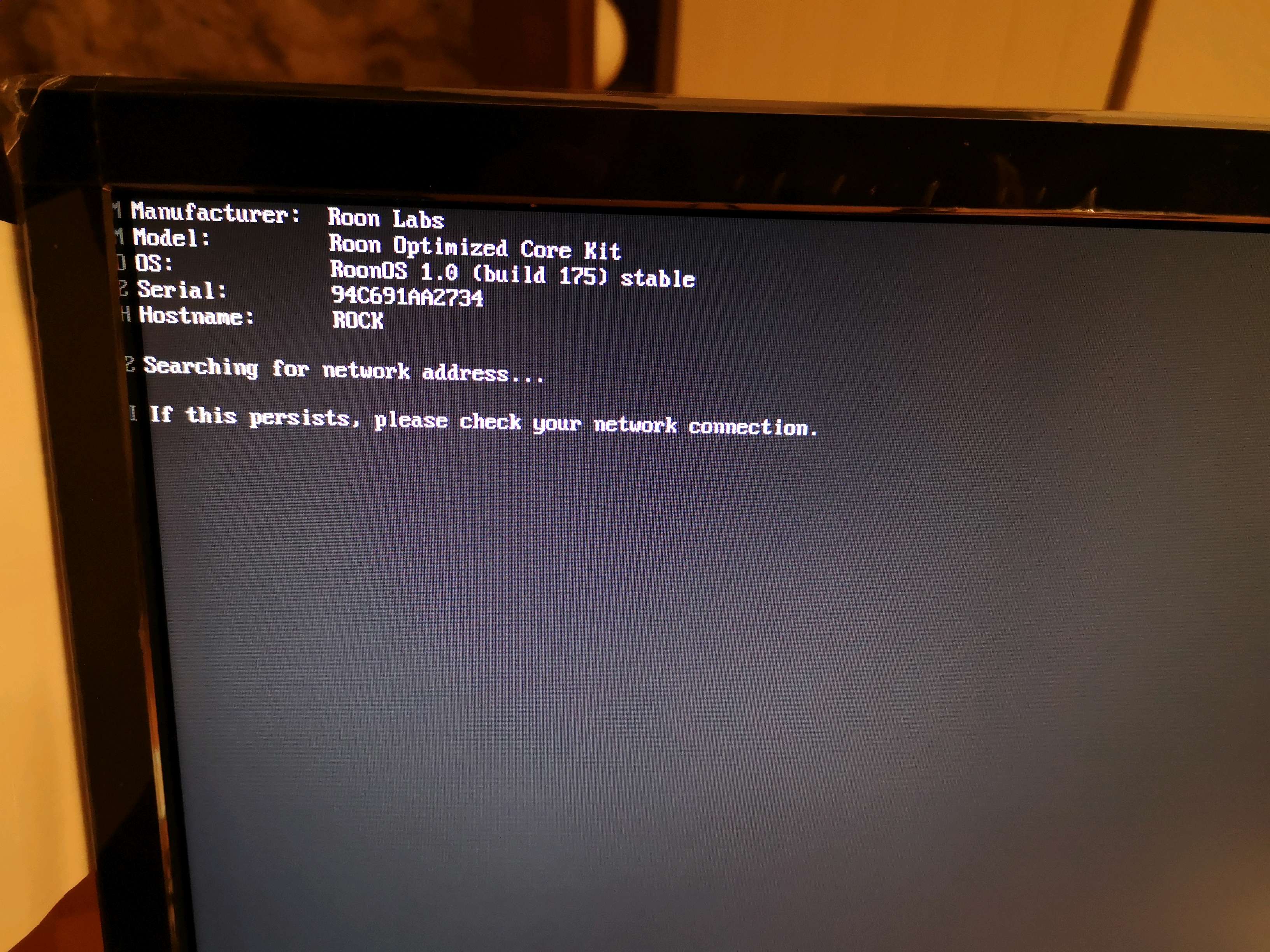

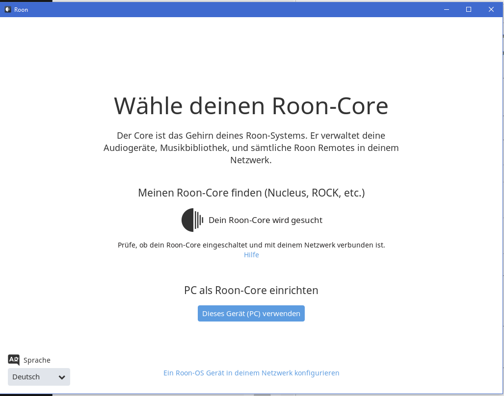

ROCK Roon OS 1.0 (build 175) on a NUC8i7BEH newly installed and still in the process of setting everything up. then I started with remote access over Android and Windows and found the ROCK with a dynamic IP. I wanted the give it a static and entered for that 192.162.1.61 255.255.255.0 submask 192.168.1.1 gateway and then for the DNS 1195.186.4.162 (this I found on my router). since then the ROCK is searching for the network adress and cannot be found anymore by Windows or Android.
@support: what shall I do?
Homenetwork with a standard router from the Internet Service Provider. the \rock over ethernet conneected to the network

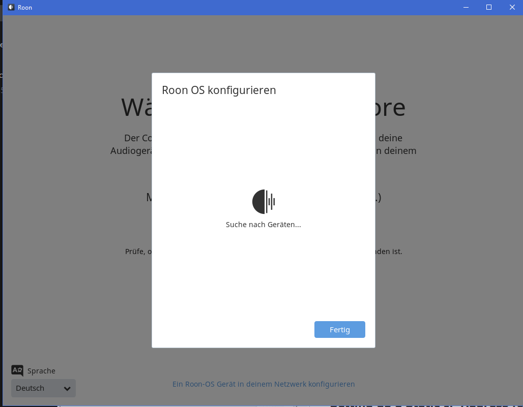

no I can not access the ROCK over the the Web UI!!
image|666x500
How / where do I change the DNS adress? with the Web UI or the Android app I can not reach the ROCK.
