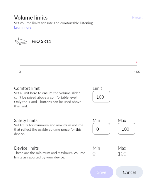

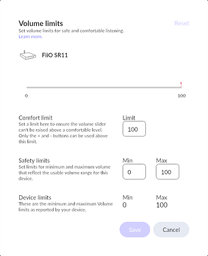

Volume limits:

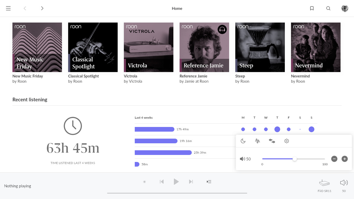

Volume control:
If you want to control volume by Roon, you have to set setting VOL as ADJ.
I set it to MAX, because I use SR11 with K11 R2R as a DAC and a headphone amplifier, so I adjust volume manually by K11.
