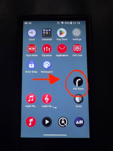

I have ordered an M33 and waiting delivery for tomorrow. You mention Fiio Roon App but I can’t seem to find it. Do you have a downlink link available or is it pre-installed on the M33?

There are two slightly different “Roon” apps you need to use on the M33 to get bit perfect playback when listening to Roon.
The first Roon app is preinstalled on the M33 and it’s called “FiiO Roon”. Once started this app turns the M33 into a Roon endpoint. You will need to go into Roon’s settings (using a Roon Remote with a bigger interface, such as a Mac or Windows desktop) → Audio → “Roon Ready” devices and enable the FiiO device. Please note that the exact name of the FiiO device will most likely not be called “FiiO M33” but something else, like “FiiO M11 Plus”, but don’t worry about the name, just rename it to whatever you like.
Then you will need to download and install the “Roon Remote” from the Play Store. Once both the FiiO Roon and the Roon Remote are running, using the Roon Remote app select the newly enabled FiiO M33 as the playback zone. This will give you bit perfect Roon playback.
Another thing that you should be aware of is that if you have the M33 R2R set to oversampling mode that all the audio files will be resampled to the higher bit rate. Using non-oversampling mode will provide bit-perfect playback at the sampling rate of the audio file.
You can also take a look at the “Fiio M11Plus ESS and M11S with Roon Ready is fanatasic!” thread for additional information and perhaps better instructions on the whole FiiO/Roon bit perfect playback than I’ve provided above. I have both the M33 R2R and the M11 Plus and Roon works the same on each one.
Thanks for this comprehensive reply. Ill get it set up tomorrow :slight_smile:
Yep! Exactly what Jazzfan_NJ stated would be my reply too. Official Roon App may be pre-installed under the FiiO Applications section, but it won’t be the latest release, so I usually just use the Play Store and grab the latest from Roon.
