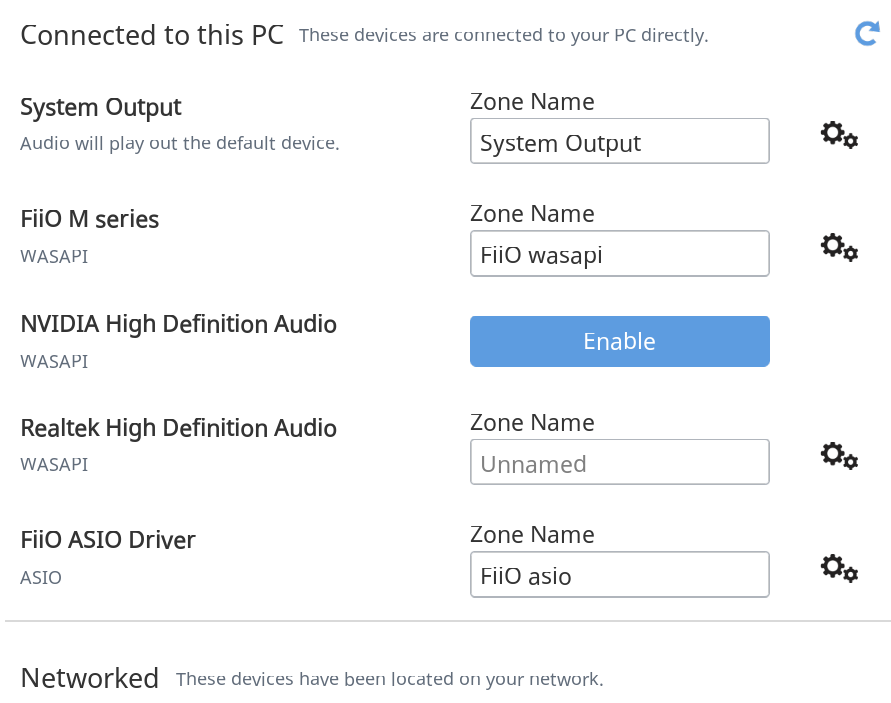

Thanks, but I uninstalled the Fiio USB DAC driver and reinstalled the FiiO_USB_DAC_Driver-V4.47.0, and restarted Roon. Got this under audio:
When I enabled the Fiio M Series, it was not recognized as playing after selecting it. FiiO doesn’t seem to have a separate ASIO driver, so I downloaded the ASIO4ALL_2_14 and it was no help. Device manage says the driver for the FiiO M is fiio-usbaudio.sys and when updated, says it is the latest. So I’m scratching my head and will contact FiiO also.
Interesting – I disabled all but the ASIO and got nothing. Then disabled all but the FiiO M Series WASAPI and now it’s playing with the end point being the FiiO. So thanks for your suggestion and time !

Good idea about other apps conflicting, but Roon was the only one running through it. As a coda, I attached a Monoprice Monolith headphone AMP/DAC (desktop) to my Roon core PC and it worked only after disabling all other audio devices! Now onto a networked PC running remotely (maybe I should quit while I’m ahead. Thanks again for your help.
Can you please double check to make sure that the DAC is not selected as the Windows output when this issue occurs? By this I mean to make sure that it is not the top item listed when you click on the “volume” icon in the taskbar’s bottom right-hand corner.
I’m glad that it’s functioning with the workaround, but this behavior is strange, you shouldn’t have to disable all other outputs to get your one zone to work.
I am saying if you do not have Windows select this device as the default, does the same behavior still occur? Sometimes when you set Windows devices as defaults, it automatically engages “Exclusive Mode” for the DAC, which is essentially Windows telling the DAC - “I want complete control of this device and do not let any other applications interact with it while Windows is using it”. If you have this configured so that the DAC is not running on exclusive mode, does the same behavior above still apply?
Yes, the DAC works fine when it is not selected as the Windows default, so it seems that Windows is not taking control. Everything is running well now, whether Tidal audio is set for exclusive or not, according to correct info from the Signal Path. All other audio devices are not exactly disabled, they are labeled “enable.” Sorry if I misled you in any way. Thanks for your suggestions!
