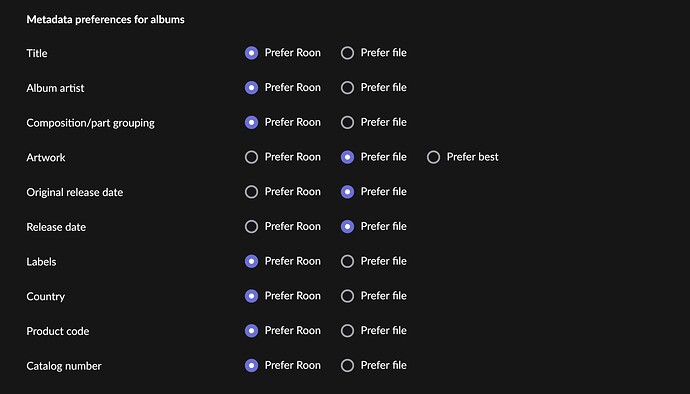

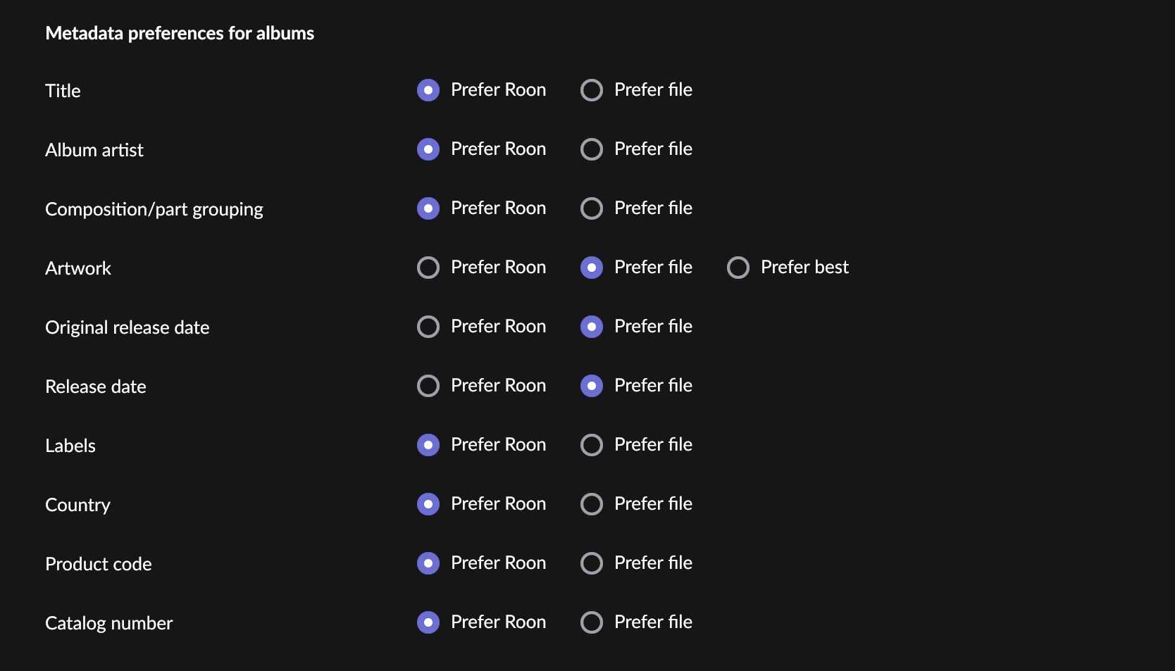

Also, are you aware that if your import settings for album art are set to “prefer file” that Roon will do as you describe, and never fall back to the online artwork database? I’m so persnickety about album art that I never want anything other than my own.
Hi,
Thanks for the reply. I am aware of that setting and that is how I have Roon configured. However, if Roon in the three failure scenarios I described can’t read the artwork it will use its own or show a blank if it has none.

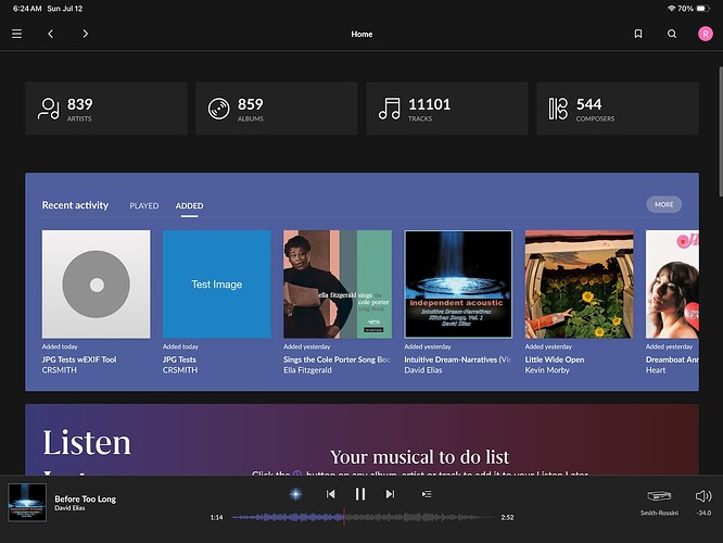

In the screen shot attached I created a 1000x1000 jpg in Pixelmator pro and applied to a test album. I then duplicated the jpg and ran exiftool and applied to the same album duplicated with a different name for ease of observation. The same image is in both but Roon can’t read the JPG after the exiftool strip despite it being a valid JPG.
