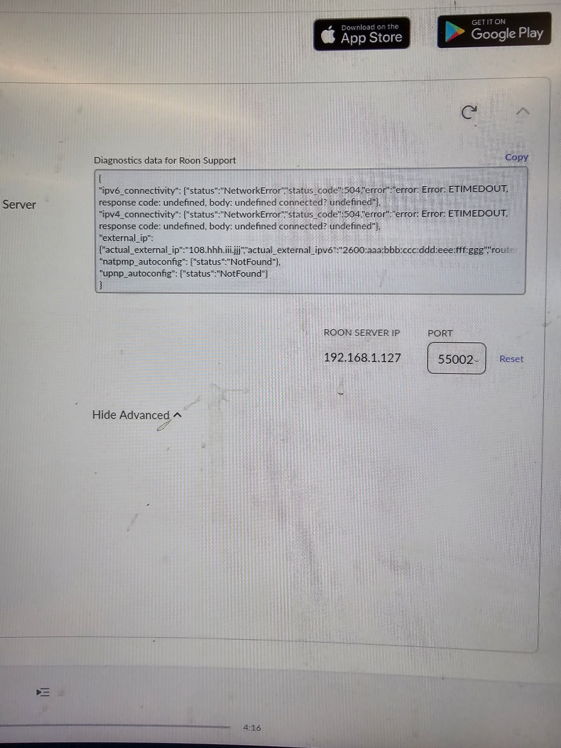

made mistake was loged in microsoft on two devices erased things on one machine not nowing i was erasing both devices ,so added them back from recycle bin now problems please help
made mistake was logged in two different computers was erasing things at work didnt know it would do the same at home , th en tryed adding back from recycle bin causing duplicate icon 2 or 3 roon server no cant connect to roon arc please help

When you’re unable to connect to ARC, could you share a screenshot of what you’re seeing? Also, please go to Roon Settings → Roon ARC and let us know if there are any error messages displayed there. That information will help us better understand what’s going on.
Hey @daniel, here’s the screenshot you requested from @Alfred_Bynum. They’ll respond here with any other updates. :smiling_face:

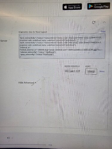

Thank you for your patience. Our accounts team has forwarded the screenshot you shared concerning ARC diagnostics.
The specific diagnostic snippet indicates that Roon has not been able to configure a port forwarding connection with your router through which it can reach ARC when your phone is outside the network.
I’d first double-check that UPnP is enabled in your router settings administration page. If that doesn’t help, try entering a manual port forwarding rule in your router settings page (this is usually under a “port forwarding” section). The rule should be TCP and match the port number and IP address listed in the screenshot (ie. the Roon Settings → ARC page).
