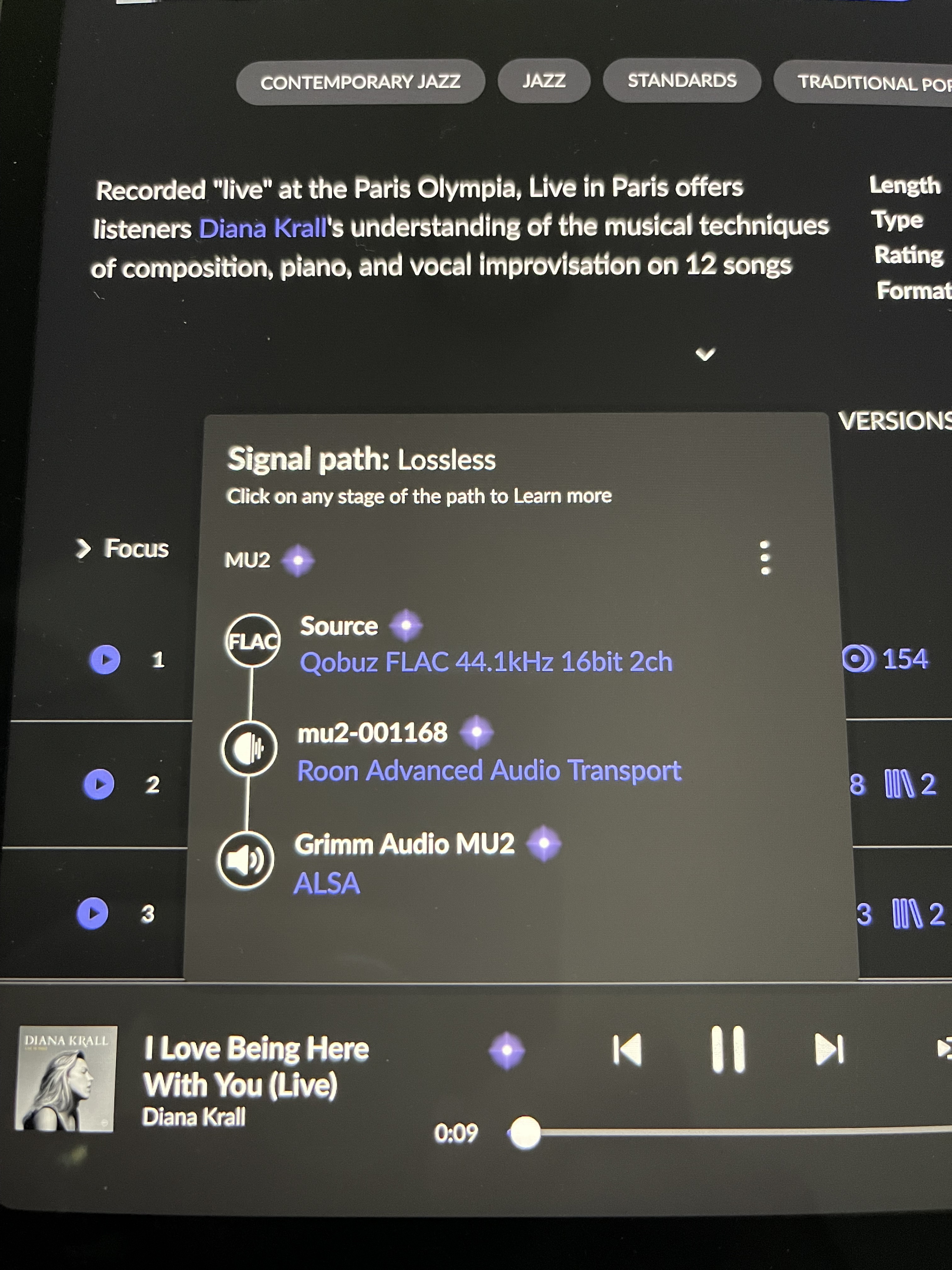

Can you post a Roon Signal Path screenshot for each of these configurations.
The signal path is the same in both cases:

Your signal path shows the Grimm as the DAC at the Alsa stage. It’s not showing any DSP for the DAC so the preamp section is in the analogue domain and is always in the signal path even when set to 0 according to reviews. All Roon will do is control this analogue volume control nothing is being added. If you can play it fixed then it sounds to me like your using it to another preamp so this is likely your issue with levels. What are you hooking it up to pre amp it active speakers?
