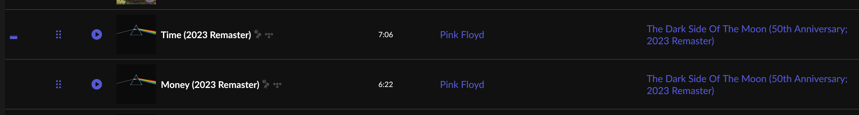

  2. No relation to all format 192/16 or 192/24. Different files are playing correctly. To reproduce issue need to do next steps:
  • Play any track with 16/44 format than try to play from Tidal track Time / Pink Floyd - see screenshot below.
Money could be played but once could reproduce same issue. Other tracks wasn’t found reproducing case.

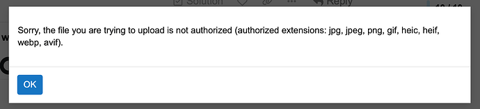

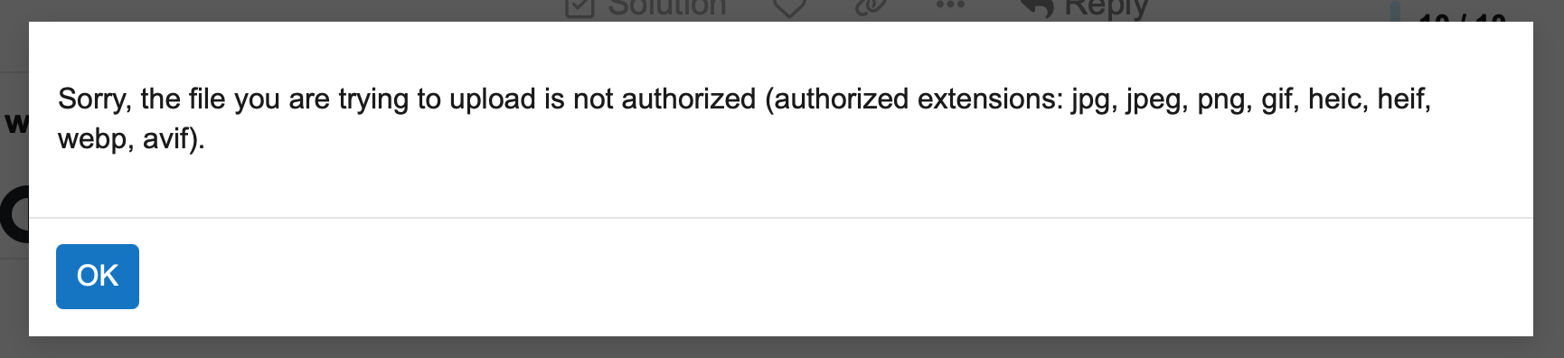

Can’t attach log files as not permitted *.txt extension.
Please advice how I can add the logs.

Can’t update zip.

That’s a message from the forum, to upload an image.
You need to upload to the link in this post.
