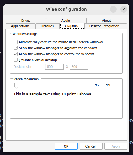

This thread describe what I run to get Roon on Wine running. I’ve not experienced any blurring, but I’m running 1X scaling on 1080p. For an LTS, e.g., there’s no i386 architecture, so those steps can be removed.
What you may need to do, in addition, is use winecfg to adjust the scaling to match what you’ve done for Roon. You’ll need to increase the DPI.
Edit: Run winecfg under the Roon-on-Wine prefix.
Ah - that makes sense, give that increasing the font size indeed helps - I concentrated my problem solving efforts around Wayland mode and that message, quite frankly did not occur to me to try to improve X (or Xwayland mode, to be accurate)
Thanks for the tip.
