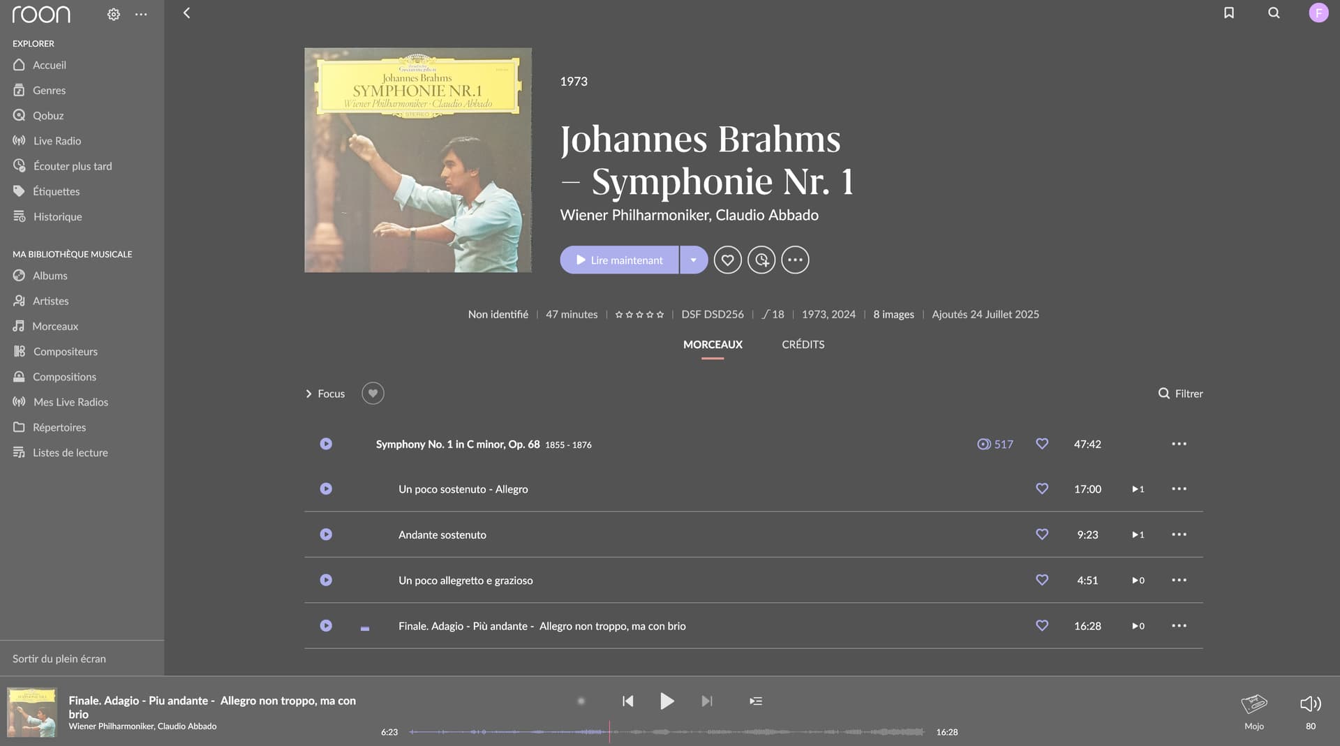

Roon interface looks all washed out after a system upgrade:
It looks like a HDR bug but I’m not sure. Some covers are “clean” other are washed out as well. Any idea? I’m running wine 10.19 on wayland.
EDIT: I’ve tried to downgrade wine and mesa but the overlay is still there. I’ll wait for your feedbacks.
I don’t think the version of Mesa matters much to Roon. Whether you run Mesa 23.2.1 on Ubuntu 22.04 or the latest Mesa 25.3.0 from kisak-mesa PPA, the faded colors are the same.
What solved the problem for me was switching from winehq-staging to winehq-stable. Now running Wine 10.0

Not sure if you ever fixed this but I also was having this exact same issue and I also did not want to downgrade wine to previous version so I installed wine 10.14 (last version that worked for me without that washed out issue) and put it in /usr/local/bin/ and named it wine10 so I could keep using up to date wine for other things and just have this version only for Roon.

I had the same on CachyOS (Arch based distro) with the default (Arch?) wine packages. CachyOS publishes their own package with a set of optimizations (probably mostly for gaming), but that did fix the washed out color / overlay issue for me.

@robin246 and for those struggling with washed out colors on wayland: I made a fix for wine. It is due to a double sRGB conversion on default framebuffer. Arch users can freely download a working build or a PKGBUILD from here (with the patch). But please: try at your own risk this is not yet official.
A ticket is pending: https://bugs.winehq.org/show_bug.cgi?id=59436
Thanks, @rulbricht. I’ll wait for the official fix. :slight_smile:
For Ubuntu (and derivatives), the simplest solution is to stick with Wine 10.0.0, since the issue is present in Wine 11.0.0.0. I prefer to use the Wine HQ builds.
