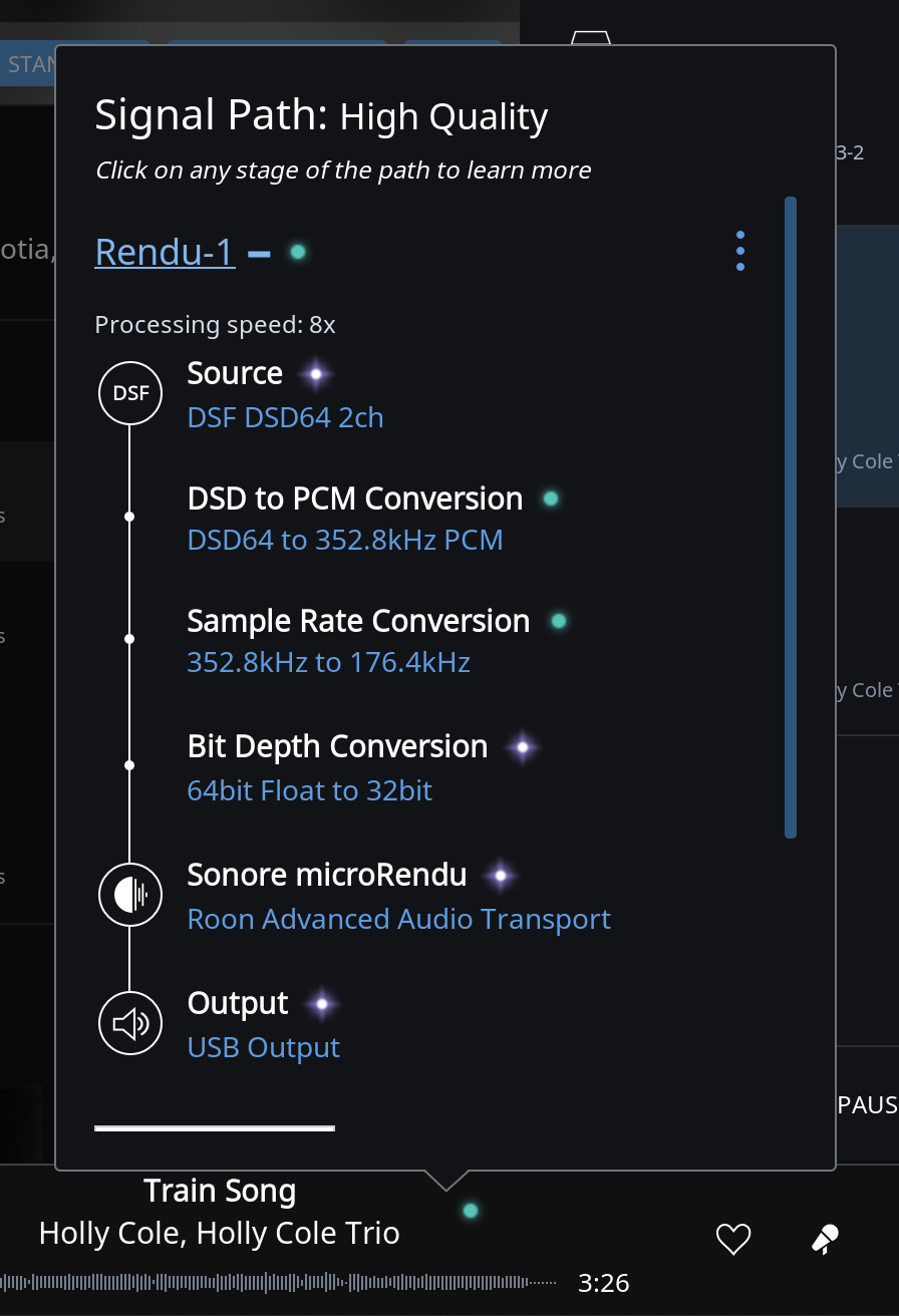

Here is my config, showing 2 playback chains terminating at the same (non-DSD) DAC. One is properly converting to PCM and plays back well. The other is sending DSD and of course plays only hiss as expected.

Here are screenshots of the Device Setup for each streamer:
Simaudio MiND (not working)
Sonore Microrendu (working)

It looks like since the MIND does accept DSD then Roon does not give you the option to set DSD playback (Convert to PCM/ Use DOP / dcs Playback) at the device level. Unless I missed something from your screen shots.
You can use DSP to convert the DSD to PCM. Go to DSP settings. Sample Rate Conversion (remember to enable the setting). First option, select the drop down and choose Custom. Scroll down and you should see DSD playback, use the drop down and select the PCM resolution to convert to. Do this for each DSD line.

That did the trick. Thanks for point me in the right direction. I’d looked in DSP settings before but was looking for a global option, I hadn’t gone down the custom route, piece of cake. Thanks again.
