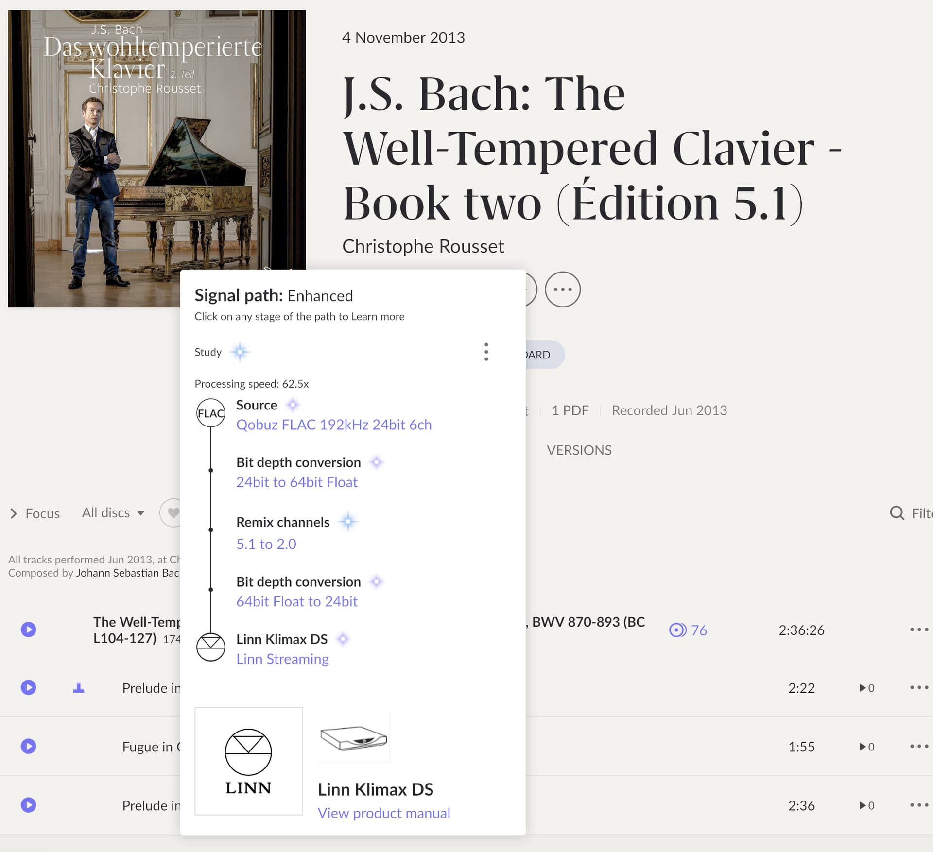

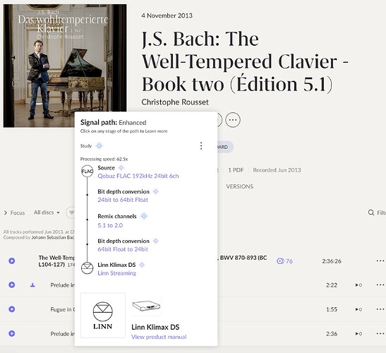

Qobuz occasionally serves a 5.1 source track, examples below. We have a stereo player so downmixing to 2-track is happening. This is giving frequent dropouts (to the point where it is unlistenable).
We have recreated this issue on a Linn endpoint; using an iPad as an endpoint; using a LUMIN D1 endpoint; and on another user’s system by @CrystalGipsy.
It would be best if we could get the 5.1,conversion to work; but an alternative would be a settings option to stop Qobuz sending 5.1 content.
Ubiquiti network (UXG-Pro, 24-port managed switch). Roon Server version 2 build 1490 running under DietPi on Intel NUC. Linn Klimax and LUMIN D1 on wired network; iPad on wifi.

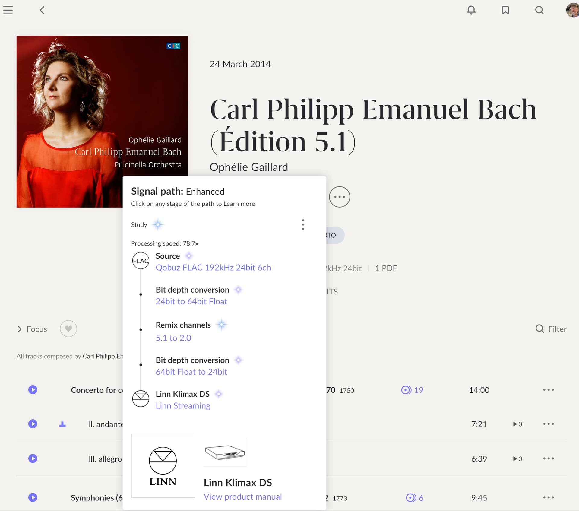

Here is an example album.

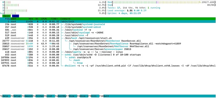

The DietPi processor (Intel i7) seems to have plenty of capacity - here is htop at the time of the dropouts:
and here is a second example:

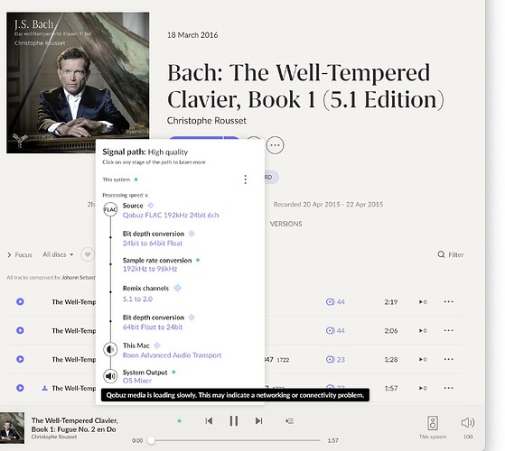

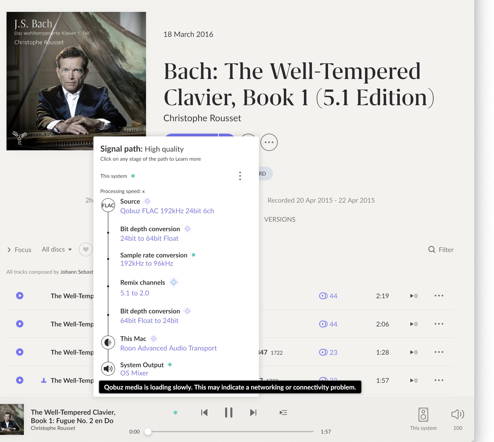

Also replicated when playing from Roon app to local system on Mac (which also showed a message “Qobuz media is loading slowly”:
Since processing speed in typically > 50, it suggests that the issue is something other than server performance.
The logs may provide an insight, but I’d say it’s probably network related – when I’ve seen slow loading media messages, it’s usually that or a firmware update needed some intervention.

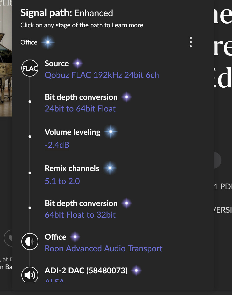

That is due to six channels of 192 kHz to 96 kHz sample rate conversion.
AJ
You commented twice on your much lower 5.4x Processing speed. I merely explained the reason. That is all.

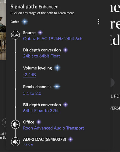

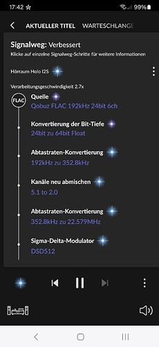

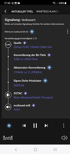

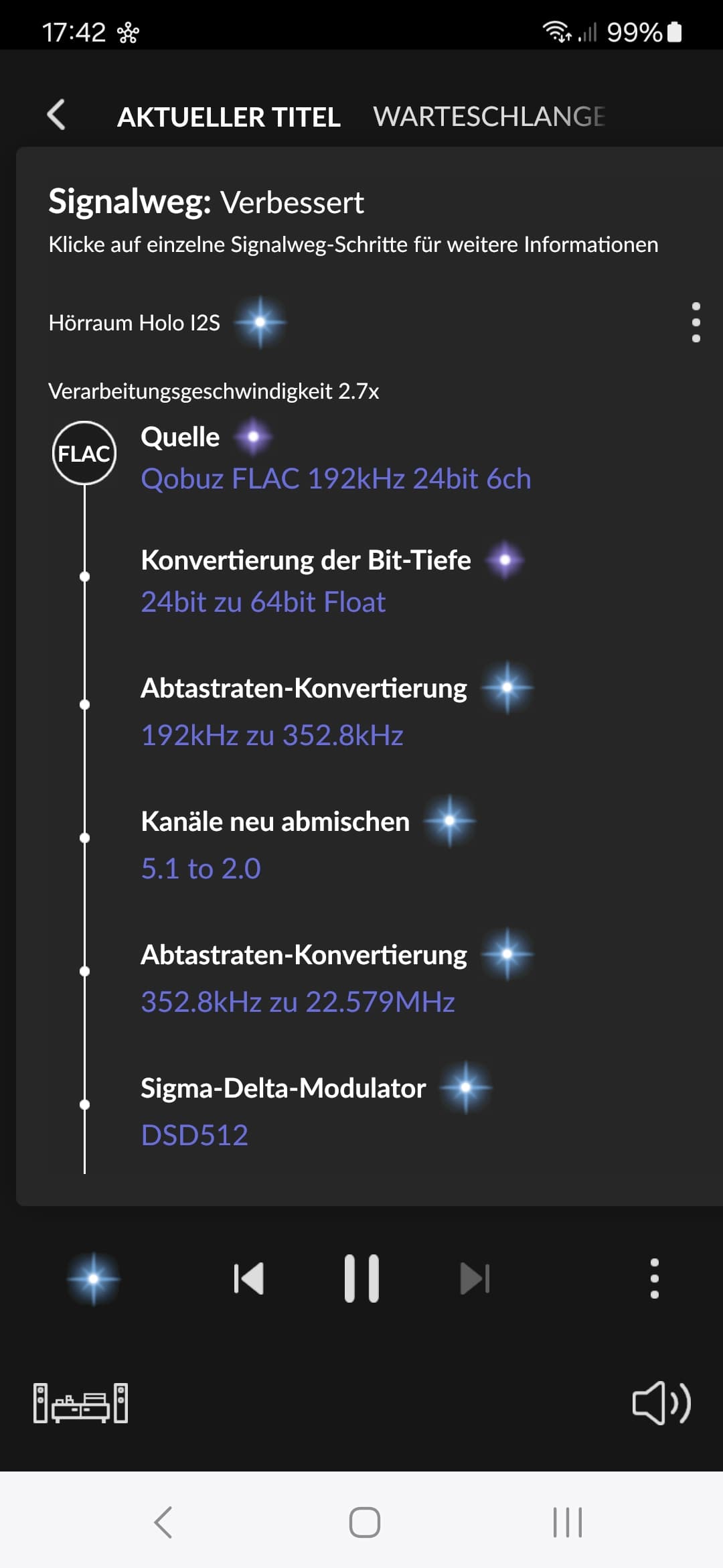

For me it’s, not a problem, playing the Emanuel Bach track in stereo (Holo Audio Red → I2S → Holo Audio May → Primare PRE35 Prisma):
or multichannel (Win10 MiniPC with RoonBridge → ASIO → exaSound e68 DAC → Emotiva XMC-1):
Both times upsampled to DSD512 (stereo) btw. DSD256 (multichannel).

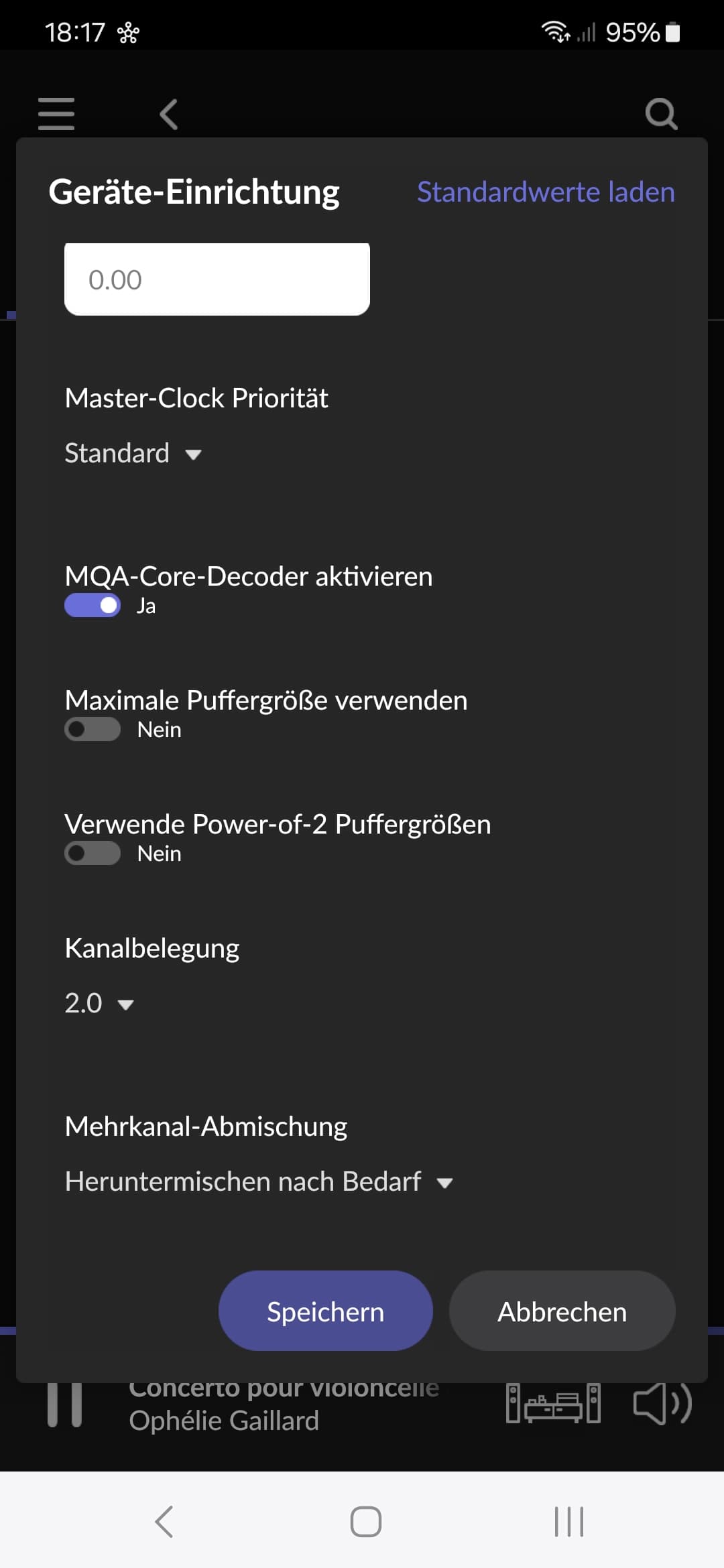

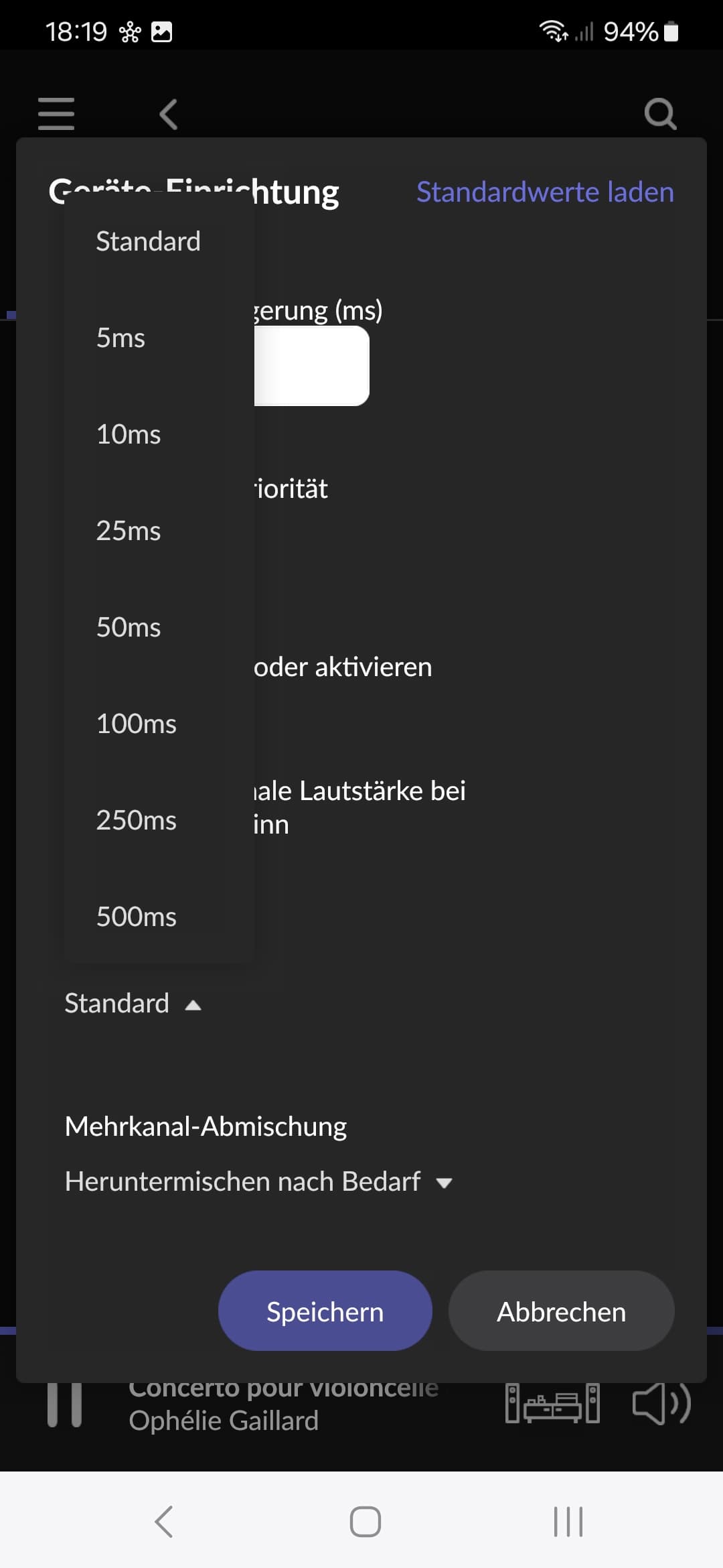

For each endpoint you’ve buffer settings:
or

Not every endpoint has them, none of my Roon Ready devices (Naim and Wiim) do. And with RAAT I suppose it has to be that way because hardware buffer size differs by device and you would force multi-room to de-sync if buffers differ.
