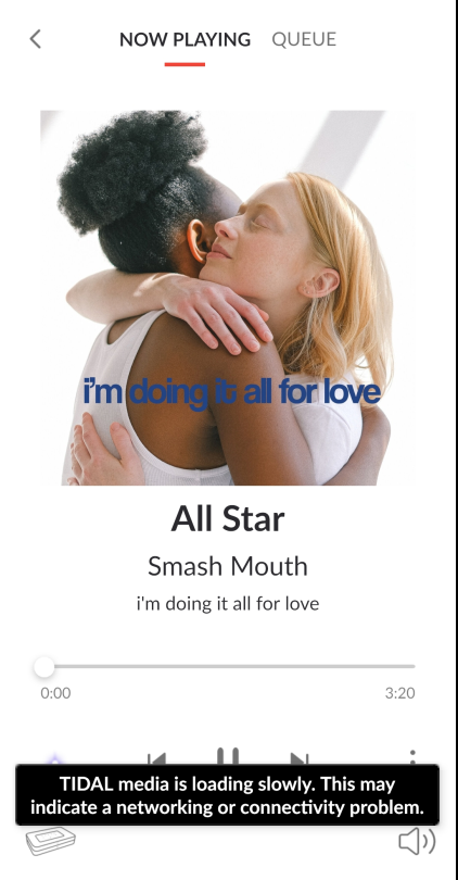

Since about a couple of weeks I have been experiencing drops when playing music to Bluesound Node n130. At least once every hour but most of the times more. These drops cause a pause that takes 2 seconds - 10 seconds. and sometimes this also causes track skips. This happens on both Tidal and Local music.
When I use the Tidal app or Bluesound OS directly this does not happen (so when not using Roon).
Other roon end points don't have this issue.
