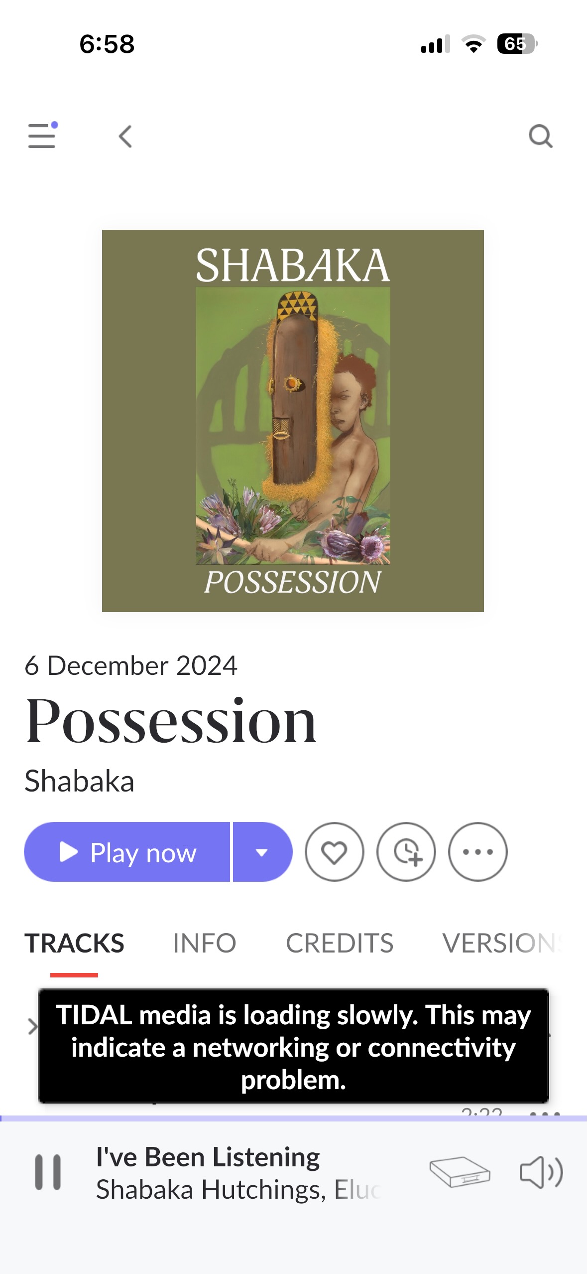

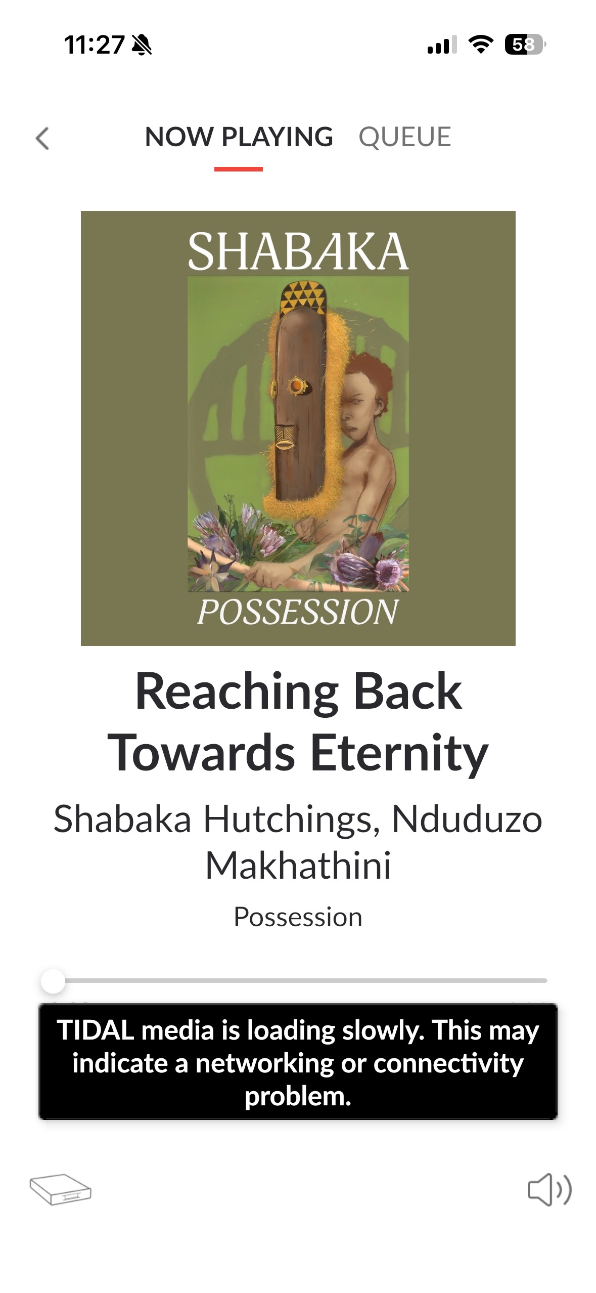

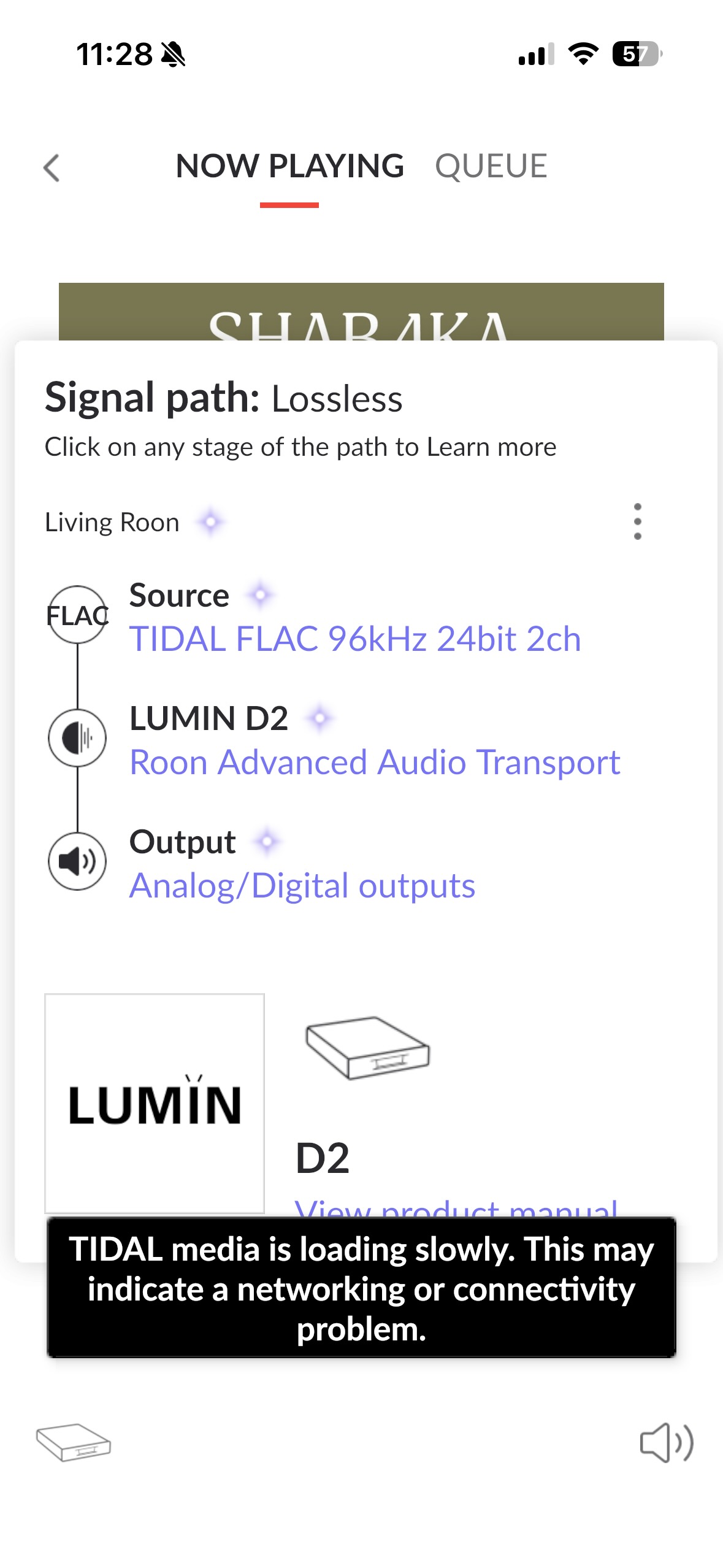

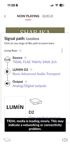

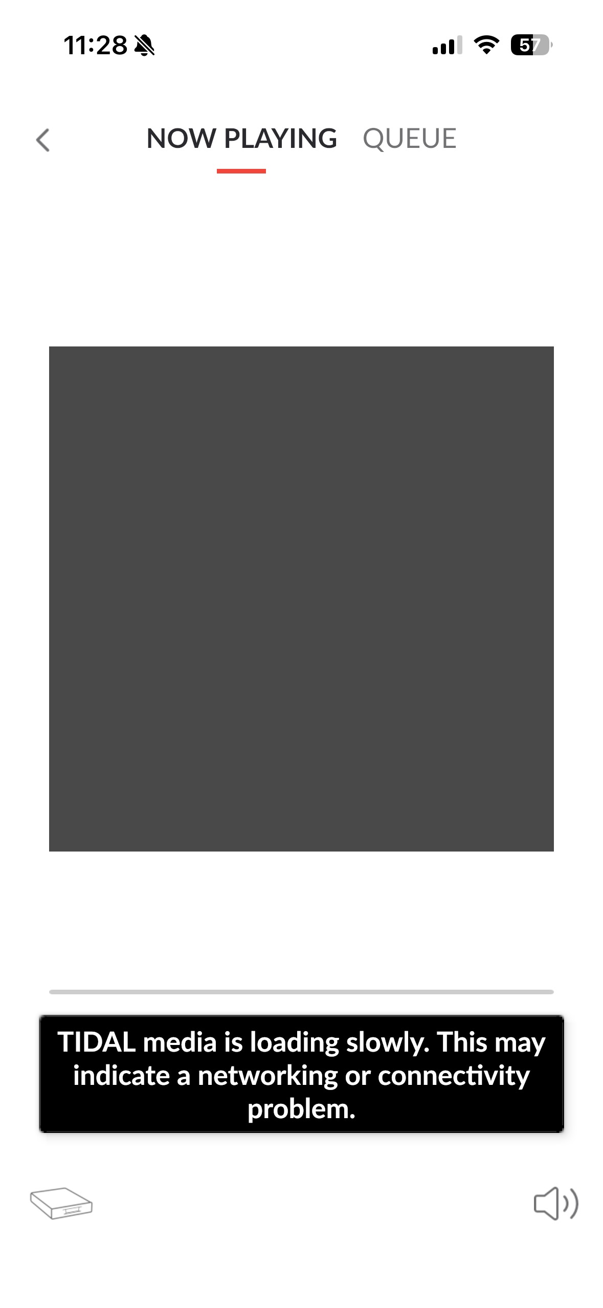

· 6:58PM ET Today, Shabaka - Possession - I've Been Listening - TIDAL FLAC 96kH 24bit, but all tracks on all playback
· Lumin D2, latest firmware

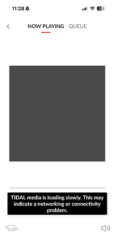

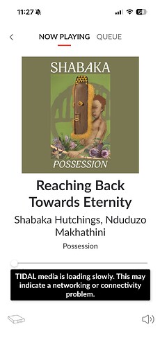

Playback error "TIDAL media is loading slowly. This may indicate a networking or connectivity problem." Same for QOBUZ.
Roon Core Roon Server (latest version, build 1496) Mac Mini M1 2020 16GB RAM, hardwired ethernet. Verizon Fiber connection, via Unifi Network hardware. 1gb up/down. Lumin D2 Streaming DAC, latest firmware. Hardwired ethernet.
I used to only have this issue sporadically with Qobuz but now it is happening for both Tidal and Qobuz. I cannot play a single track in its entirety without playback freezing with error message and then skipping to next track.
Just started happening. Nothing in my setup has changed. Thanks for any assistance.

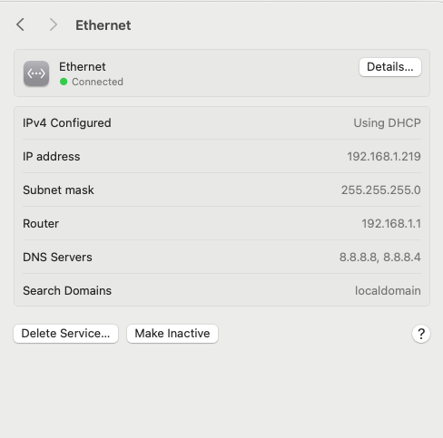

In Mac, disable firewall, and set DNS to 8.8.8.8. Then reboot the Mac.

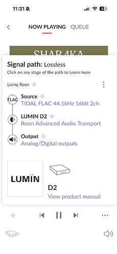

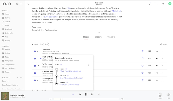

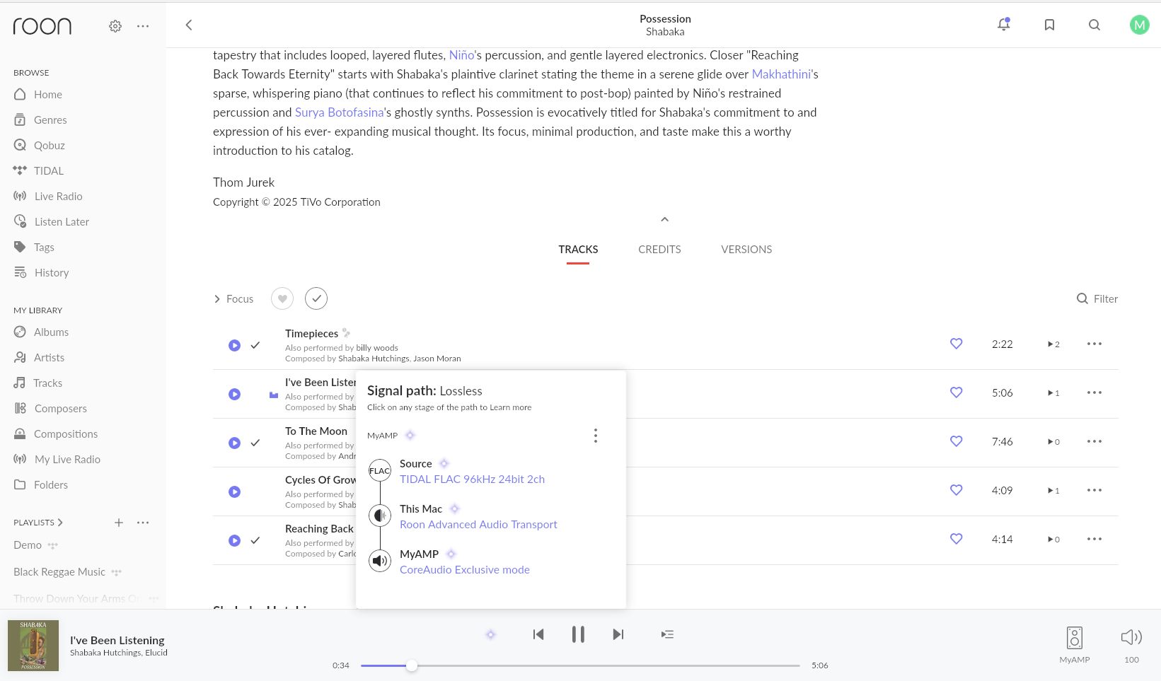

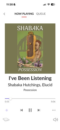

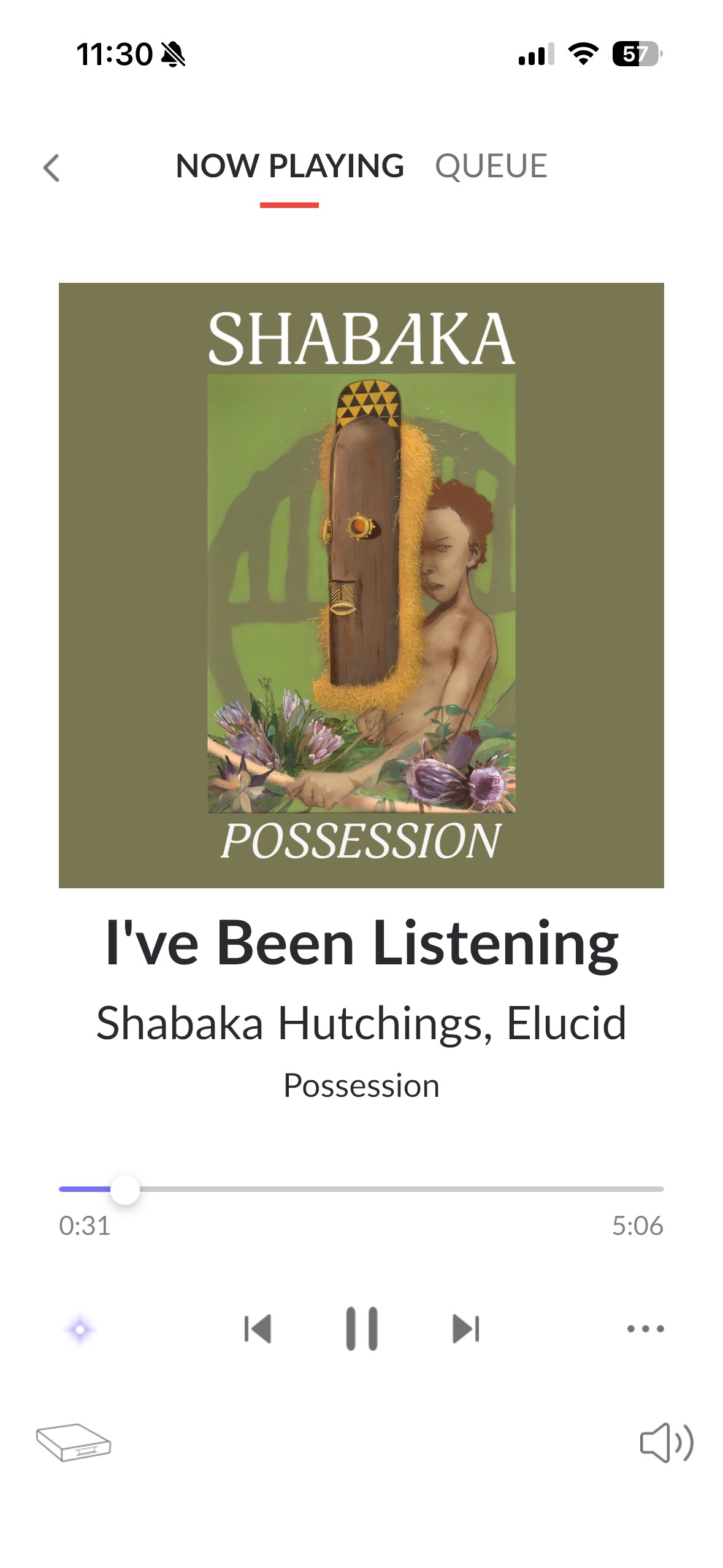

Thanks so much Peter. I reset the DNS to the Google DNS as suggested. Unfortunately, that did not seem to solve the issue :frowning: I played the 44/16 version of the tracks via Tidal and they seemed to play OK. When this happened before it was with the Qobuz 96/24 files. Once Tidal abandoned MQA and went 96/24 FLAC as well, the freeze happens now with both Tidal and Qobuz higher res files. When I play the Tidal 96/24 on the Mac Mini Roon Server (USB out to a MyAmp) it plays fine. The issue only seems to be playing to the Lumin in my main living room system. Some more screen shots attached.

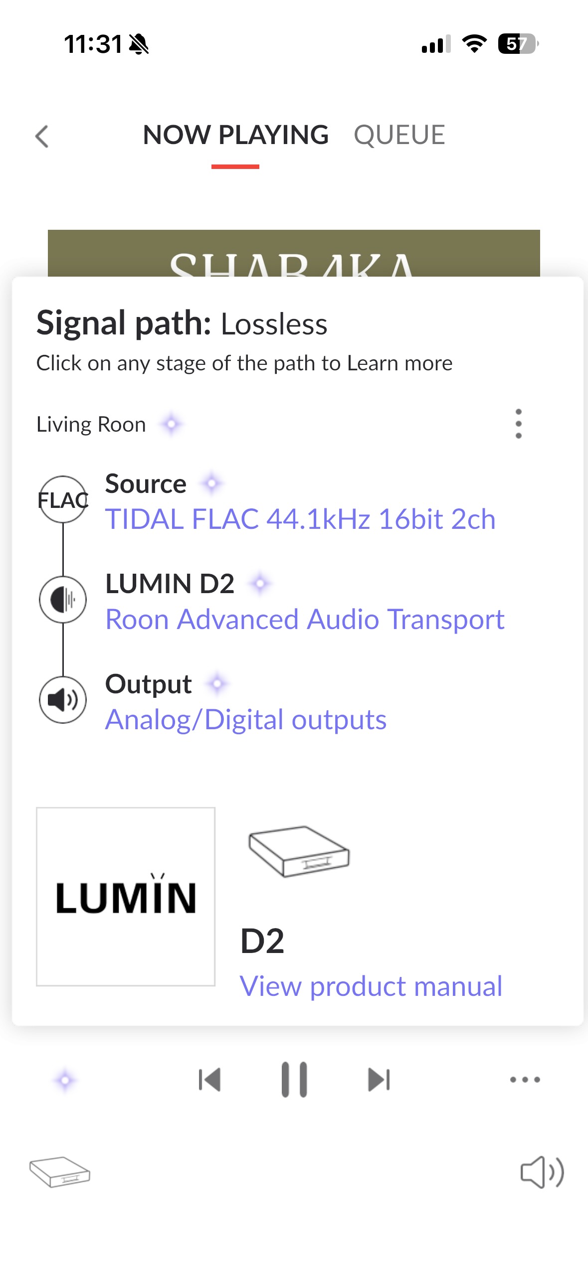

A few more screen shots:

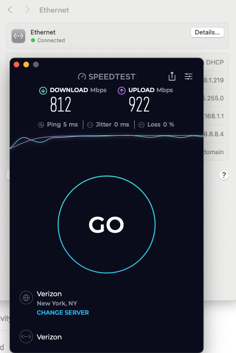

It certainly feels like this Roon-specific transport method architecture is an issue. I have a very strong network and have zero problems with any other service (strong bandwidth, wired connections consistently ~850-920 mbps on a 1gbps fiber line, with sub 6ms pings). I can even “Airplay” the Tidal and Qobuz files directly to the D2 over my Wifi. I love the convenience Roon provides but having to have a super specific network setup (hardware/software) really puts the onus on the end user and reduces some of that convenience.
