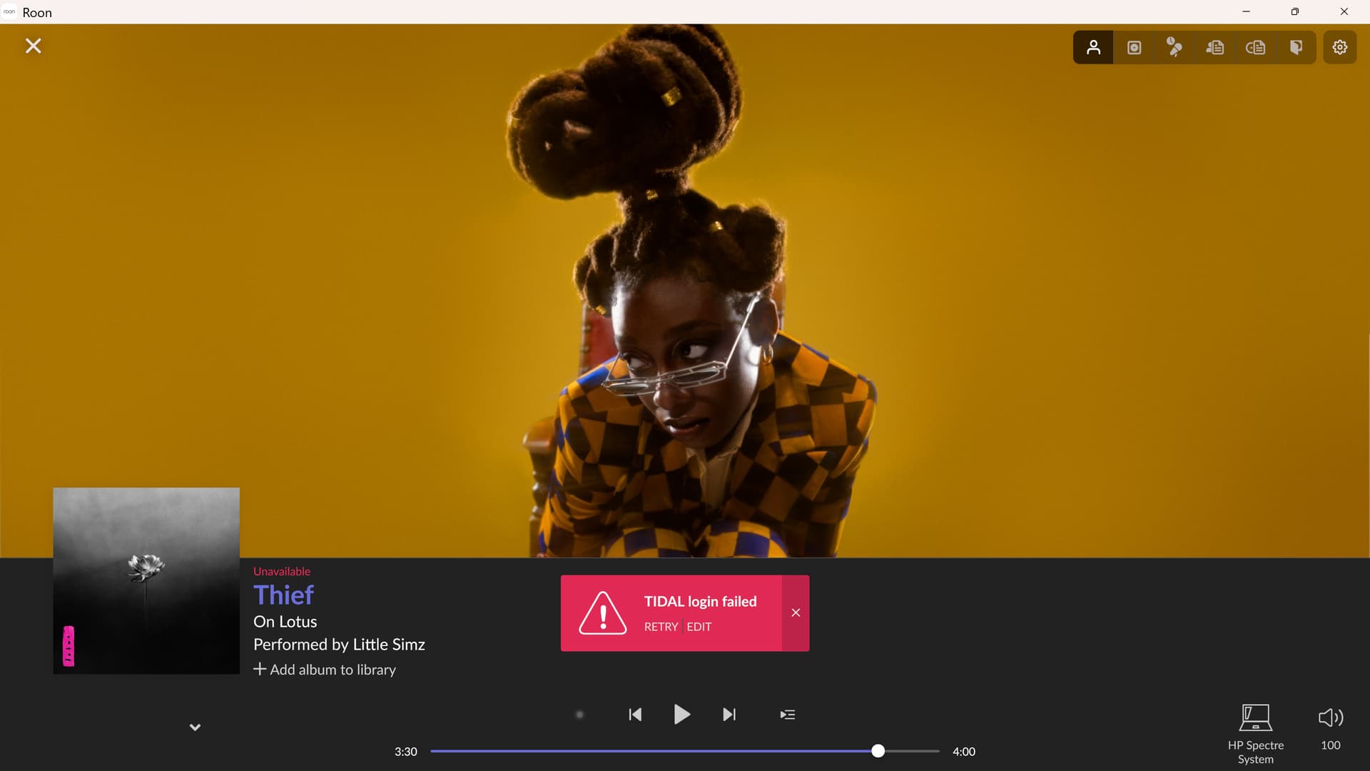

Tidal logs out regularly in Roon, so when I'm away from home for days, ARC doesn't have access to Tidal anymore, and I'm forced to use the Tidal own app until I come home, open Roon on my laptop, where I find the little red message that pops up at the bottom of the screen that says "TIDAL login failed" with 2 clickable options "RETRY" and "EDIT". Only when I come home and I click "RETRY", Tidal finally reconnect automatically and ARC returns to streaming it.

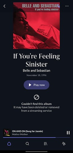

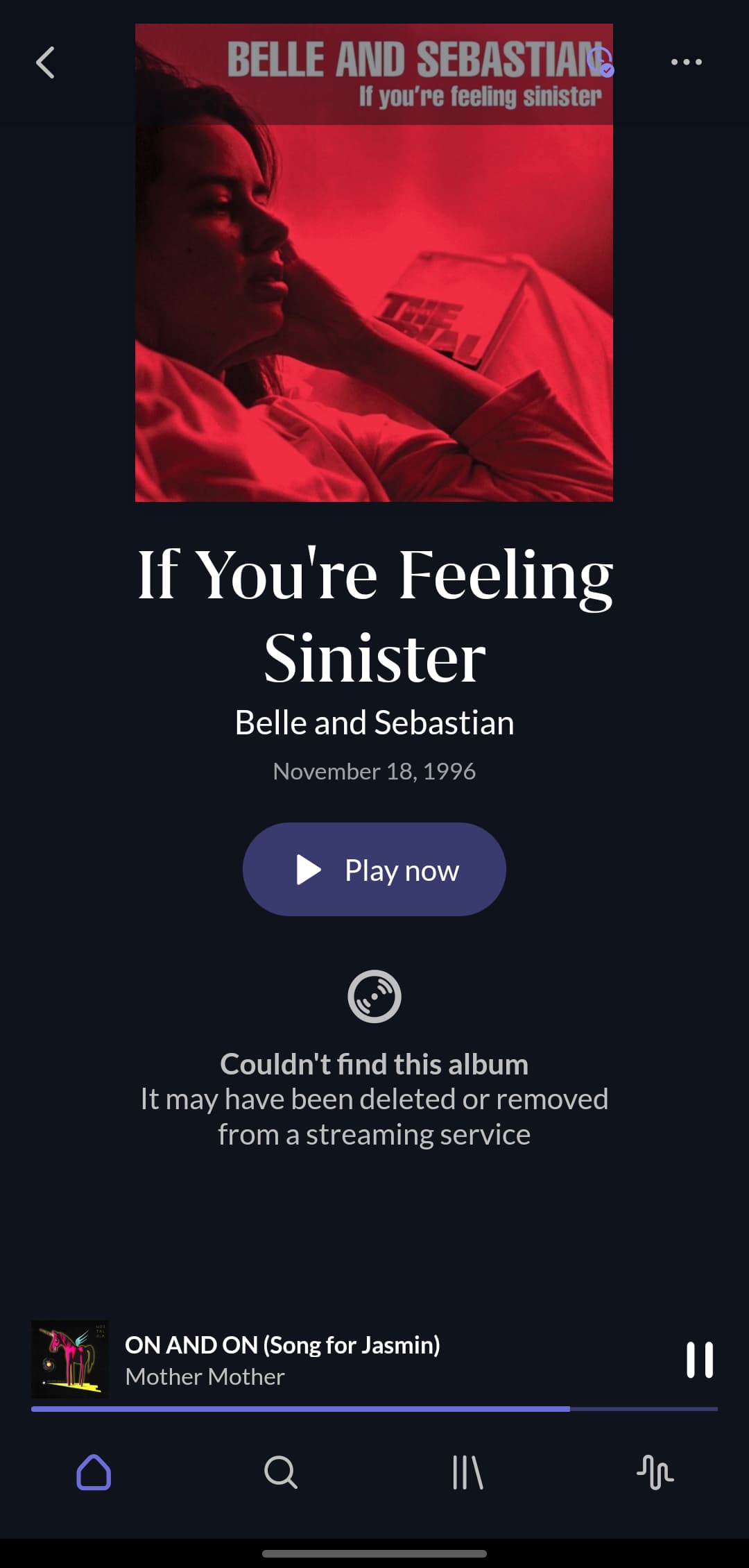

It has affected me negatively, particularly during May, because I had 2 periods of 10 days each when I was away from home and was using ARC. And suddenly, in ARC, all the tidal albums were saying either "unavailable" in red under each track of the album or the tidal album wasn't even showing the tracklist and only showed "Couldn't find this album. It may have been deleted or removed from a streaming service". During those periods, at first I asked someone at home to restart my server, which was tedious to explain because of their lack of PC skills, and that made reconnect Tidal. But then I gave up because it had been happening almost every 2 days, and I just waited to come home so I could monitor the situation better.

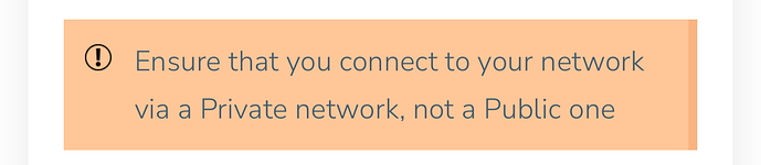

I set the Google DNS. Should I set my Wi-Fi network as private network? It’s currently on Public by default.
Thanks
Certain discovery protocols are disabled by Windows on public networks for privacy/security reasons. That’s why they distinguish private and public networks in the first place, because not everything works with the public setting.
Therefore, Roon recommends private:
From:
Thank you! :raised_hands:

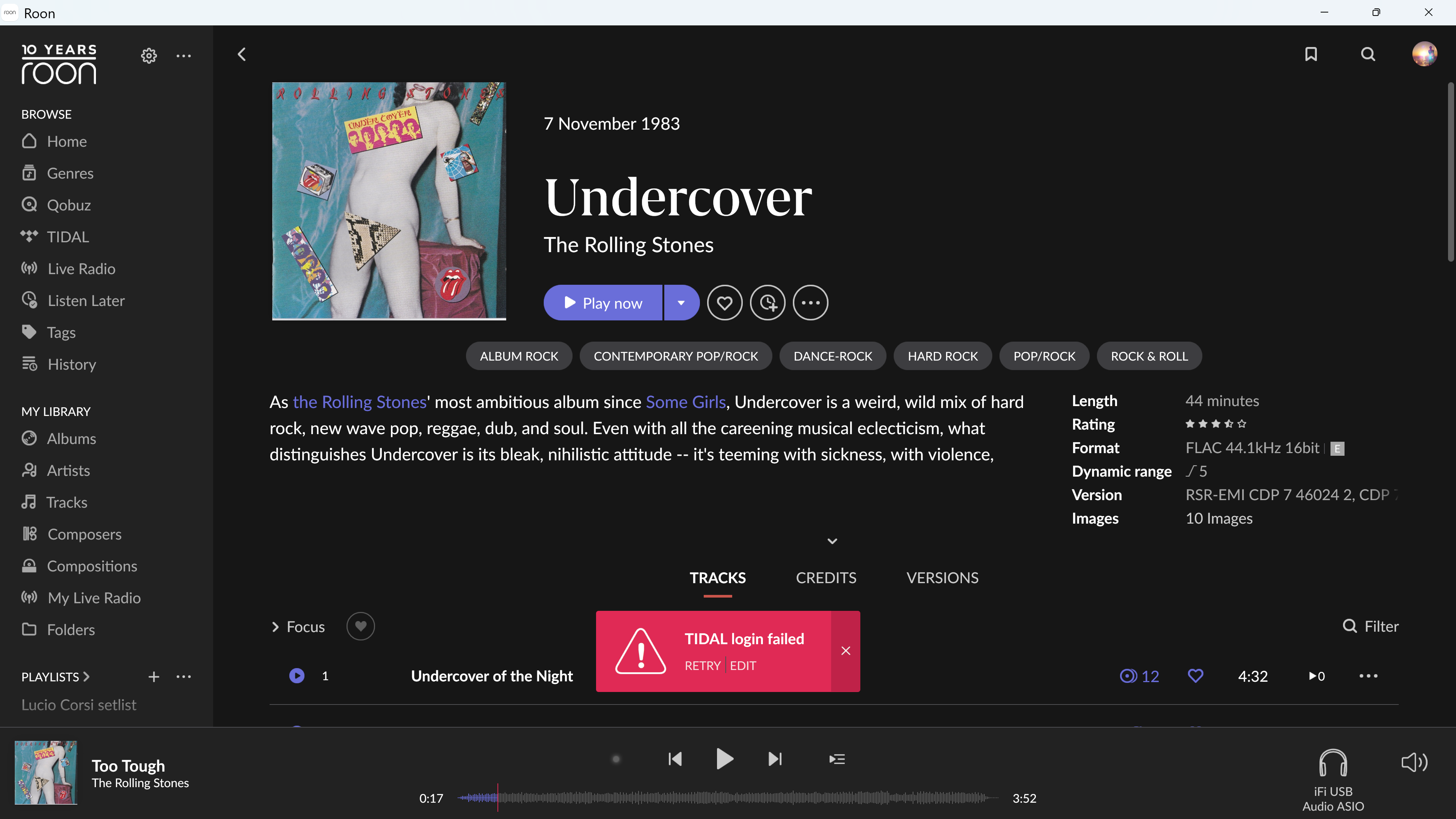

So I went to my laptop, opened Roon and got first the “Qobuz login failed” message and then the Tidal one.

An update on this: I tried manually disconnecting the Wi-Fi from my laptop and that triggers tidal and qobuz to log out and those messages to appear.
I did it a few times. Sometimes Tidal and Qoquz re-logged in automatically when I reconnected the Wi-Fi, while other times not and I had to manually re-login to both using the retry button in the red messages above. Maybe those times when I experienced not being able to access Tidal/Qobuz in ARC were times when a manual re-login was needed?
