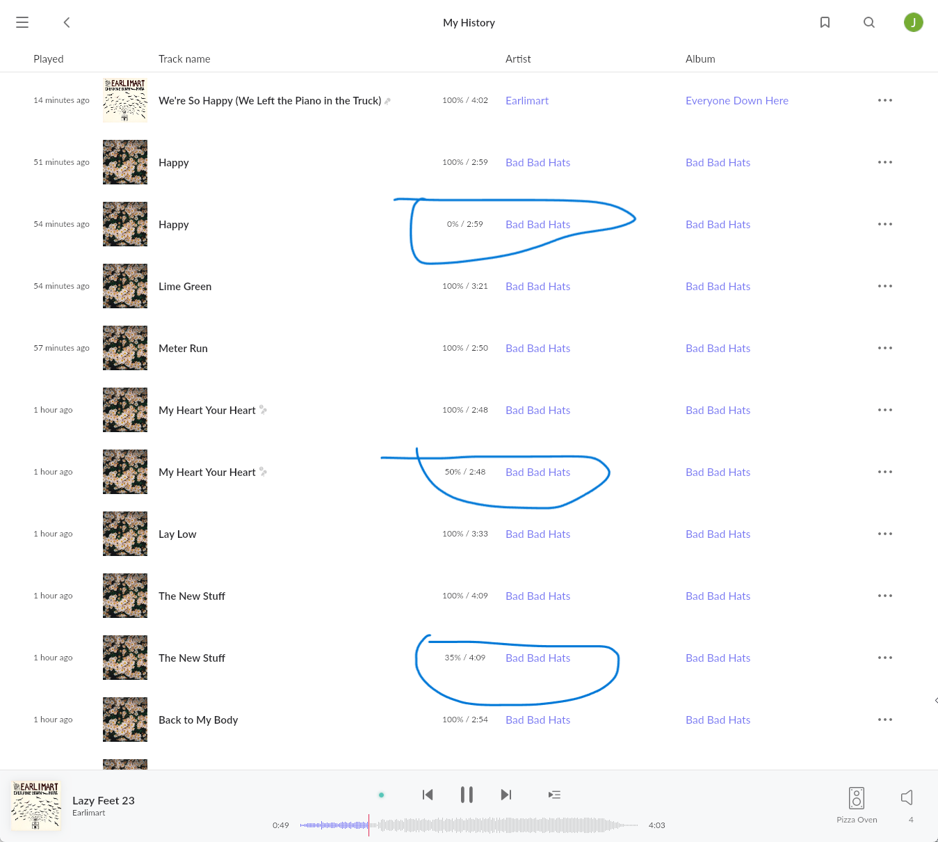

· between 930-11am eastern. songs "The New Stuff" "My Heart Your Heart"
· Sonos Port connected via ethernet (not using airplay)
Sonos Port. I am using the sonos (not airplay) mode to send audio. Very frequently whole tracks will just skip and not play. Additionally sometimes a track will start partway through the song instead of at the beginning. Also pausing and unpausing has unpredictable results often.

I just had this happen where a song just completely skipped playing in the queue. The song is in my local library and in MP3 format. So I have seen this with both flac and mp3 formats. And both with tidal and local sources.
