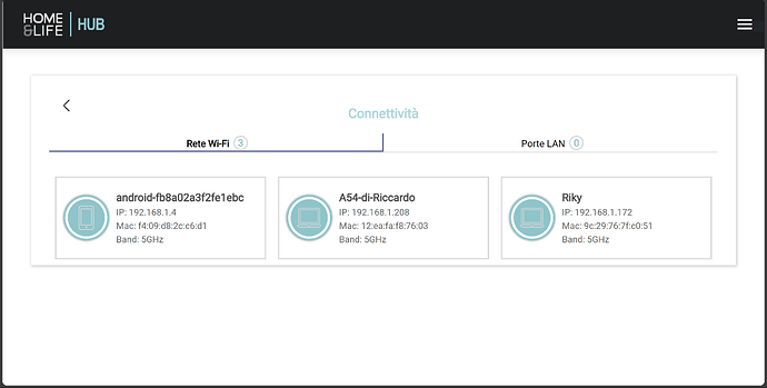

What is the specific router model you’re using? We can likely find a manual online to help guide you through next steps:
  1. You’ll want to open your network settings, usually through opening the webUI through your internet browser. From there, you’ll be able to take a more detailed look at all of your devices across your network.
You may have the option to disable certain settings as well, but we’ll need the specific router information before taking any direct next steps.
Just to provide proper expectations here, running your core device over wifi will likely lead to continued performance issues in the future. While a hardwired connection isn’t technically required, it is heavily suggested. I’d give our best practices article a read for more information:

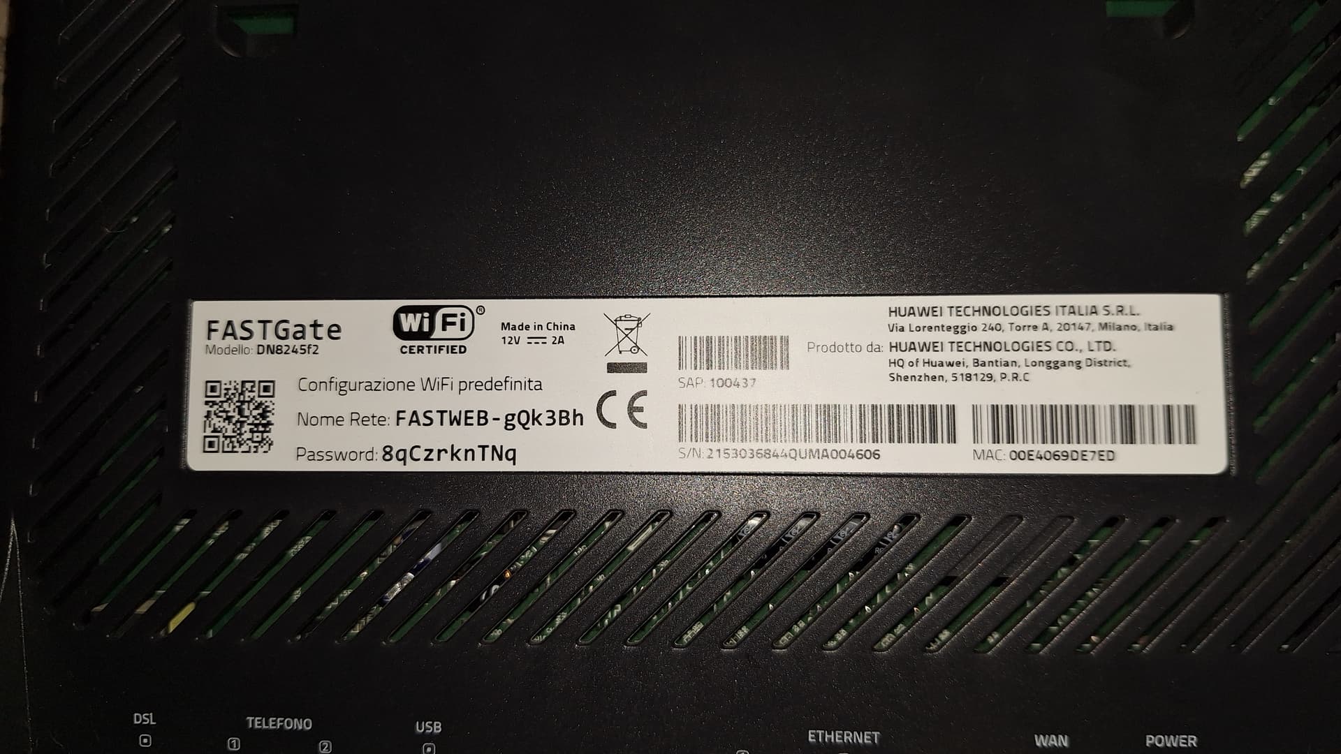

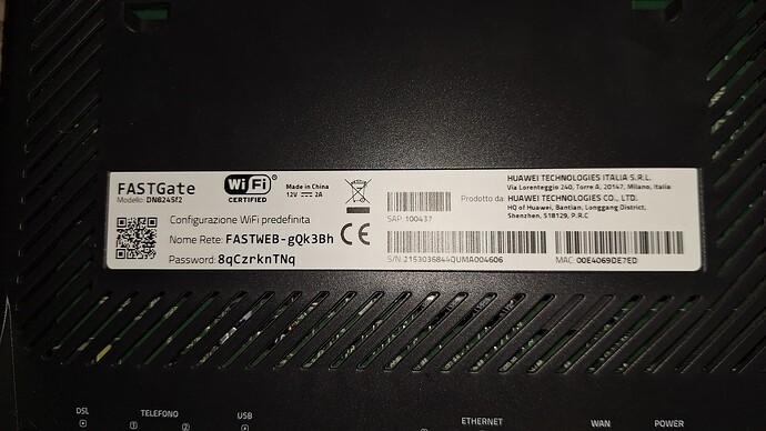

Router model is:
FASTGate
Model: DN8245f2
MyFastweb - FASTGate
Yes I can open the router settings through my internet browser, I can send you screenshots of all the segttings in english if you’d like, so you can tell me what to do.

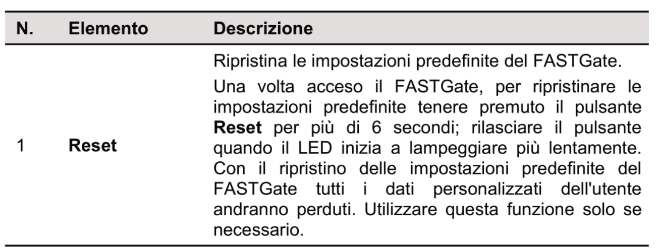

If you haven’t yet, perhaps a factory reset of your router settings may prove helpful in this case - unless you have any custom settings currently enabled.
I’d like to confirm that this issue isn’t being caused by your devices getting confused with dual subnets being active, so the main thing I’d like to try and accomplish would be to eliminate the 192.168.56.1 subnet from your local network as the next test.

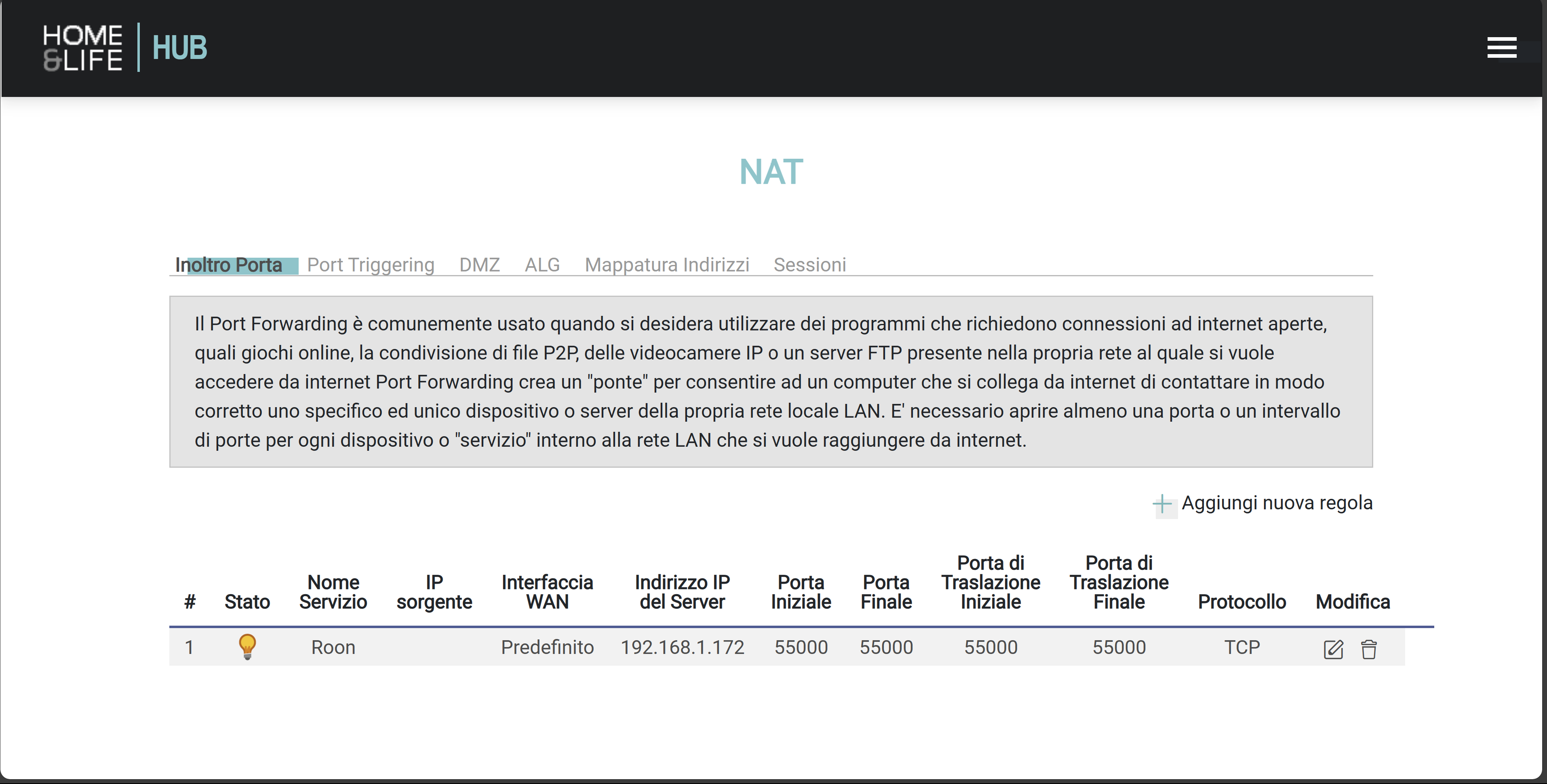

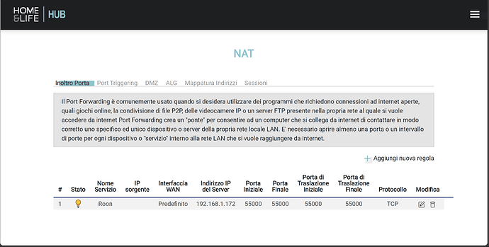

Also, I noticed that in the place I am now for this weekend, in my router settings I had set up roon ARC with the port forwarding infos like this:
While, if you go back to the screenshot I sent you previously of how i set up my port forwarding in my other router, you notice I put different numbers for the ports: could that be the problem? What numbers should I put to to do in the correct way? Do they need to be the same numbers or doesn’t matter? ARC for me works in both routers.

I did a reset of the router, Roon Radio works again now, even from genres, which is great.

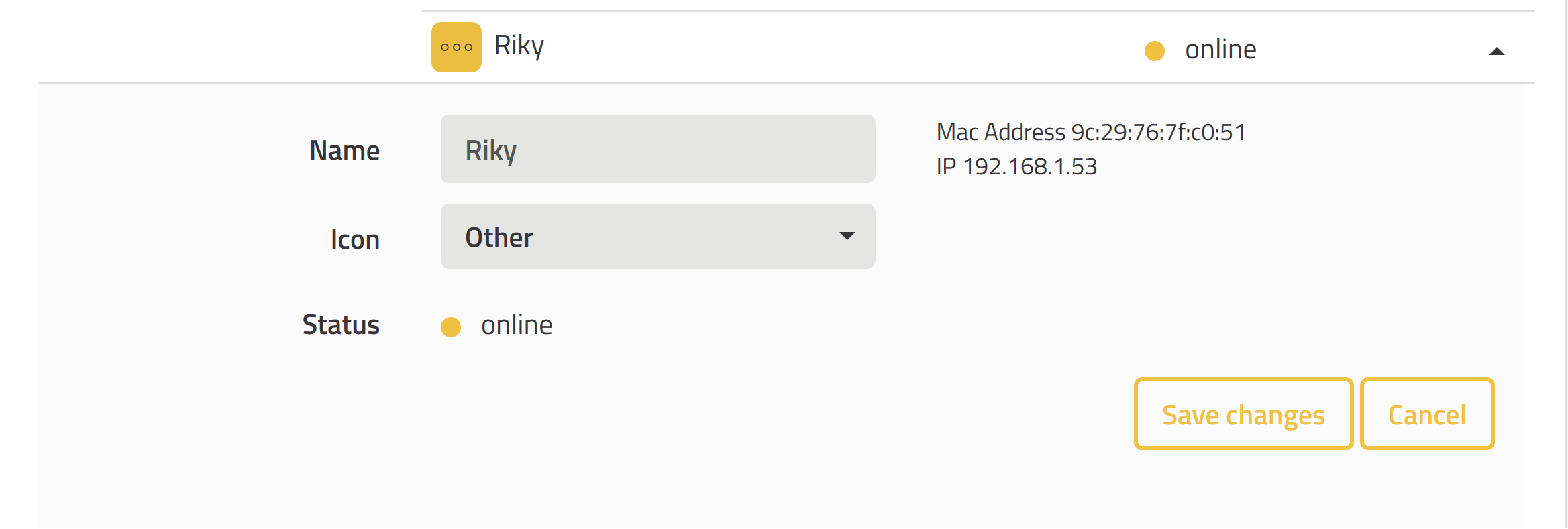

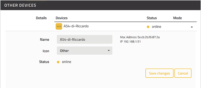

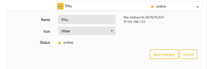

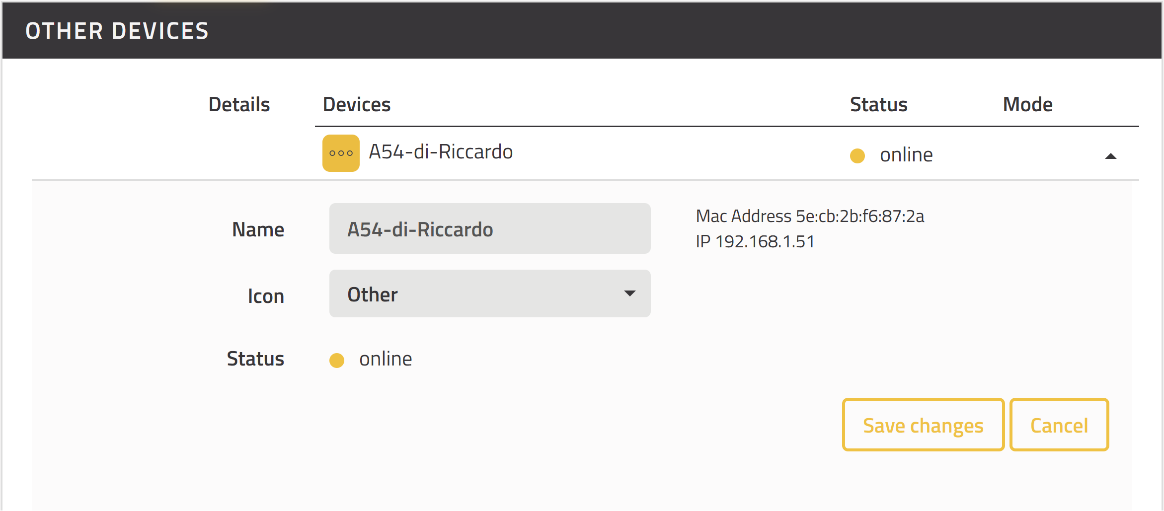

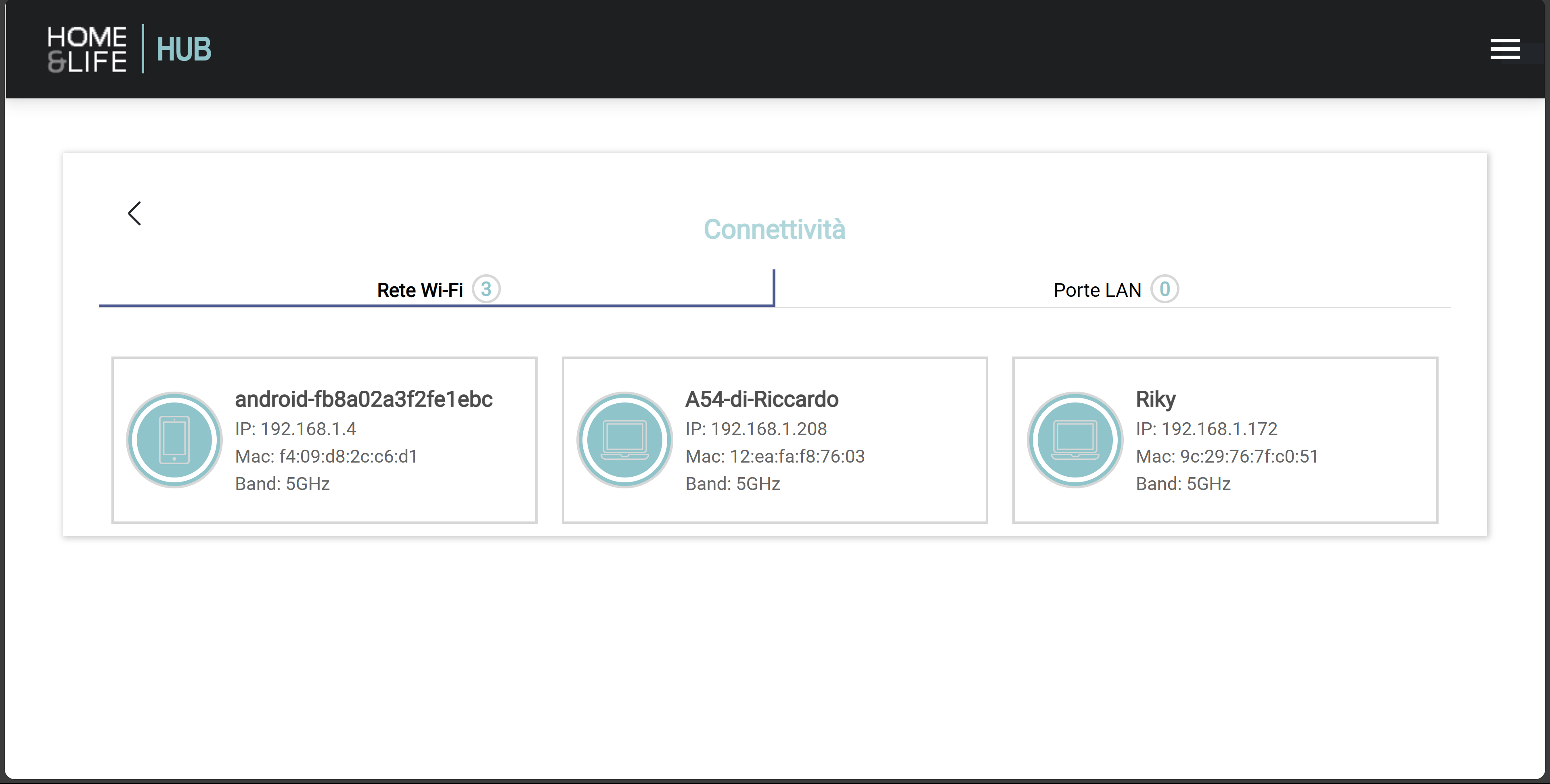

After the router reset, the IP addresses of my laptop and my phone changed and are now these: (as always “Riky” is my laptop and “A54” is my phone)
There are 2 other devices (not related to Roon, so I didn’t screenshot them) from other 2 people in the house connected which have these IP adresses: one 192.168.1.50 and the other 192.168.1.52. So all devices connected to the router’s Wi-Fi have all different IPs and are all in sequence.

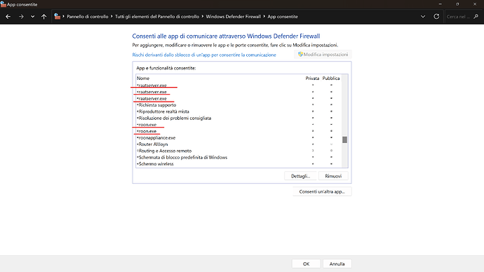

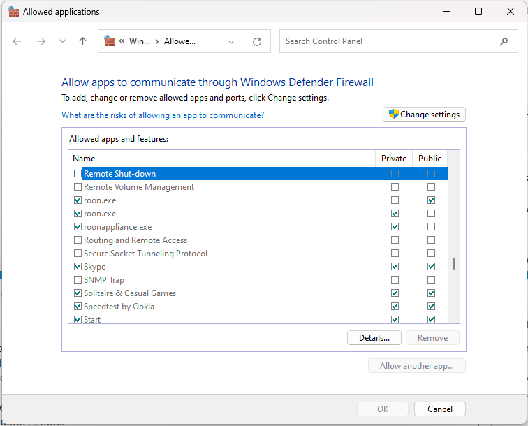

By the way, after the update I checked if all Roon apps were still added as exception to Windows firewall and I noticed that there are 3 raatserver.exe, 2 roon.exe and 1 roonappliance.exe. Is this normal? I’ll attach a screenshot below.
Also before this update, when you asked me to check if roon.exe and raatserver.exe were added as exceptions, also then I noticed I had 2 raatserver.exe and 2 roon.exe. Now there is one more raatserver.exe making them 3.

Please make sure you only have one instance of raatserver.exe, roon.exe and roonappliance.exe within your firewall.

In AppData in windows11 I’m only seeing one folder for each: RAATServer, Roon, RoonGoer, RoonServer.
And in the Windows firewall page where I see those duplicates I can’t find how to get rid of those.

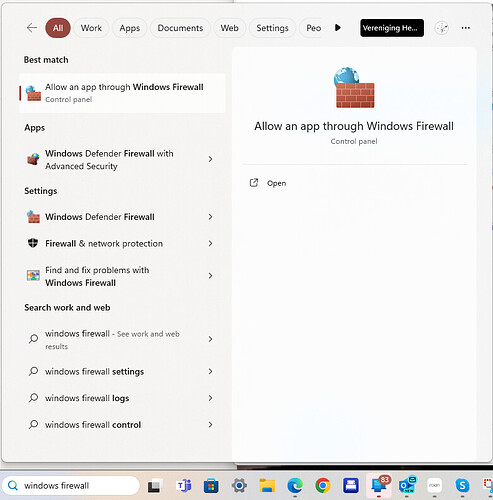

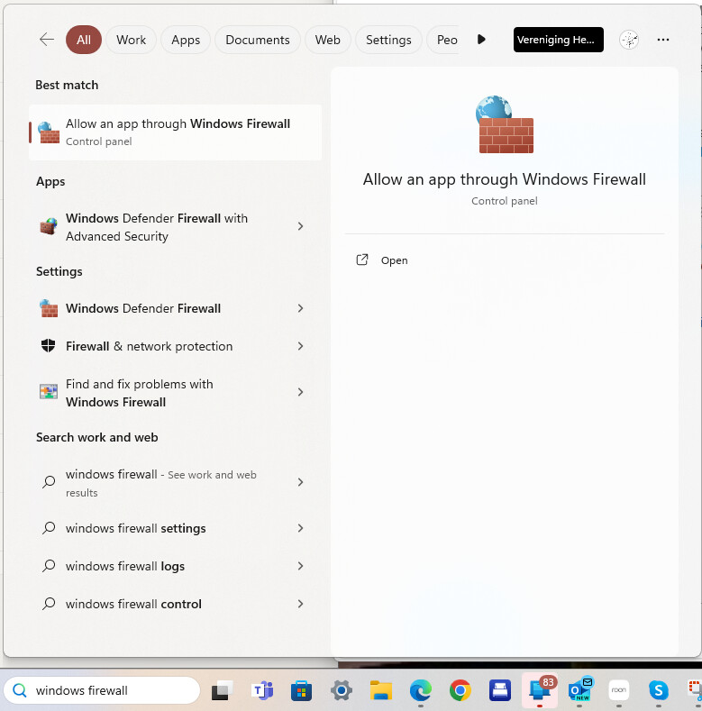

Type in “Windows Firewall” into the Search field of Windows 11 and choose the “Allow an app through Windows Firewall”…
That will show you the list of allowed applications:
You will need to click the “Change settings” button to make changes to the list…
Thank you @Geoff_Coupe! I realised only now that the “remove” button was just there, didn’t even think Benjamin meant simply that :sweat_smile:
