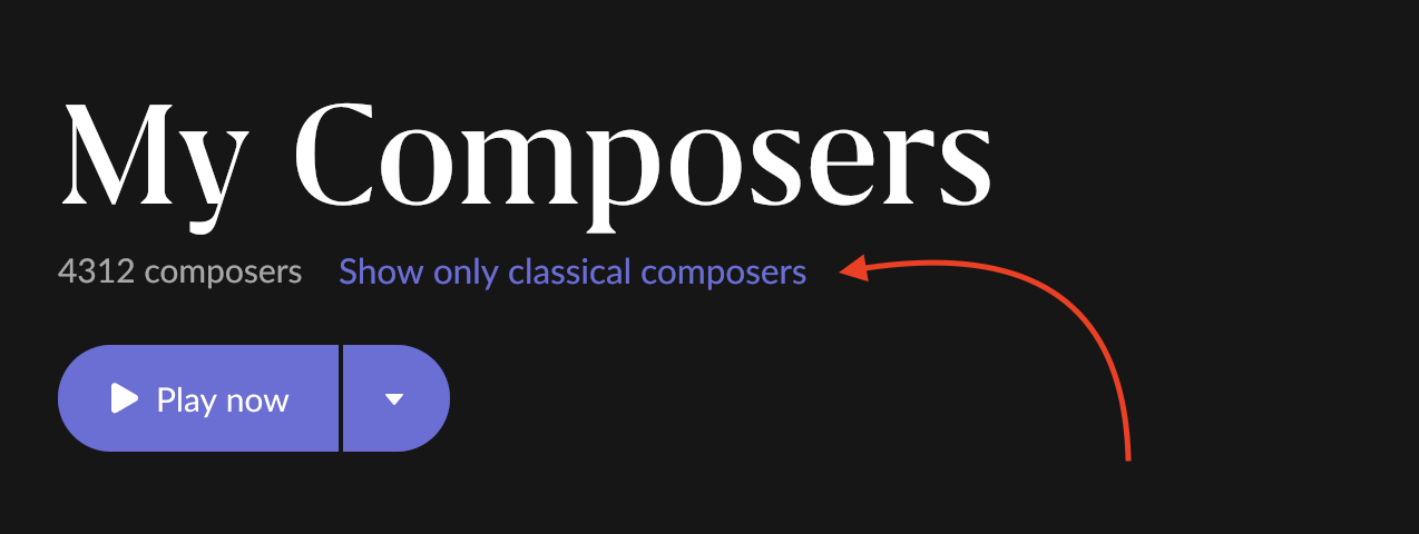

Have you tried using the Show only classical composers filter button?

So edit the composer and set “Is classical composer” to No.

And… yes, if I click on the “Only classical composers” link, the composers list is better by far - although there are still non classical composers in this list and, unsurprisingly, some “classical” composers - mainly contemporary ones - not in the list.
So, as for displaying a consistent list of classical composers, it does the job.
But still, this is only a workaround and half of the describes problem, as far as I can tell, since the “genre” editing remains broken in several cases.
