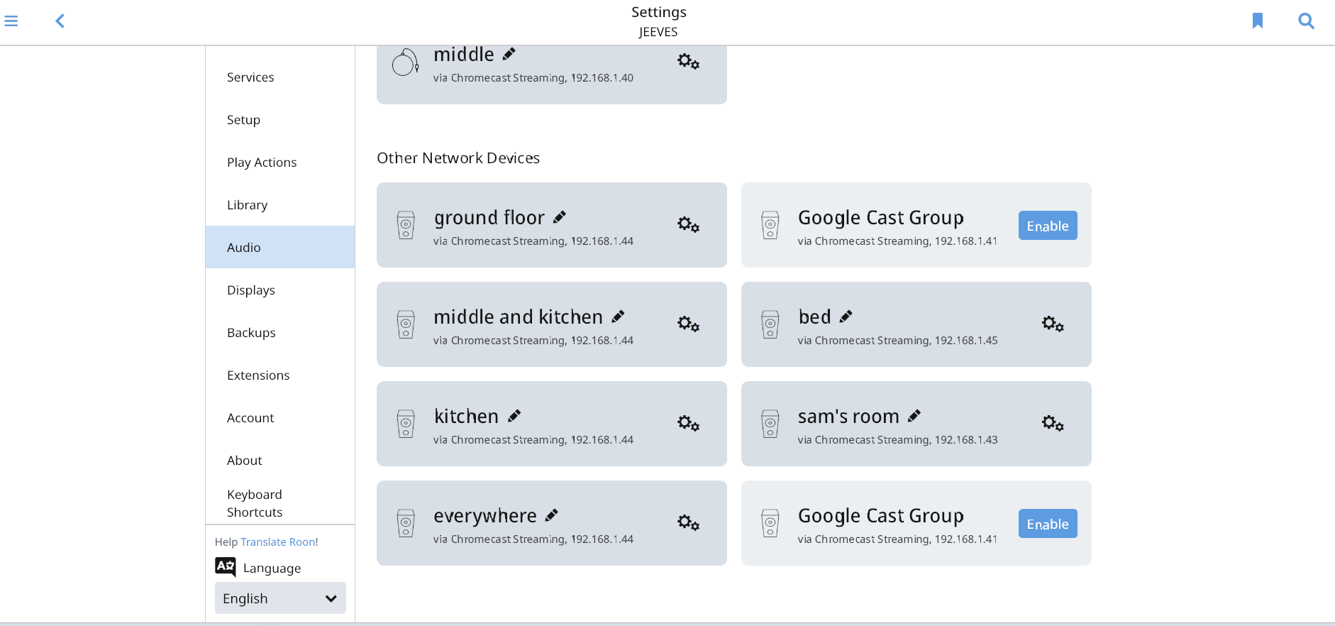

I have some of the CCA and Chromecast inside devices in Chromecast groups. Everything looks fine in the Google Home app, individual devices and groups appearing as should be.
In Roon > Settings > Audio I am getting duplicates of some of the groups appearing. Currently I have 3 groups setup in Google Home, and I have 5 appearing in roon. I have 3 which I enabled in roon shortly after creating the groups in Google Home (again) and at which time only 3 appeared in Settings > Audio. Now when I go to Settings > Audio I have those 3 enabled, AND 2 extra groups asking to be enabled. From the IP address associated with these 2 extra groups, they are the 2 groups which include a CCA attached via a UGreen Ethernet adaptor.
I would suspect it was maybe the UGreen adaptor causing issues, but Google Home app has everything as it should be. Roon does not.
I have experienced this duplication of Google Home groups in roon many times in the past and invariably end up having to delete groups to get roon to forget them, then recreate the groups and re-enable them in roon. I am getting bored of doing this. Any ideas ?

Can you please share a screenshot of your Roon Settings -> Audio tab that displays this behavior?
How are your Chromecast devices configured, are they using DHCP to get a new IP each time the lease expires?
I wonder if there would be any change in behavior if you try setting up a Reserved IP in the router for these devices?

ground floor, middle and kitchen, and everywhere are the 3 groups in Google Home. kitchen, bed, and sam’s room are Chromecast Inside devices. The CCAs are further up the page and not included in the image. As you can see there are also 2 Google Cast Groups wanting to be ebabled. Note that the enabled groups are all identifying as IP 192.168.1.44, which is the address of kitchen. Note also the groups which have not been enabled are both identifying as 192.168.1.41 which is the IP of a CCA attached via UGreen ethernet adaptor to powerline
As regards DHCP, that is being used, but as suggested the devices all have Reserved IPs in the router config.
Oh and that CCA on 192.168.1.41 appears in 2 of the Google Home groups, namely ground floor and everywhere, but not in middle and kitchen, presumably hence the 2 duplicate groups awaiting to be enabled.

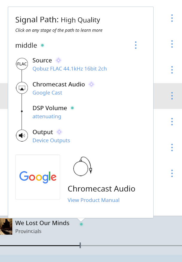

AND while we’re at it, why is it showing DSP volume attenuation when the device is fixed volume on a CCA ?
Roon is just reporting what the CCA is doing here. As you have set the CCA to fixed volume in Roon, you can’t change the CCA’s current volume from within Roon. You have to do it in the Google Home app instead.
That’s OK, but the signal path is showing a DSP Volume attenuation when there isn’t any. The volume is fixed in roon. The CCA is running at 100% volume in Google Home. I use the volume control on the Cyrus 6DAC amp.
EDIT See edit to previous post. On latest viewing Signal path is now showing purples, which is odd as I didn’t change the volume on the CCA in Google Home which was showing 100%, I changed the volume on a group in which this CCA is included. CONFUSED, WILL CHECK FURTHER.
Are you sure? Did you actually check?
While having Roon open and playing, I can actually see in real-time how the text changes from passthrough to attenuating in the signal path when I change volume in the Google Home app.
Hi BlackJack. I am confused as I expected that. Please see notes in edit to prior post and let me check further.

For the Volume Attenuation issue, I would right click the zone name in Roon -> Device Setup -> Set Volume Control to Device Volume -> Exit out of Device Setup -> Set volume manually to the max -> Go back to Device Setup -> Set back to Fixed.
I suspect what happened here is that you had it on Device Volume previously and then changed it to Fixed Volume. Fixed Volume means that you can’t change the Volume though Roon, but if you had it set to something lower previously, fixed volume keeps the previously set volume in place.
As for the Chromecast groups with the same IP - can you share a screenshot of what these groups look like in the Google Home app? When grouping devices, it is expected that only the “master” zone’s IP show up in Roon, which in this case would be your Kitchen zone.
Hi Noris, thanks for the info on Volume Attenuation, that makes sense !

FYI on as of starting roon client just now I am no longer seeing any duplicate groups. Only 3 groups are now displayed, which I did have to re-enable. I changed nothing and had previously restarted both the PC and the roon client (and the roon server) several times without it clearing the duplicates.
Who knows, will keep you updated if duplicates reappear.
Hi @Andy_Foster,
Glad to hear that the duplicates are gone for now. I spoke to the technical team regarding your case and we believe the powerline adapters and your network might be a factor in this behavior.
If this issue occurs again, can you please check to see if rebooting just your networking gear or Chromecast device resolves it?
Generally speaking, we have seen quite a few issues surrounding powerline adapters and always suggest using a “mesh-style” network in place of powerline. If rebooting the router/cast device resolves the duplicates that would be an interesting data point though.
