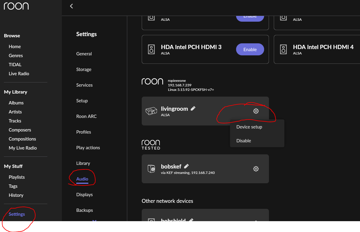

You can access the device setup by either right clicking the zone from the zones icon:
Or going to “settings/audio” and clicking the gear icon next tot he zone:
