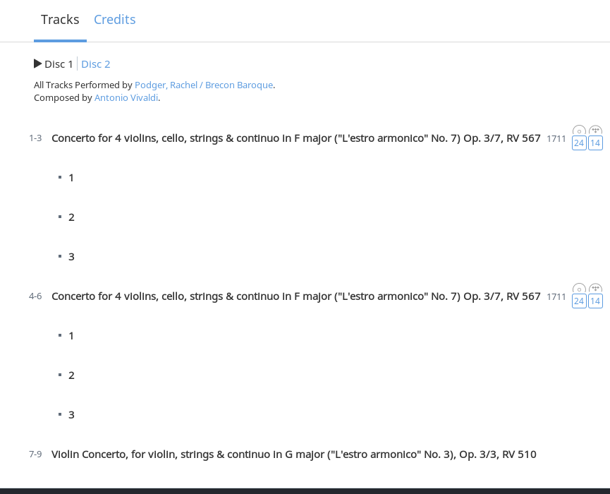

@joel @Ludwig @Klaus_Kammerer1 Thanks for your comments. Like you, I did found problems with the use of the WORK/PART tags on unidentified albums. I decided to spend some time experimenting with the album you referend to in your post (Podger L’Estro Armonico on Channel Classics). I downloaded a DSD version from NativeDSD and identified the album. First three compositions are seen as follows
I was surprised to see the differences in the identifications of the RV 549 composition : german in your case, english in mine. Composition RV 578 however is identified similarly both for you and me.
I then unidentified the album in Roon, and tagged the compositions by setting WORK to the exact same contents as what was shown for the identified album, and setting PART to 1, 2 ,3 on the respective 3 movements of each composition. Now Roon shows the following
Surprise! Note how Roon has become utterly confused with the composition names. We should see the sequence “RV 549”, “RV 578”,“RV 310”. But we rather see sequence “RV 567”, “RV 567” (repeated a second time), “RV 510”. … messed up until the end.
I then tried to assign the album to a composer unknown by Roon, namely “Vivaldi” instead of “Antonio Vivaldi”. After modifying the composer tag accordingly, Roon now shows this
Everything is now in order ! The compositions are correctly named as set by the WORK tags : “RV 549”, “RV 578”, “RV 510”, etc
This clearly indicates that Roon behaves erraticaly about the WORK tags used on unidentified albums. I feel that Roon inherits metadata for a composition by a known composer (either form a different performance of that composition previously loaded in your library or a previous idenification process), and refuses to forget about them even after unidentifying an album… Those metadata appear to become sticky. Assigning the composition to a totally new composer appears to force Roon to clear is memory from those “sticky” associations.
I really hope a cure can be found for this important issue.
