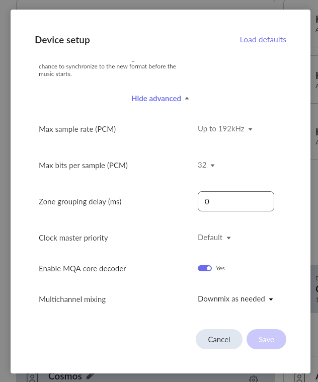

Within Roon, in your device setup (advanced), did you enable ‘MQA core decoder’?
I don’t have it on, but trying to figure out the cause of this unwanted behavior reported in the OP, I turned it on. It didn’t solve the issue.
Why? Is it suppose to solve it?
MQA requires an unaltered stream of audio data. If this signal is changed, an MQA DAC will not accept it as MQA anymore. But for Roon, there is an exception. Roon may alter the signal using its DSP engine and still send it to the DAC as an MQA signal. For this, you have to have the option mentioned above as ‘on’.
Also, you have to tell Roon that your DAC accepts MQA in the first place. So a second option must be enabled in your device setup: MQA capabilities; decoder and renderer.

Turn on the MQA core decoder, and set the streamer to renderer/decoder.
This works here.

Then you need to activate Roons MQA decoder for the device in device settings/advanced it must be active for Roon to process DSP and maintain MQA signalling or it will break MQA if it’s not active and your device needs the correct MQA capabilities set in Roon. In this case set it to be renderer. Roon will then peform the first MQA decode in software. If you have DSP it will preserve the MQA signalling and will be visible in your signal path.
Many DACs won’t show it as MQA as the first decode has been done via Roon and will show ORFs or something similar this just means it’s been decoded before hand and DAC is doing only the MQA rendering process.

After activating MQA core Decoder and setting the R26 as Renderer Only instead of renderer and decoder I am now getting “OFS 192khz” when playing back MQA 192khz. I don’t have a clue what is OFS, but seeing the proper KHz is reassuring.
What is odd is that the SMSL M400 has the core decoder off and it’s set as renderer and decoder and it shows the MQA signal indicator in the screen, with a green dot when it is without DSP and with a red dot when the DSP is on.
Means Original Sample Frequency of master made to make the MQA. As the decode is happening in Roon this is what it will show. If you send a file without DSP to it and set DAC to decoder and renderer it will show as MQA on the DAC as Roon is just passing it through. It really should work setting it to renderer and decoder and activating Roons core decoder, this way if you use DSP it should default to Roons decoder and if not send it through untouched to the DAC to do. Either way its the same as the decode happens in software or in hardware its the same result.
if you dont have roons core decoder active and use DSP then MQA signalling is broken so it wont be working correctly on the SMSL if your using DSP all your getting is undecoded PCM at 44.1/24 or 48/24 and nothing more and the DAC wont see it as MQA. Using any DSP Roon has to perfrom the first decode,
