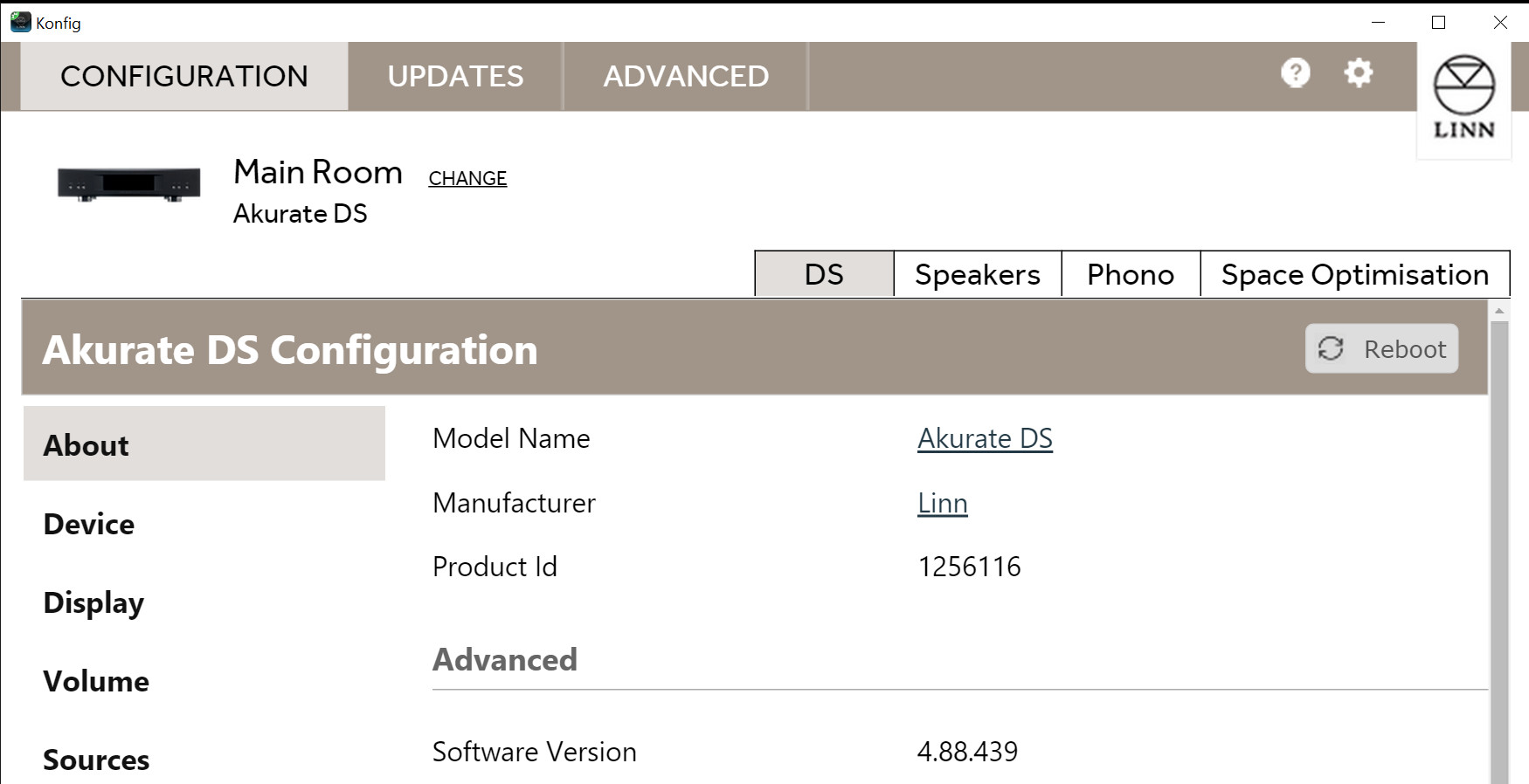

@ Chris_Steurs - I just did a test with my:
It’s working fine. I don’t know if this can be any help to you.
