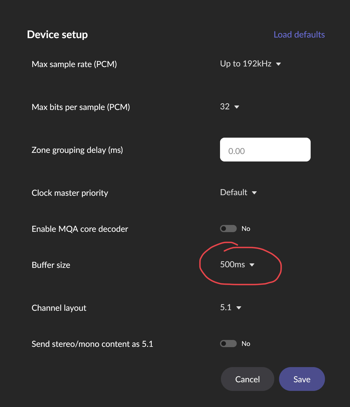

OMG! Today, I got a new DSD64 5.0 file… and it began to stutter
Here you see the signal path.
After fiddling with some parameters in the device setup, I saw it seems to be the buffer size. It was “default”, before I set it to the max (500ms).
I tested this several times playing the same DSD over and over again. 100% reproducible, in my case when switching between default and 500ms.
But…
… if starting with a regular stereo AIFF and continuing with this DSD file, stuttering again. I then set the resync time to 6000ms. And after that, everything seems to be fine again.
