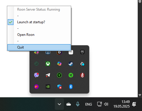

Could you please confirm the current status of your Windows Core? Is it still running?
If it is, please try the following steps:
  1. Right-click the Roon icon in the system tray (the menu near the clock).
  2. Select “Quit” to shut down the core.
After that, try launching Roon on your mobile device and search for your new core.
Let us know how it goes or if you need further assistance!
Yep thats what I did. Yet, when I tried to search automatically from the phone it wouldn’t find it. I have to type in the network address manually, then, it connected instantly.
