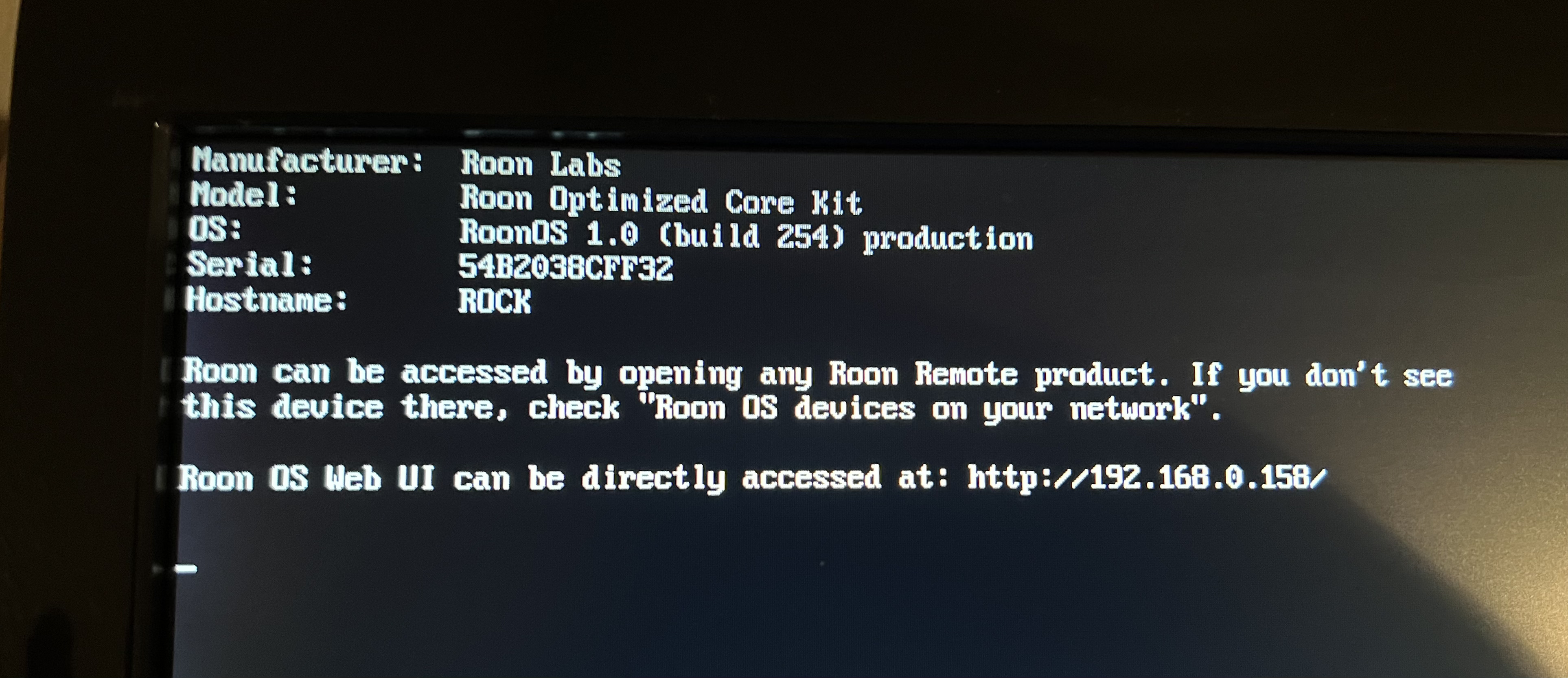

Help needed with Nucleus recovery:
Yes, the keyboard works properly when I boot to the BIOS interface. It’s only when I boot the UEFI USB OS Bootloader that the keyboard is disabled.
I’ve previously tried disconnecting/reconnecting the keyboard and was unsuccessful.
Yes, the cursor is flashing.
Thanks again for all your help!

Sorry, could you take a picture of the underside of the keyboard, the model code is what I’m after. Is the keyboard full USB, rather than an old skool PS2 to USB adaptor? Do you have another keyboard? Sorry but I’m reaching the limit of my ability to help remotely TBH. In truth an alternative USB keyboard is probably your best bet at this point.
Here’s the model code. This keyboard is otherwise perfectly functional. Only when booting from the USB install that it is disabled (but not disconnected from USB power as the number lock light is lit).
Interestingly, I have found reports of this issue on GRUB support forums (keyboard disabled during bootload). This seems like a potentially useful lead, as the GRUB bootloader (as I understand it) is the controlling component during the USB flash install process.

I’m delighted to report, a new keyboard was the solution to the disabled keyboard install issue!
Thank you, Killdozer for staying with me and providing the necessary advice and suggestion.
I’m up and running and am ready for the Nucleus OS replacement.
Thank you so much for all your assistance. A new $10 keyboard was the solution to the install issue!
Paging @Wes
This is all good to hear @brad_thompson you got pretty unlucky as both of these were pretty niche issues. It appears there’s something non-standard about that keyboard and it lacks GRUB boot support.
