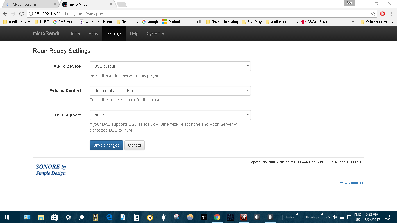

Does the IDSD sound loud through other players music players (DB poweramp)? Am I right in understanding you are using the microrendu, I can look at that setup too, later on.
Mat
Just checked the iDSD manual and the eco mode is the one you need to use, the other 2 modes apply additional gain.
Thanks again…ok so back to eco mode it is…yes also using microrendu, volume is maxed thru it
