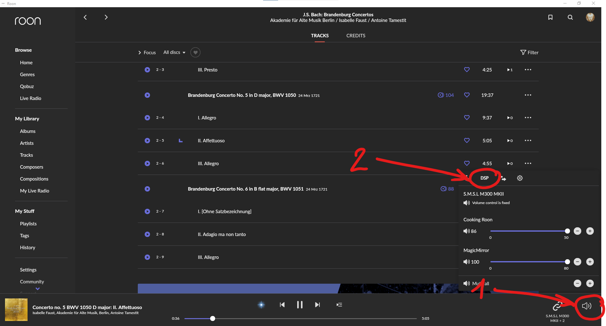

I suggest to start with something like the following, and then play with the settings for frequency, gain and Q.
Obviously, frequency changes where the dip is centered, gain by how much and Q how wide a range is affected.
Just play with it, can’t really damage anything with it…

Just follow the steps below…

Played about with this quite a bit last night and for me to remove the sibilance I had to set it to -8.
It definitely worked but it feels like a little bit of detail lost.

In your example above you have headroom management and sample rate conversion enabled…I am not sure what they do or what difference they make as I did not do this on mine.

change frequency and play with Q to zoom in on the needed center frequency and affect a narrower frequency range, maybe.
they are of no importance for your case, I had just quickly set and numbered what’s important for you, so please ignore.
And don’t forget, what I suggested is a rough starting point.
I can’t possibly know what your setup sounds like and what you’re hearing…
Good luck!
