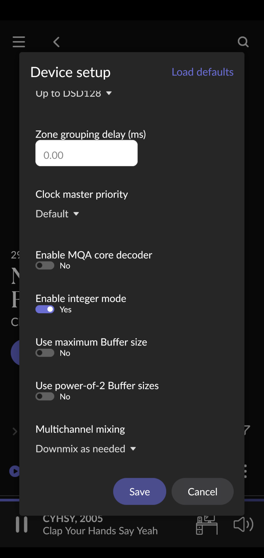

Description Of Issue
The Mac running latest Roon sees my R5 in settings and it’s enabled but Roon does not show it as a Zone. If I reboot core it reappears but if I change one setting in the audio settings it drops off again and won’t reappear. Was also getting skipping on playback which never happend on 1.7 which is why I was in audio setting
Its all setup correctly as far as I know works for everything else on the Mac. It worked fine on 1.7.
