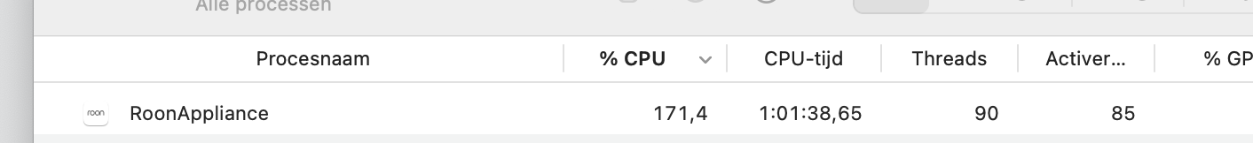

The problem occurs when reindexing the database of my tracks witch is a bit too big (368,214 tracks) and Roonserver starts to do this process regularly and i don’t know what triggers it.
The result is that Roonserver is using a lot of the processors. The only way to stop this is stop the app of Roonserver and restart the app. The server(machine) is dedicated to only Roon.

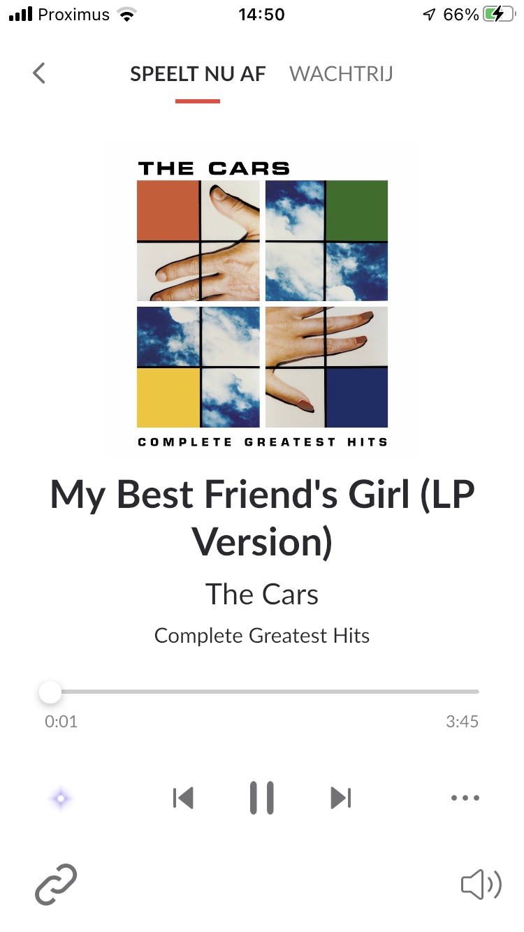

Hello,
Installed the latest version of Roon: version 2 build 1359 on server & laptop.
At first no problem with server but then as of Jan 20th 2024 around 14:50 Local Belgian time the problem restarted and doesn’t go away.
It is not with a specifically song. With hires-music Roon
doesn’t get through the first 10 seconds.
Also the bulk erase with Qobuz doesn’t work.
Very annoying.
I have to look for an alternative for Roon.
I cannot give demos with this problem on Roon.

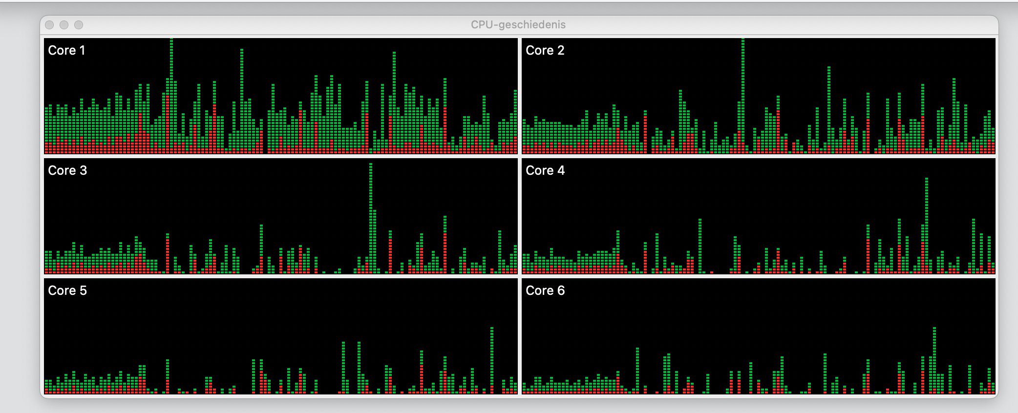

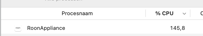

Why is my server using so much processortime.
Roon was not doing this in the past.
This is not just playing a bit of music.

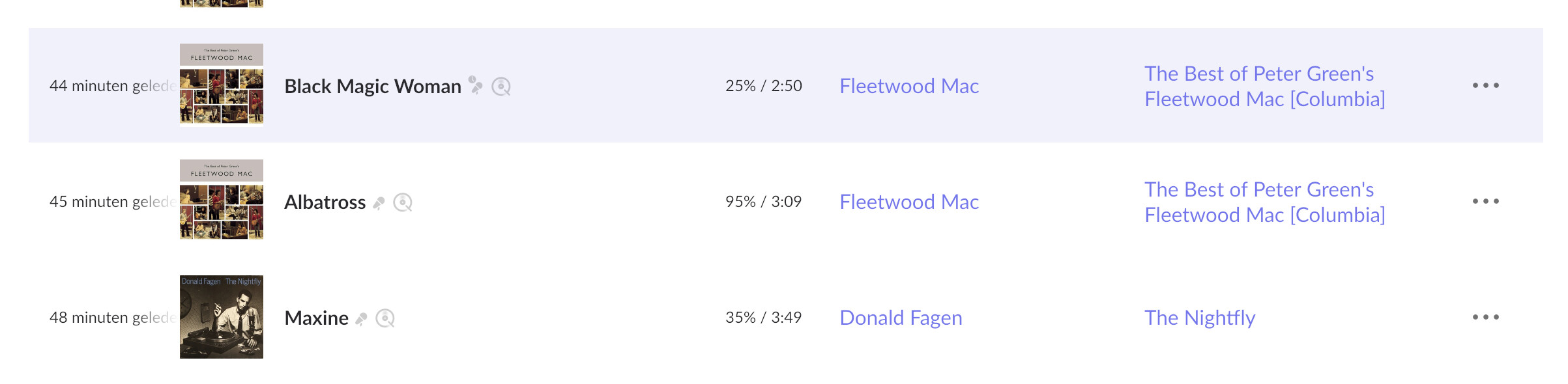

The hiccups started again after some days.
It started with the song Maxime of Donald Fagan around 12:50 CET on 29 jan 24.
See screenshots.
What is this server doing behind my back?
