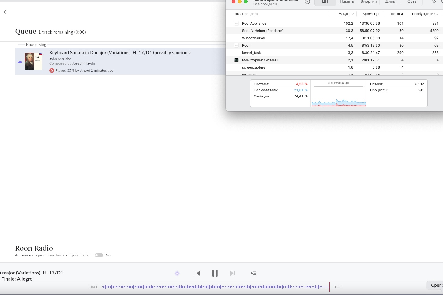

Hi! In the meantime I tried disabling KEF KSX audiozone and playing to other devices (WiiM Pro Plus @ same network router as KEF and local SMSL USB DAC). As before, none of them exhibited this high CPU bug at the end of the queue. I also updated to the very latest ROON build and enabled KEF LSX zone. – All the same - hight CPU hogged by Roon Appliance at the end of the last track of the queue. I am attaching a screenshot with local time and album track where it happened today. (never mind the VPN icon - its on the ROON remote iPad, none is active on the core, and enabling/disabling it on the remote didn’t change anything)
Add images
Hi @Alpo ,
Thanks for sharing that screenshot and letting us know when the issue occurred. We have a development ticket in related to this behavior and we are investigating this issue. I can’t comment on a timeline of when it will be complete, but once the changes are released, I would be curious to know if it helps with your case. Please be on the lookout for improvements in future Roon release(s). Thanks!
