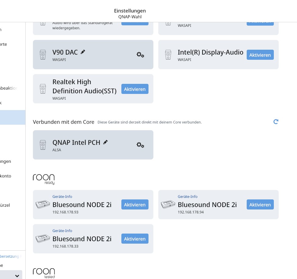

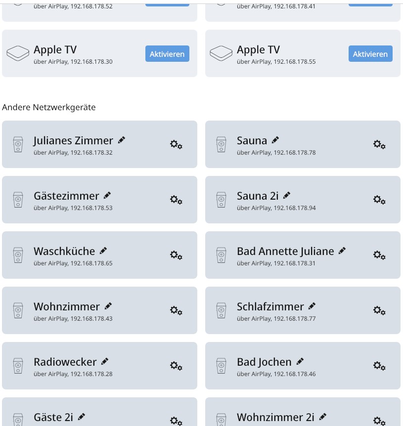

Although Bluesound is marked a Roon Ready device all 3 in the home network are detected only as “other network devices” connected via AirPlay. The Streamers being HighRes capable I would expect a connection that has higher Res than Airplay as else I loose quality streaming via Roon vs streaming directly thru BluOS.

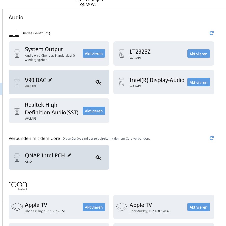

Welcome to the forum! Can you please share a screenshot of your Roon Settings -> Audio tab?
What kind of router are you using? Sometimes specific brands of routers need special settings applied to them, as mentioned in our Networking Best Practices Guide.
So as you can see the Node 2i’s do appear only as airplay device. It is connected to the QNAP thru Eithernet as follows: I have connected to both drives of the QNAP involved - the one with the music and the one with the server
