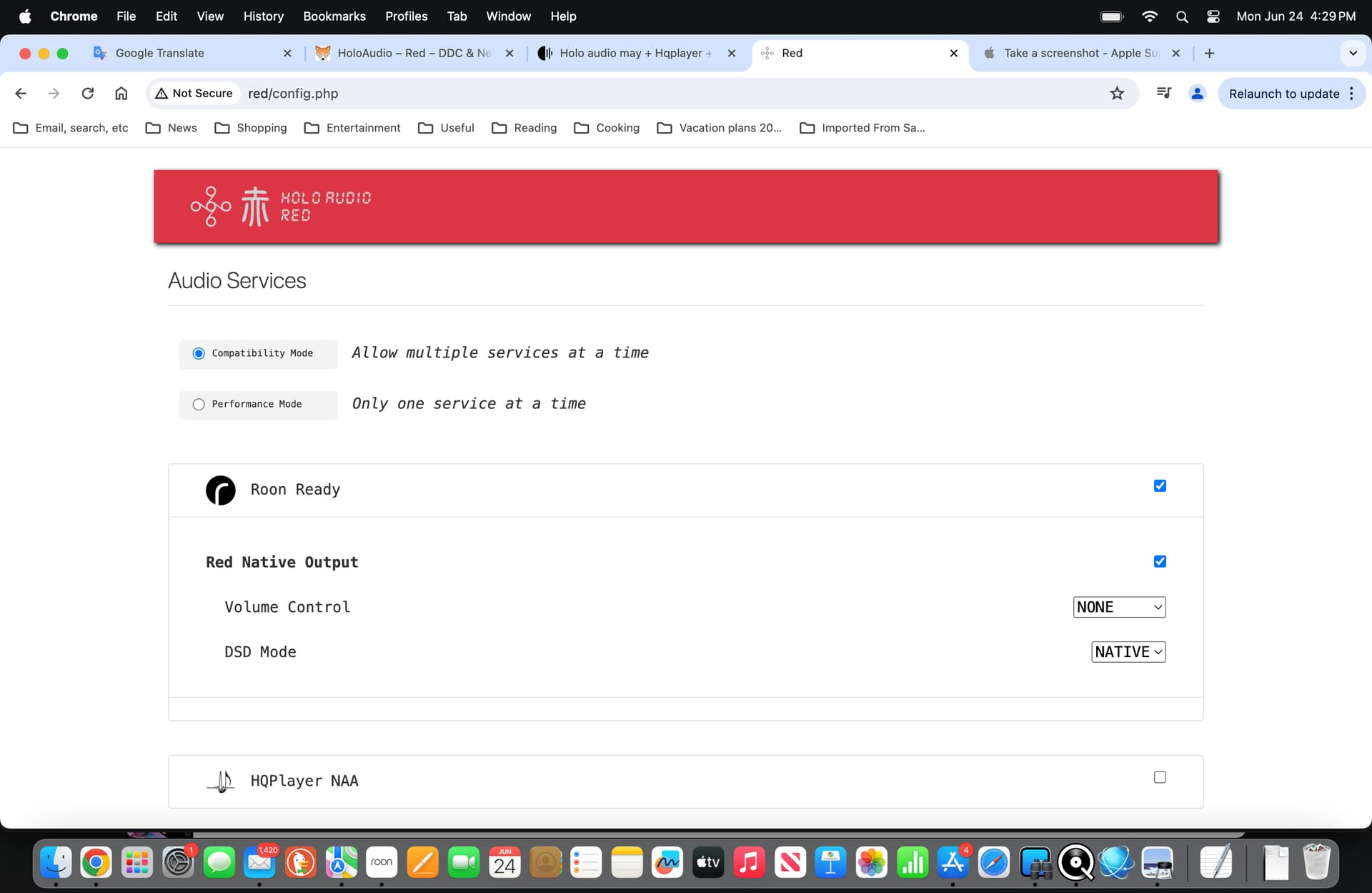

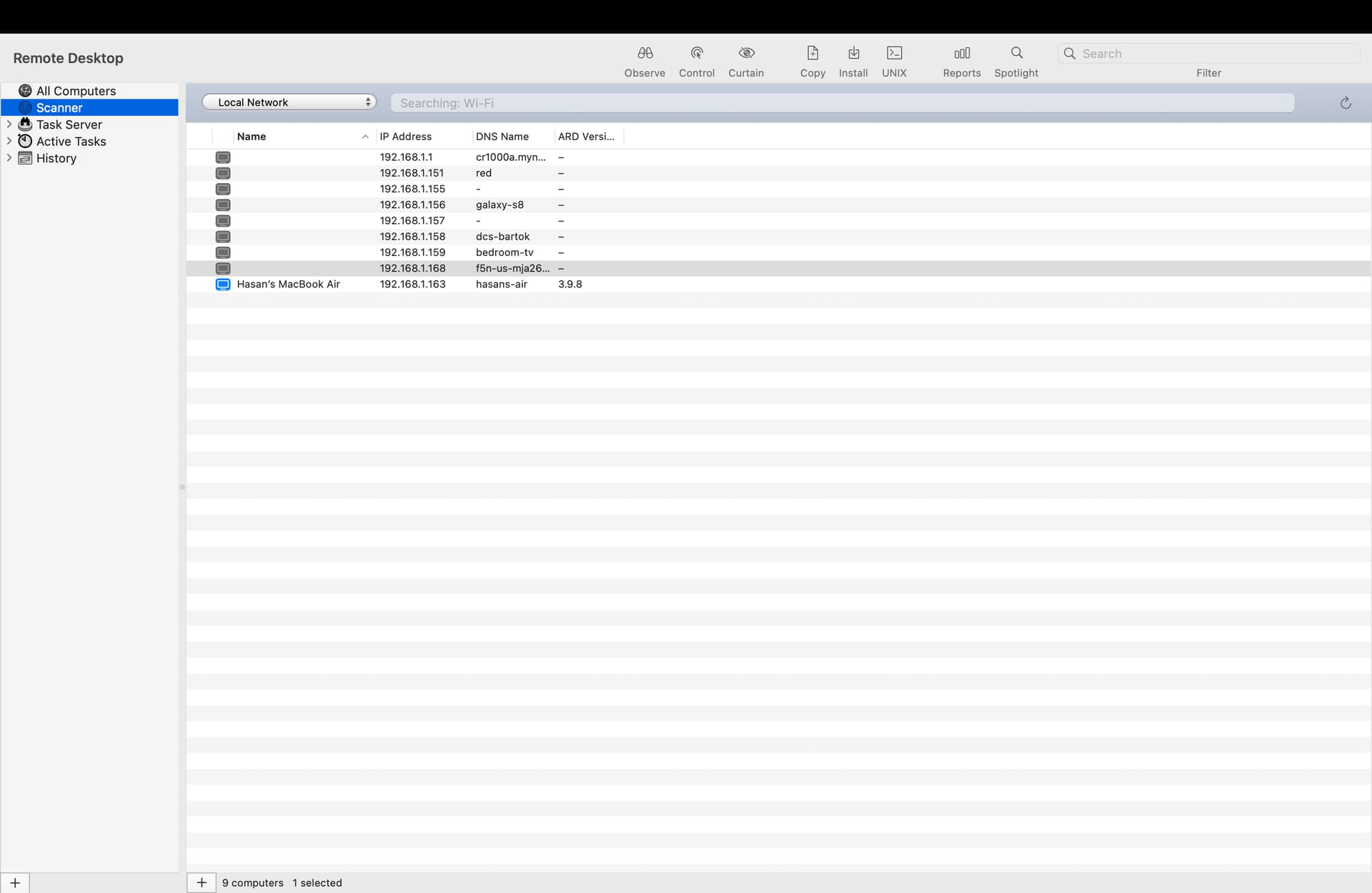

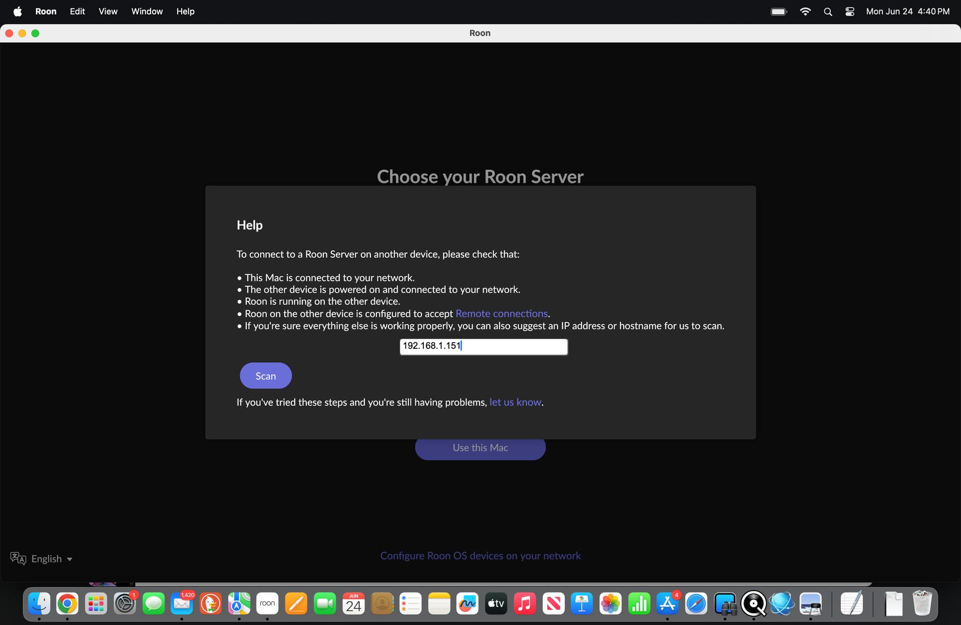

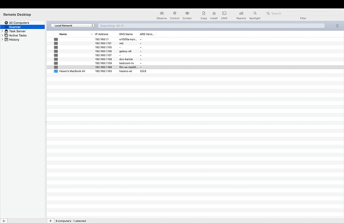

The problem is that the Roon Control software on my Macbook Air does not see the Red automatically. Roon does not even find it after I provide the IP address for the Red which I have located through my Macbook Remote software as having the IP address of 192.168.1.151. I have also been able to access the Holo Red OS via a Chrome browser on my Macbook Air. Attached is a screenshot of the Red OS page from the Mac Chrome browser.
It looks like the Holo Red is Roon Ready and you have this enabled on the Red OS web page. Does it not show up in Roon > Settings > Audio, in the Roon Ready section? You should be able to enable it there as an output device, and then you should be able to choose it as an output zone.

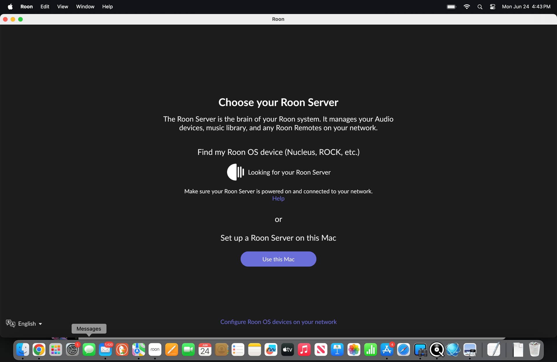

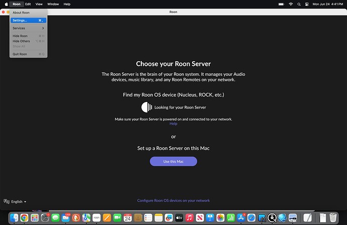

Well, this is a different problem. You are not able to get to the Roon settings because you are not even able to connect to your Roon Server, i.e., the Nucleus. You have to solve this before thinking about Roon finding the Holo.

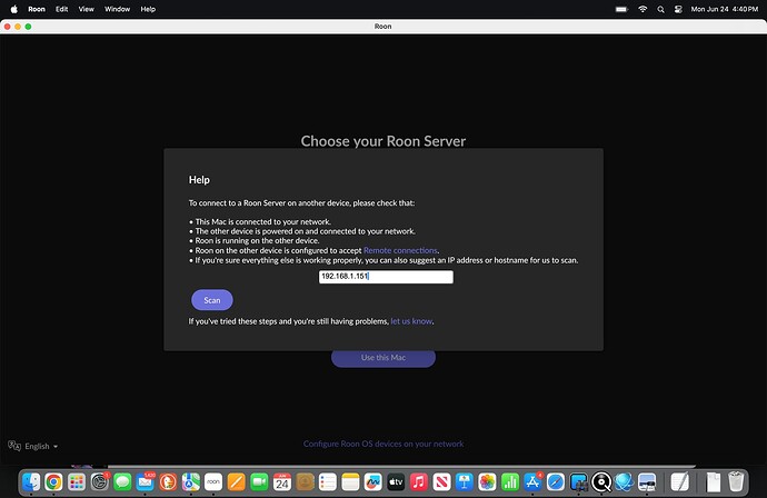

I am not sure if this inability to connect to the Nucleus is caused by you entering the Holo’s IP address, 192.168.1.151, as the address of the Nucleus in the last screenshot, or if this misguided attempt to solve the problem was simply caused by the failing connection to the Nucleus. The Holo is not your Roon Server, the Nucleus is - and normally it should be found automatically when you open Roon on the Mac, without having to enter its IP address.
Did the Nucleus work so far and did the Macbook always connect to it automatically, as it should?

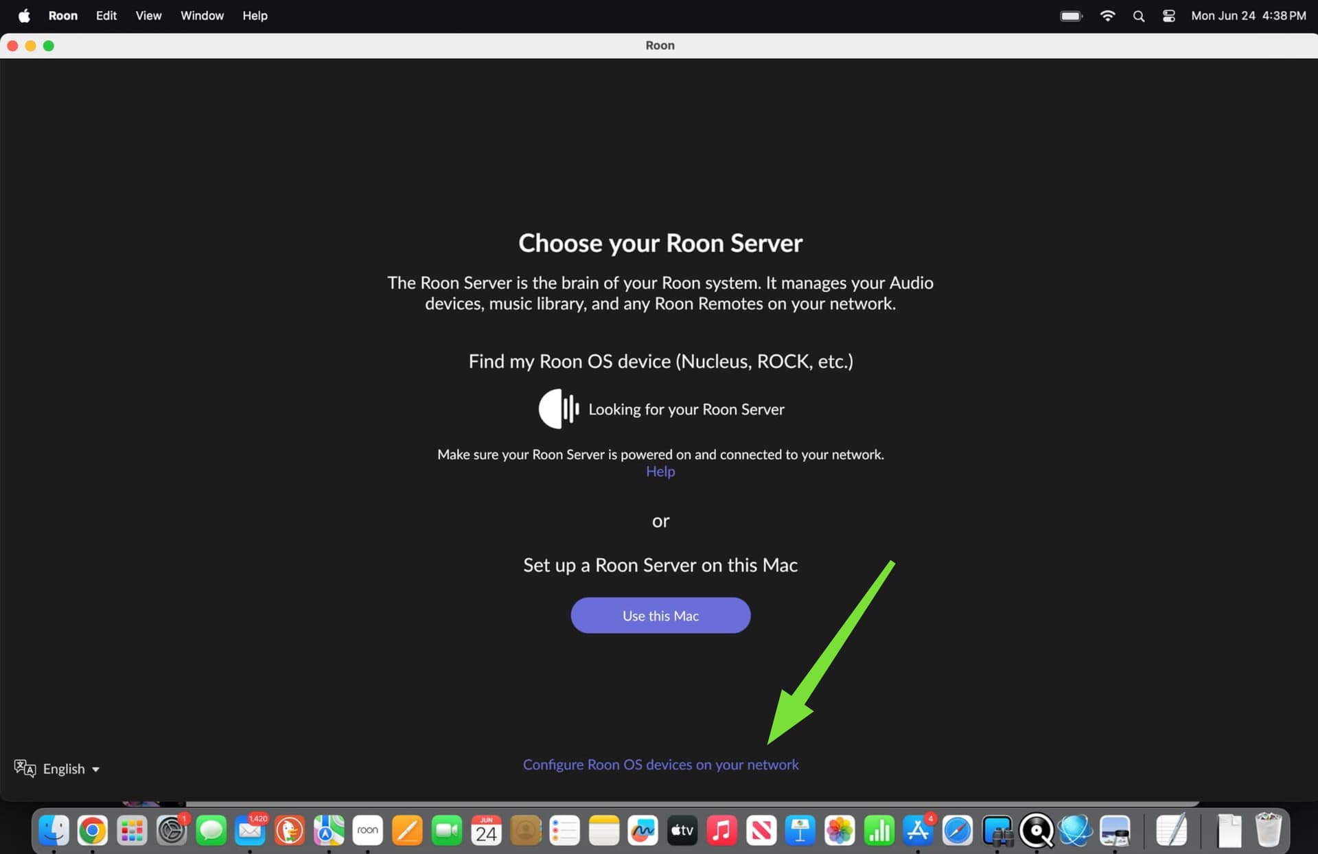

What happens if you click “Configure Roon OS devices on your network”? It should open a web brower with the web admin page of the Nucleus:

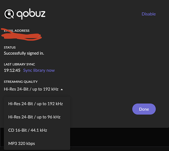

BI do have another question/issue. Perhaps someone has an answer to that. I play much of my music from Qobuz. Some of that is 16/44, while a bunch is not. Is there any way that I can direct Roon to downsample everything to 16/44 PCM as that is all that my Pass Labs D1 DAC can handle? It cannot handle hi-res Qobuz files.
I have been trying to play with the Red settings and I cannot find any way of downsampling there.

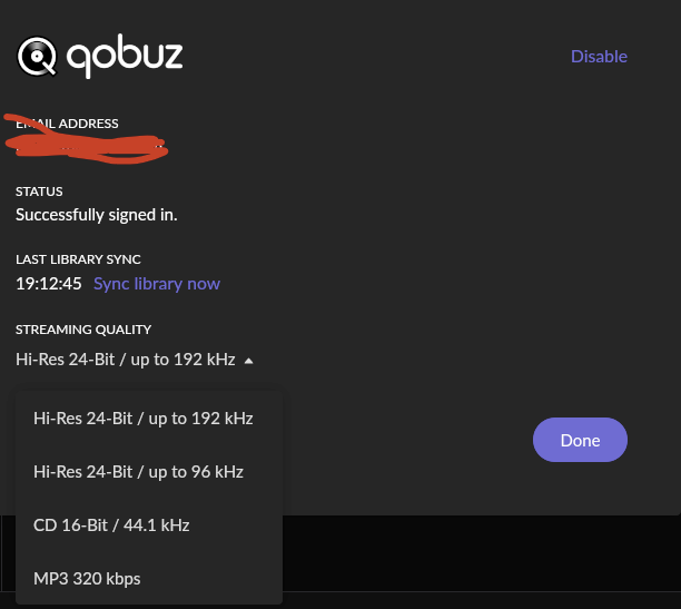

Maybe I can change a setting in Qobuz if not in Roon?
set this to 16/44.1 and you’re set. This does have the disadvantage of forcing CD resolution for anything you play in Roon from Qobuz, even if you get another DAC that does support higher rates.

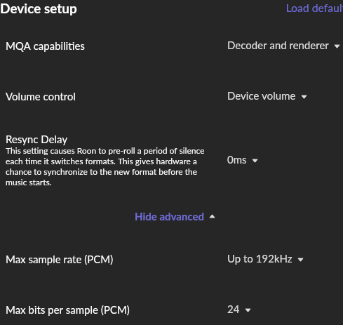

Alternatively, configure your Red/Pass zone in Roon and set the Max Sample Rate and bits to what Pass will handle:
