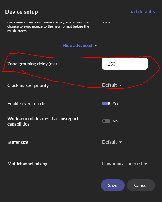

Not sure if you have tried this, but I used the “zone grouping delay (ms)” in advanced area of the “device setup” to adjust two of my zones that were out of sync. As you can see below, I ended up about -150 ms (that’s minus 150 milliseconds) delay for the one zone that was lagging behind.
If you are lucky, all the zones might be out of sync by the same amount? If not, trying to sync five or more zones might take some time.
One tip is to find an “audio sync tone” (like a repeating clap or pong tone) and turn up the volume a little high to be able to hear it well.
Hope this helps.
Thanks for the good suggestion; this indeed works with fully RAAT but as the HomePod Minis rely on AirPlay 2 for multiroom that option does not show on any device as both streaming protocols can’t be combined - to my knowledge
