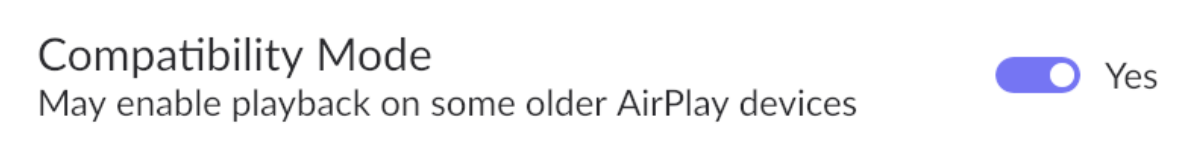

Have you tried to toggle the compatibility mode in the settings of the HomePods in Roon ?
If not please try to toggle this mode and try again.
Let us know please whether it makes any effect.
Regards.
Hi Alex,
Both are in compatibility mode, but unfortunately it hasn’t solved the problem.
