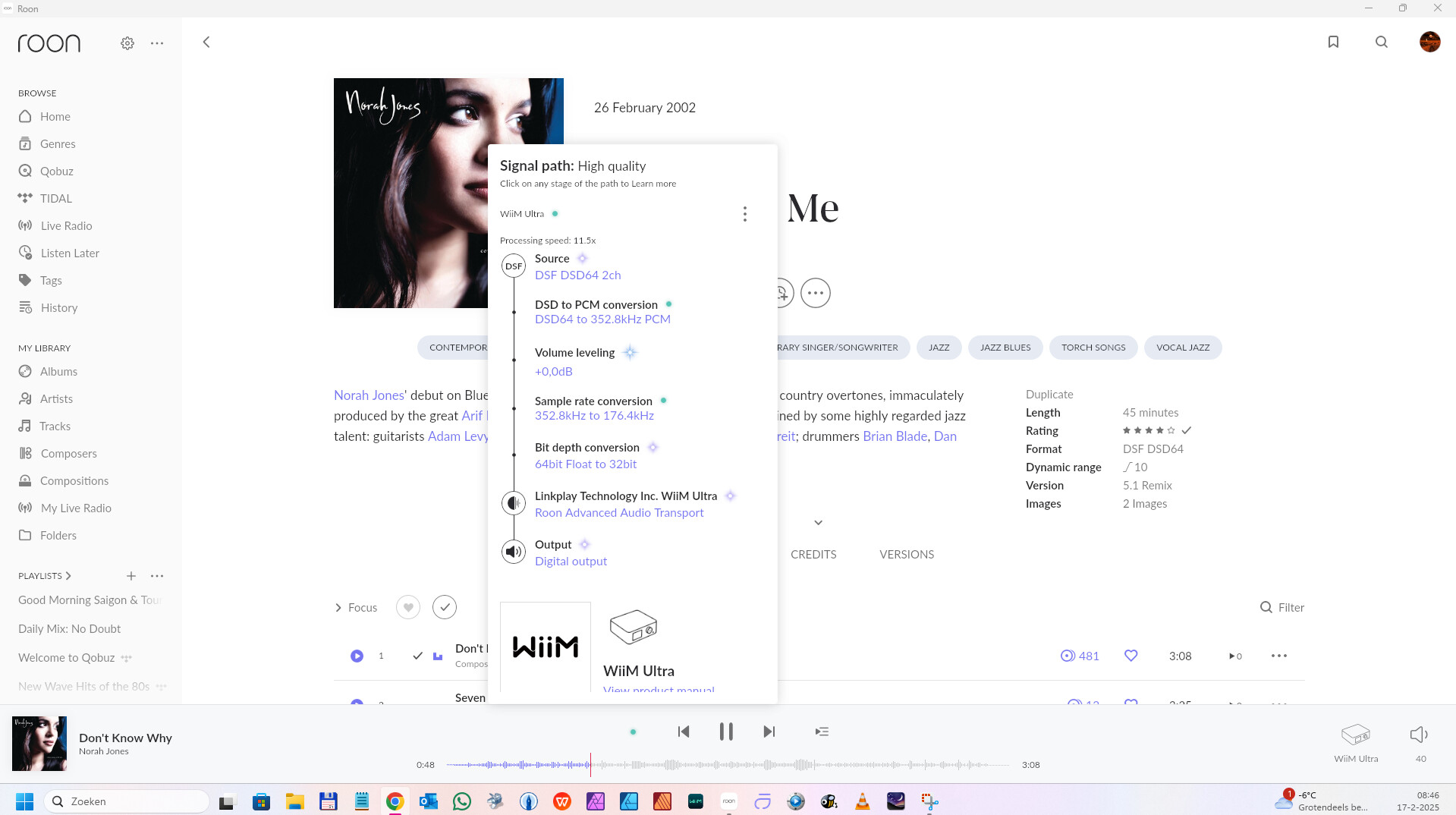

Heya,
I would like to add that when you’re at home you should be using the normal Roon app. And make sure you are using the Roon Ready WiiM Ultra from Roon’s Audio settings.
This will ensure that Roon uses all the WiiM’s capabilities. As it happily plays 24/192 this way. Or even DSD as in this example of my own WiiM Ultra.
