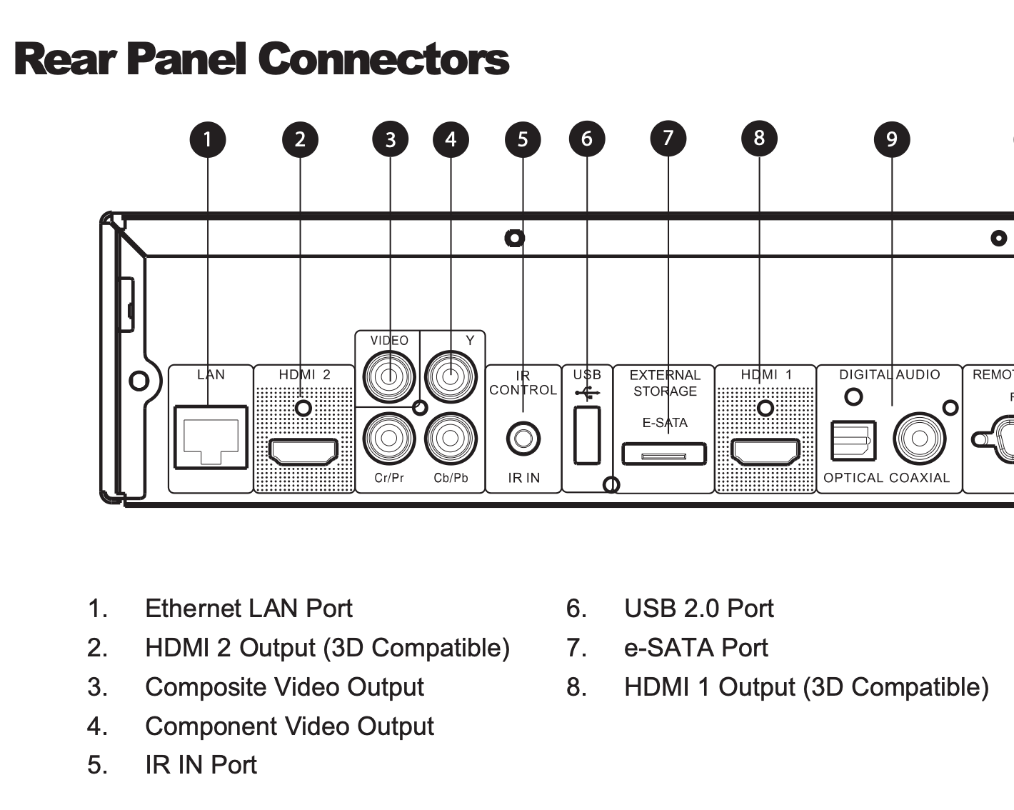

How can connect these two devices to each other?
I have an older Oppo DVD player that I no longer use. Because it has SACD capability, I’d like to be able to connect it to my audio system.
My core is a Nucleus and I’m thinking that it may accept the output from the Oppo, but I’m not sure how it should be connected. The HDMI ports on both units are labeled as outputs. There is a USB 2.0 port on the Oppo but I’m not sure if it’s an input or an output.
I’m posting images of both rear panels in the hopes that someone here can tell me if and how these units can be connected to one another.
Nucleus:
Oppo BDP-93:
Thanks for any help you can give me!
The USB ports are for playback from attached drives, not music servers. I don’t see any inputs on the OPPO or any way for it to connect to the Nucleus. The newer models have inputs to allow it to be used as a pre-amp, this one doesn’t.
