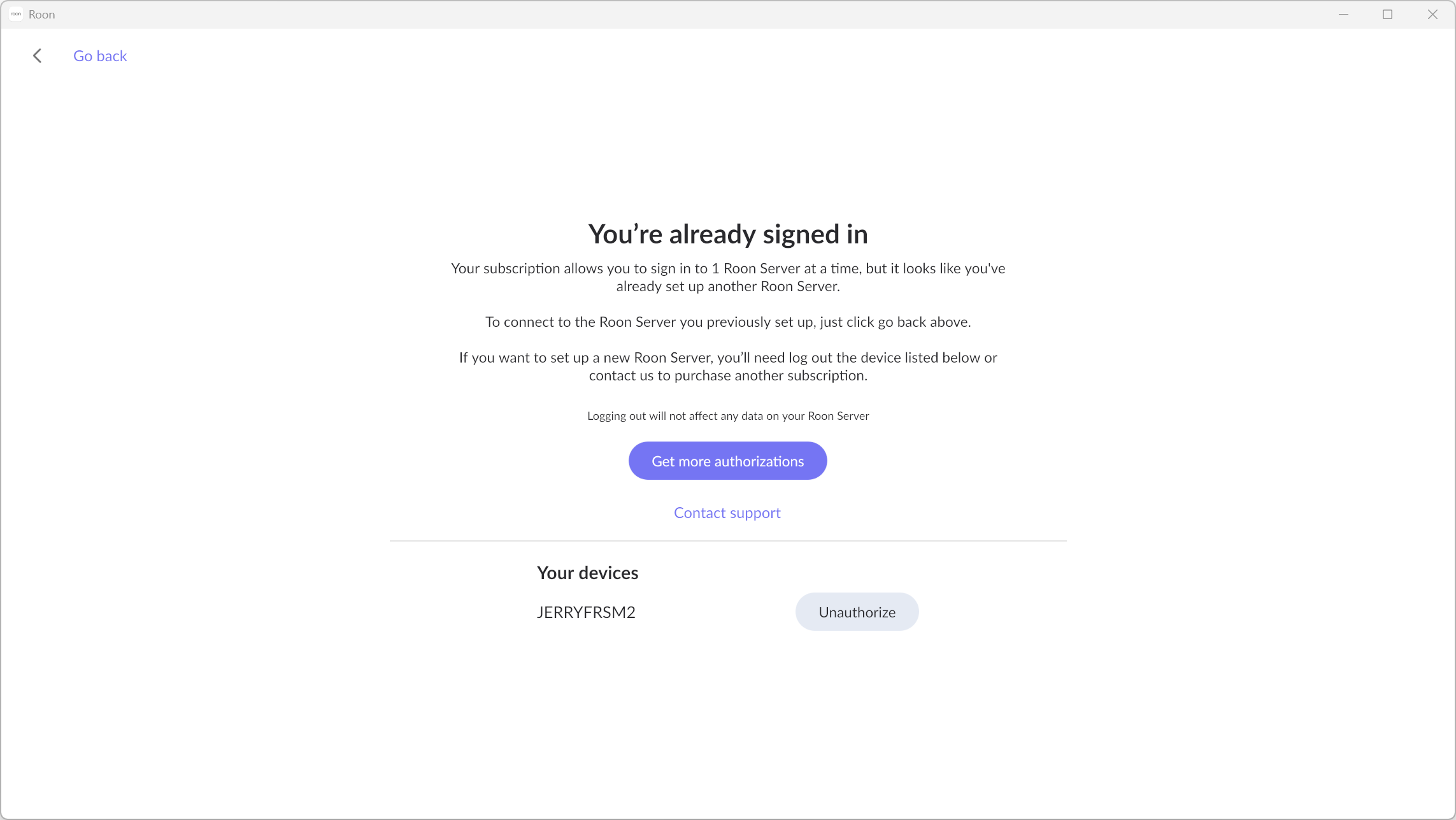

So when you press “Connect” on the second one, what happens?
a long wait like snapshot 1
shot 1
and then informed me I have to unauthorize the original server. But another long wait after I clicked the ‘unauthorize’ button like snapshot 2
shot 2
In the end, nothing change that I can only do everything above again but nothing happened again.

Hi @Jerry_Wu,
Let’s zoom out and confirm your intentions in adding a second RoonServer.
Are you trying to migrate your existing Roon database to a new machine? If so, please be sure to follow the steps in this guide, in addition to the Synology-specific steps shared above:
This will prevent overlapping database instances from interfering with controller and ARC connectivity.
Do you have a Backup of your current database? If so, fully remove the Roon database on the PC by deleting the RoonServer folder:
  • Make sure the RoonServer instance on the Synology is online
  • Exit out of RoonServer on the PC
  • Navigate to your RoonServer’s Database Location on the PC
  • Find the folder that says “RoonServer”
  • Rename the “RoonServer” folder to “RoonServer_old” or delete it entirely
  • Reinstall the Roon App from our Downloads Page on the PC
  • Open Roon and press “Use another Roon Server” and connect to the NAS Server
Please let us know if this helps.
