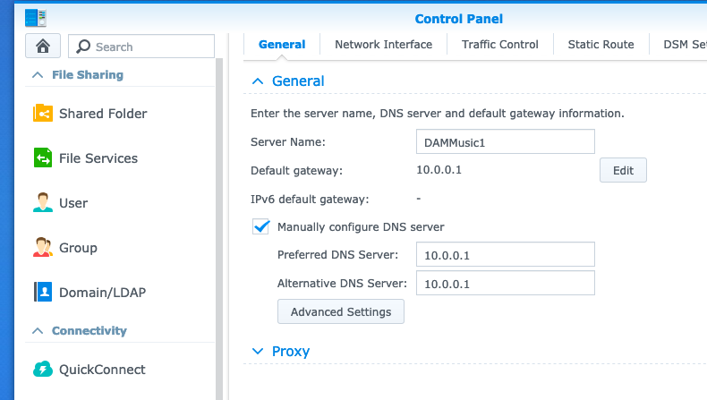

And here is the NAS network setting info:
Tried the 10.0.0.1 Gateway, but no success.

You need to remove the DAMMusic1 bit too…just the smb://IPADDRESS/music and music is case sensitive plus you will need to an applicable user name and password with read permissions for that music share
Note also that you should be using a fixed IP address assigned in the router DHCP table if you use IP address share, and or if its in the non DHCP range fix it in the NAS network settings too.
Changed the smb setting per your suggestion and got the connection! Thank you.
