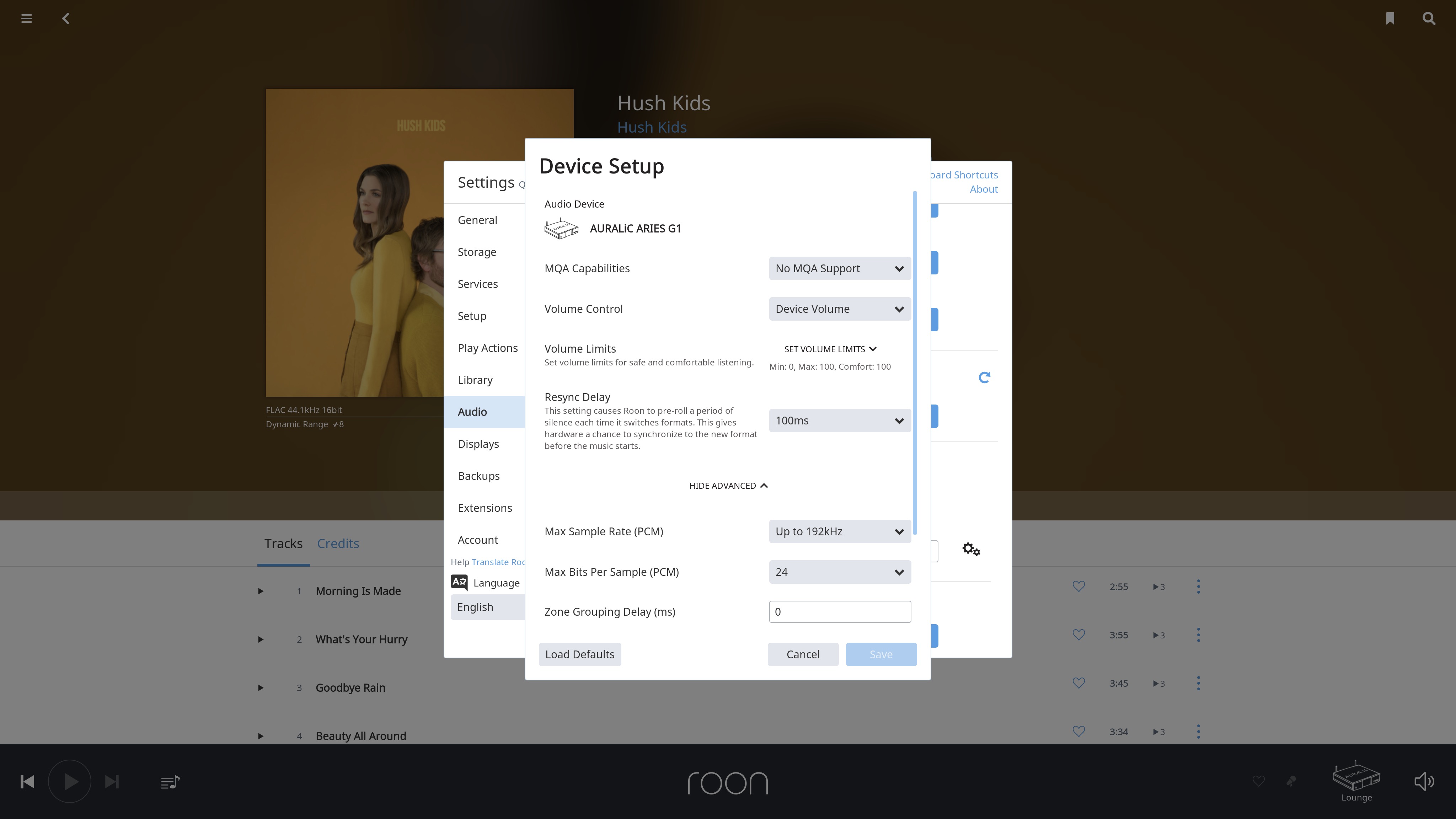

I wondered if there was a way of getting Roon to remove all traces of my G1 so I could add it again as a new endpoint in the hope of resolving the issue? Disabling it and Enabling does not work - the device is still technically there, changing the IP address does not present it as a new endpoint either.

Thank you for the suggestion. I don’t have the option in the Aries settings to enable DoP playback
If I move the DSD to PCM slider then Roon does send DSD direct to the Aries, however as there is no PCM conversion being performed by the Aries there is no sound as my speakers are not DSD capable.
In addition the DSD playback strategy still does not appear in the device setup page

Currently, it is not possible to use the AURALiC ARIES G1’s DSD to PCM resampling feature when streaming to the device using Roon Ready playback. As you have noticed, enabling the Convert DSD to PCM option causes Roon to detect that the device does not have DSD support and thus triggering Roon to convert DSD to PCM before being sent to the device.
