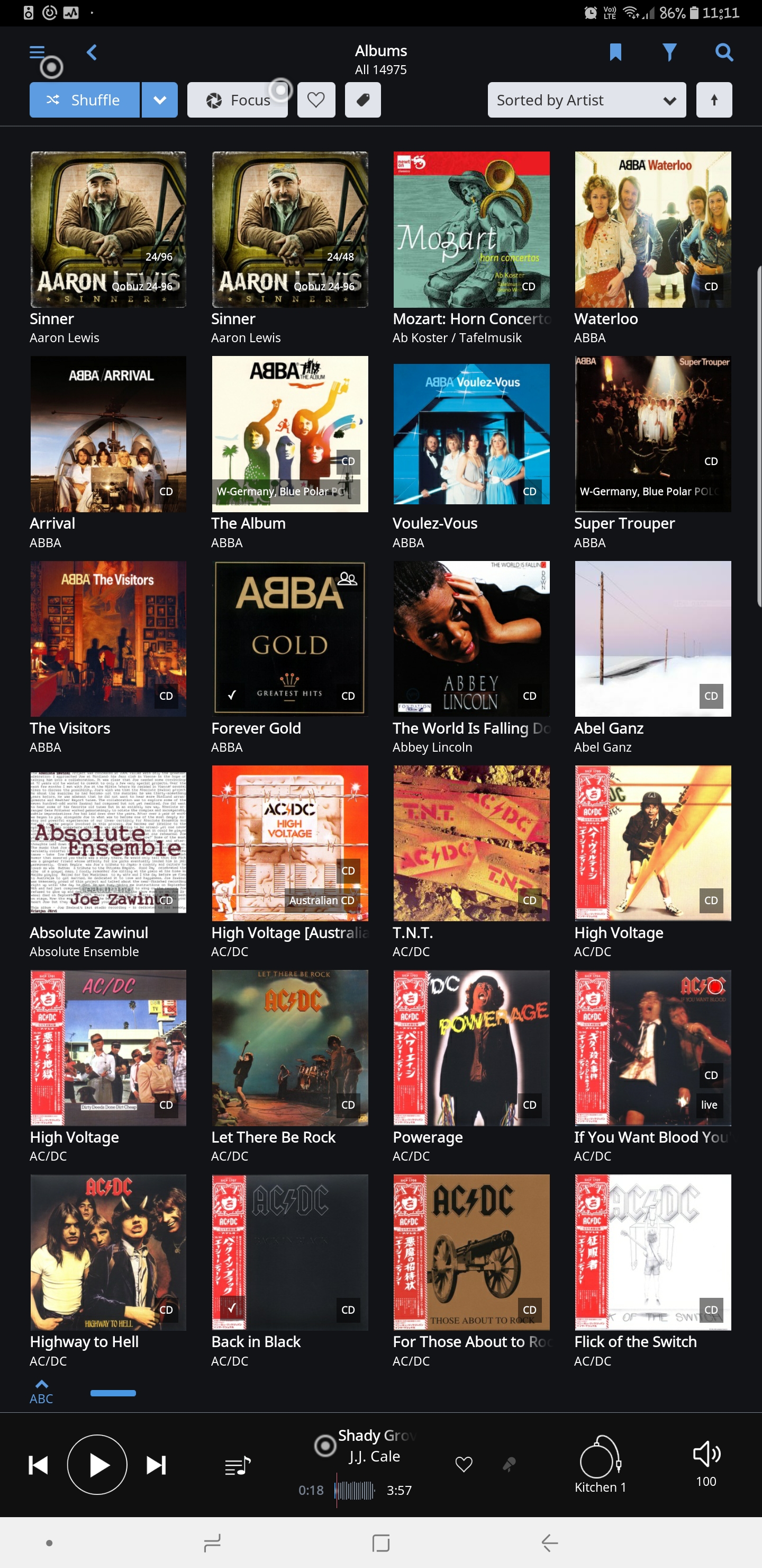

  1. There is no browsing by folder on the horizon.
  2. At the bottom of the Artists screen is a scroll bar which, when grabbed, displays the first X letters. OR use the filter feature and type the name.
  3. See answer 2, but know that Roon won’t emulate other players you may be familiar with.
  4. Not that I’m aware of. Often suggested.
  5. Use the Focus feature to quickly get at things.
Hope you stick around.

John - this feature (and Focus, I now realize) is missing on the Android (and iOS, I think) smartphone UI - which is a real pain. It’s only available on tablets, PCs and Macs (at the moment).

I agree the scrolling on a phone is abysmal. Ive changed the DPI on my android phones (which are 1440 x 2880 res) to higher than 600 to trick Roon into Tablet mode… much better!

Yes you can use Bookmarks that have been created on a PC/Mac/Tablet on an Android phone. You can also create bookmarks on an Android phone, and they will be available on a PC/Mac/Tablet as well.
Geoff, you can use the bookmarks but I can’t bookmark a position in Artists. If I go to Artists with screen set to sort by artist and then scroll down until the Bs start and bookmark it. When I click on the bookmark when I am in Artists or elsewhere it takes me to the top of the Artists list.
That’s true on the phone and on a Windows client.
