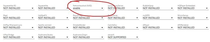

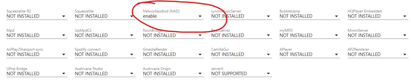

I too am running into the same issues where did you get help from Martin and Hessel?
Eddie
You need to enable the NAA endpoint in Gentoo Player
