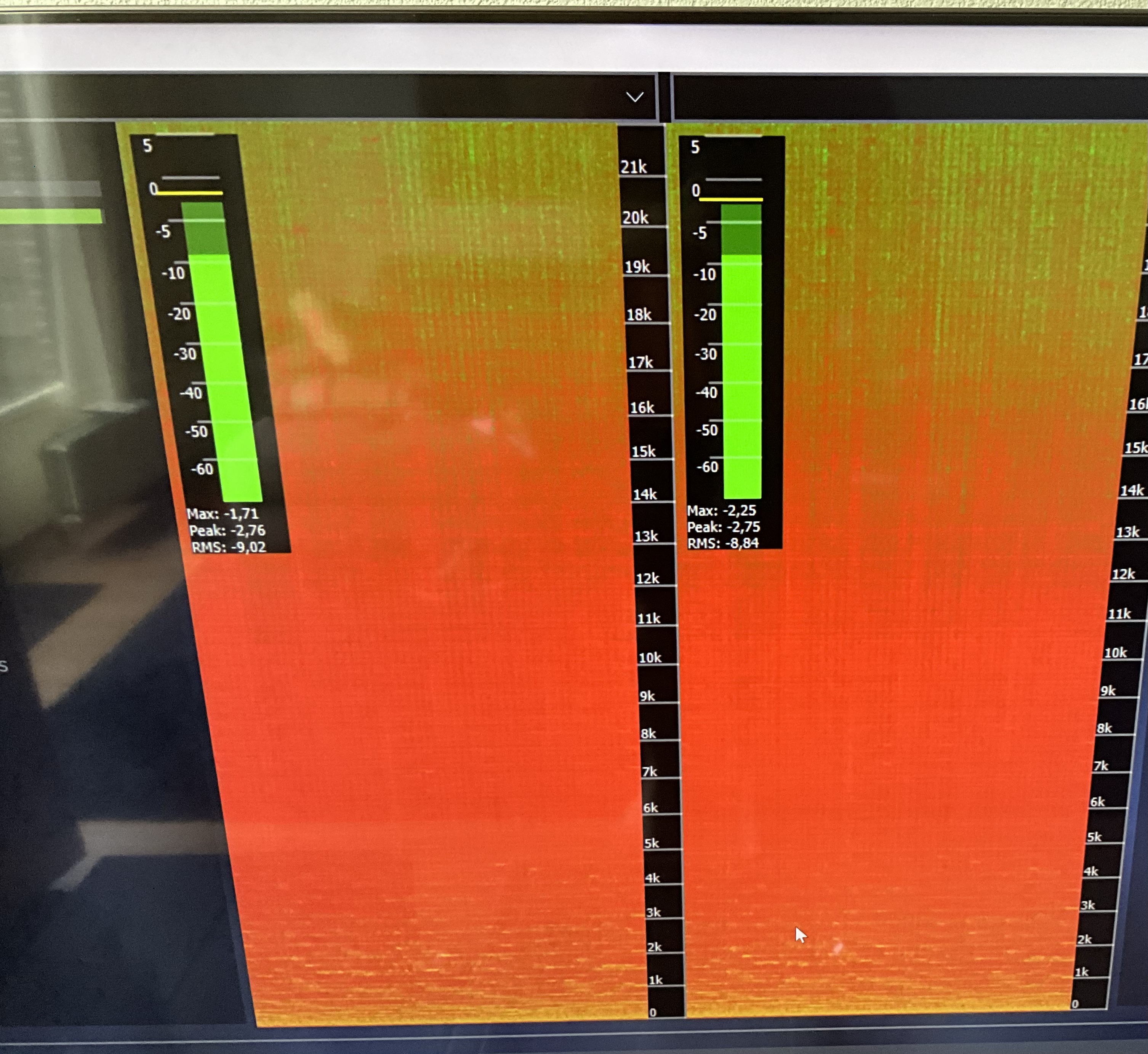

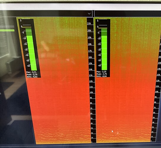

Please help. What is best settings for HQP if i listen only mainstreamp POP music. I know this music have very low DR (loudless war). Also listen band Two steps from hell but this music have very bad mastering. Is some settings which can improove it? . Another pop which listen are: Pink, Sia, Christina Aguilera, Dua Lipa… . I dont listne opera, jazz.

about. I’m sorry I understand you now. And is there anything that can be done about the bad mastering? I mean when I listen to songs that have low Dynamic range. For example, music from Two steps from hell. Yeah, it’s not pop, but it sounds really bad.
Yes, that’s bad. You can’t polish a turd, but you might be able to hide the smell. Often loudspeakers which are considered “bad” with a boomy sound might give a more enjoyable sound with this kind of mastering.
And would you have any type of which frequency in PEQ to change? Maybe which type of PEQ to start with? I think I miss the kick drums when listening to music. Like it drones too much but it doesn’t kick.

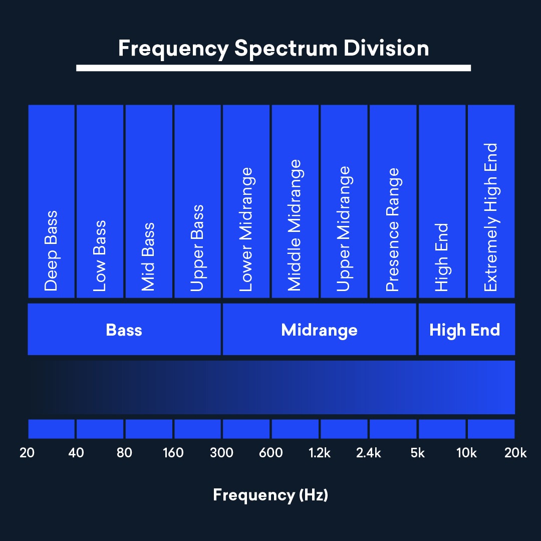

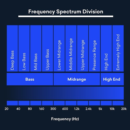

Kick is in the mid to upper bass region, see …
