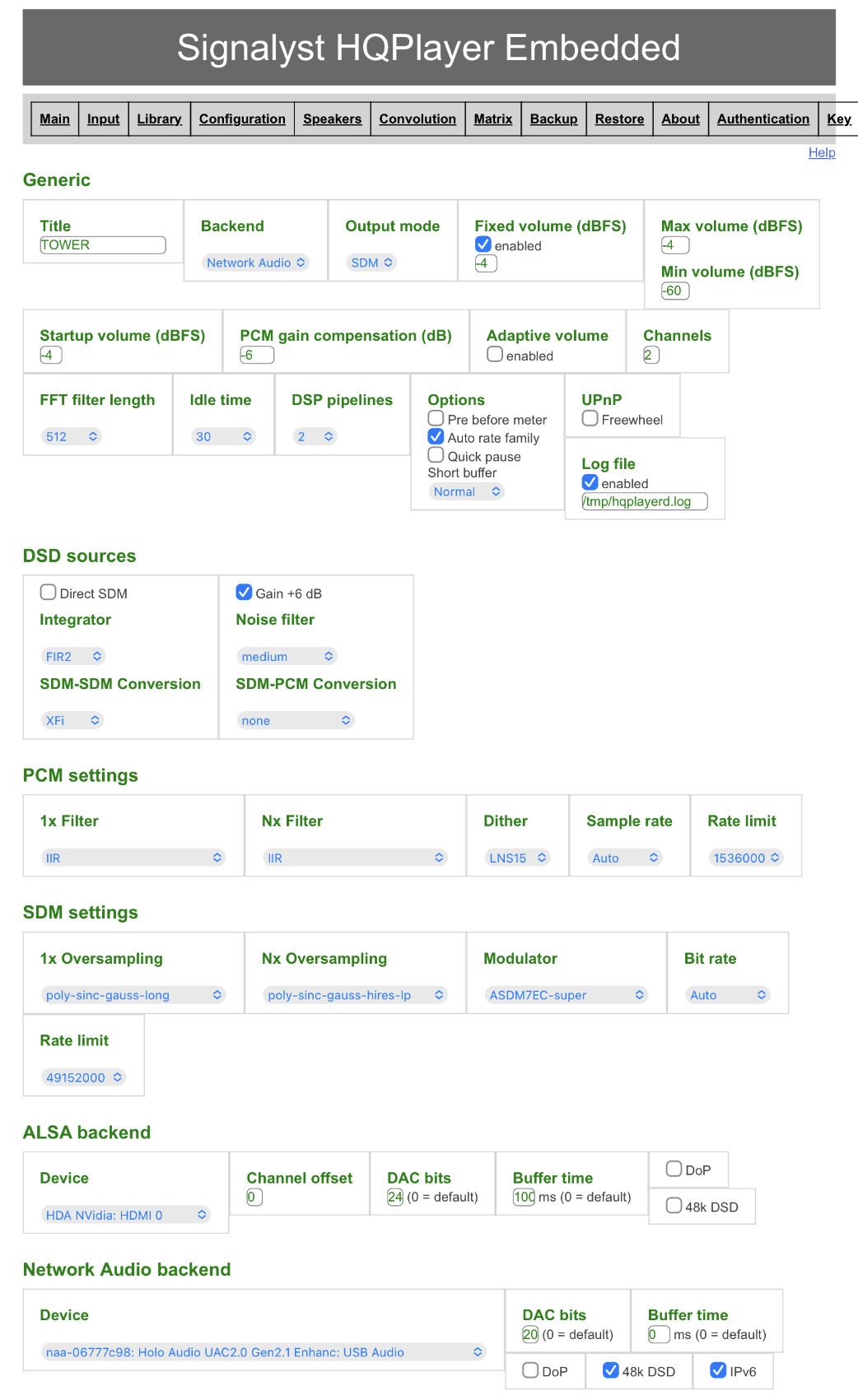

I dunno… but it sounds quite OK on my system for my ears. Reminded me a bit of Vangelis. Beside the settings on a screenshot I use very minor convolution filter against B&K curve. No need to pool bass up, really - is more a matter of taste. I have another “bassy” curve, but for this busy recording it actually makes things worst.

Can you screen your HQP settings please? I try it

I see. I changed the filter to “short-mp” it helps to accenuate the transients a little.

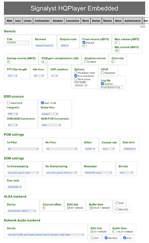

Here are the settings, I use HQP Embedded. And you will not see the convolution, but it does not matter, since the filters are custom to my room and listening position.
