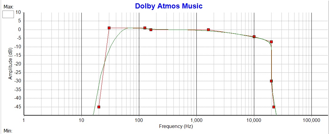

Here’s the Dolby curve I use for Atmos contents. All control points follow Dolby’s spec except bass cut-off frequency. I wish I’m rich enough to own an excellent woofer. :melting_face:
Closer look:
