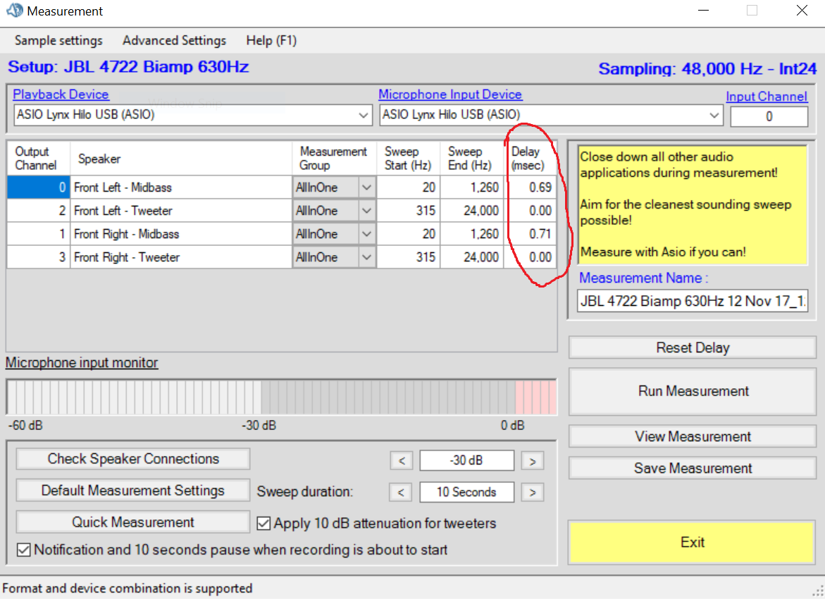

@dabassgoesboomboom I read the first link, I roughly understand, but I have one question for you. It turns out that when AL generates WAV pulses for each of the 4 channels, do they already include time delays? Or will it be necessary to add them manually to HQPE?
Highlighted in red is it necessary to set the distance to the speakers in HQPE?
Also, even if mono .wav is selected, configuration files with numbers are saved, should data be used from them?
No need to do anything - the correction filters already incorporate all time domain and frequency domain corrections
Those delays you show there are just some fast visual feedback
You will see the same time delay when you look at measurement impulse responses for each driver seperately
And the simulated impulse response corrects these delays
No need to setup time delays or distance in HQP or any convolver. The mono WAV has everything built-in.
The config files help with understanding the channel mapping in convolver.
So you don’t import those files for HQP but you need to look at them to understand how to setup pipeline matrix in HQP
Only mono WAV get imported into HQP but of course you need to send correct sound to correct driver. Thats where the config file helps. You don’t want to send bass to tweeter for example.
So have to be very careful with the first music playback, start at very low volume and listen if wrong sound is going to wrong driver.
Listen at really low volume until you are 100% sure your channel mapping is setup correctly in HQP
