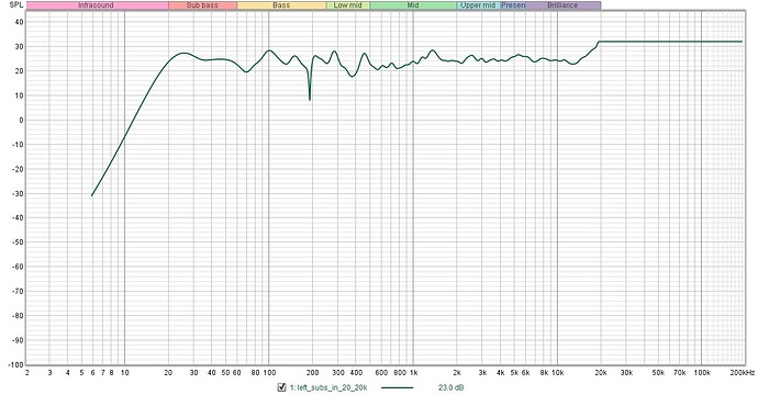

Ok so I’d have to check this outside of HQPlayer then, if plot bandwidth is limited to 20kHz ?
I run the measurement at 48kHz, so just checking correction filter (PCM353kHz) response in REW to see it doesnt drop off before 24kHz ?
You should check that the correction filter response doesn’t drop off until 176.4k, which is Nyquist frequency of 352.8k filter sampling rate.
If it drops off before, this is what the “Expand HF” in Matrix Profile is for? I forget the exact name because I’m not home
Is there any harm in leaving that enabled always ?
It only works beyond Nyquist of the filter. If the filter response drops off before Nyquist it won’t help…
Not really… In some cases it may make the filter longer, so it may increase processing load. If your filter is 352.8k, it covers 176.4k frequency range (when correctly generated) which should be enough for music content…

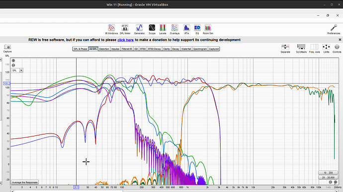

Yes, see Jason’s biamped JBL M2’s with 4 subs using Audiolense XO:
